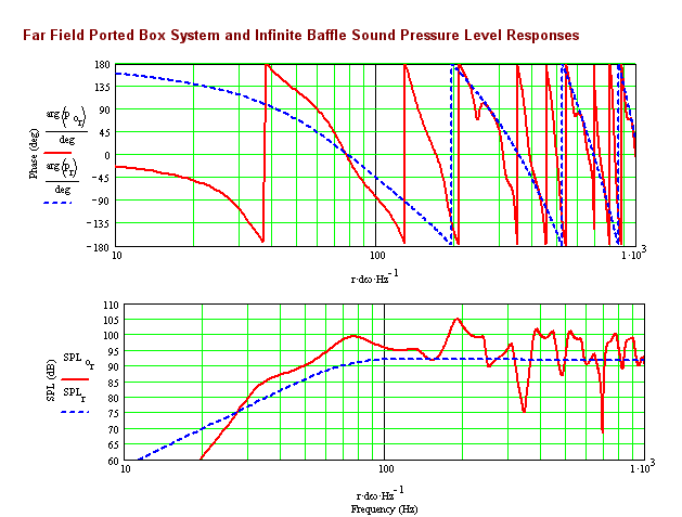

MathCad model of AcuHorn enclosure assuming these TVM drivers is below. Given that they are inverted and floor-firing, I suspect bass should be considerably boosted over what is indicated below 80Hz, and the ripple mostly flattened out.

Incidentally, (shame faced!) I confess I made a bit of a mistake with the above sim -I forgot that being inverted, the driver will move to a sub-optimal position. The result? Well, in 1/2 space, there'll be a ruddy great 30 db hole with a 10db spike in the middle between 100-200Hz. Being downward firing, I imagine that will be largely flattened out -I hope so, or music is going to sound very strange!

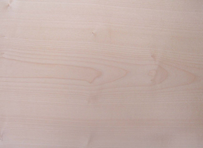

Dan -my saw has already started for the show-pair with Monacors. Out of interest, I think I'll also try for a square cross-section too, rather than the usual. Could be interesting.
I was going to just use some iron-on veneer, but I've got some of this crown-cut weathered sycamore (love that warm pink tinge) in the garage -what do you reckon? Sand it with some 300grit, then a few coats of oil I suspect will allow it to give of its best.

Good luck building the monacors... the wood choice looks lovely.
http://www.zillaspeak.com/bib.asp
Thanks Jeff, that's what I thought when I first saw it. I'm thinking a couple of coats of Tung Oil and another of lemon oil should do the trick. Any other suggestions guys?
