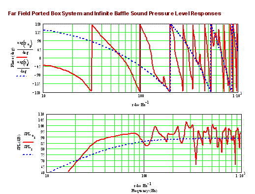

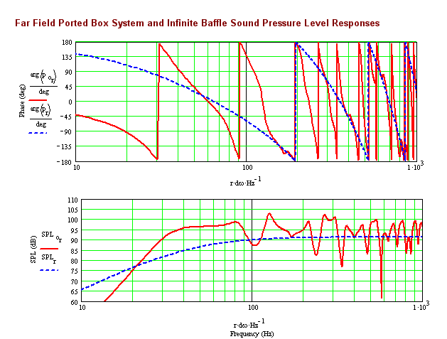

Jeff, I'll get the first batch of re-jigged dims to you later today.
In the meantime, as per requests of a week or so back (before my PC died on me and I got innundated with lectures to write), I'll post some response graphs. Logic dictates beginning with TC's original enclosure, which will give a reference point. Its basic dimensions are 138" total line length (cheers Greg). Driver 30" down from So. Sm=55in^2.
Remember that the response will be much flatter than is shown here though -this is a 1/2 space sim, not a 1/8 space, so ripple for example is massively over-estimated. Just consider it a view of the general curve. All of the simulations have a stuffing density set to 0.0001lbs ft^3 BTW, so again, the light stuffing actually employed will help damp some of the resonances not flattened by the room.

Thanks for posting those. I looked at them closely. Although I can tell that they are not identical, I can't see alot of difference. But then again, I don't really know how to correlate/compare the two.
I would love to here anyone's ideas regarding these response graphs. It seems to me that the idea of the B20 BIB is not really expected to work out well just judging by the lack of positive comments. I am leaning towards building some sealed boxes for my B20's and maybe waiting and buying different drivers for the BIB.

You're welcome.
That might also have something to do with no-one (to the best of my knowledge) having built them. I don't see any reason why they shouldn't work. I'd prefer a smaller pair (everything being relative) with higher quality drive-units, but for the price they should do fine. At a similar price, the Monacor 5" units should be a good substitute for the 1354 -they've a good reputation, and would need a smaller cab.
