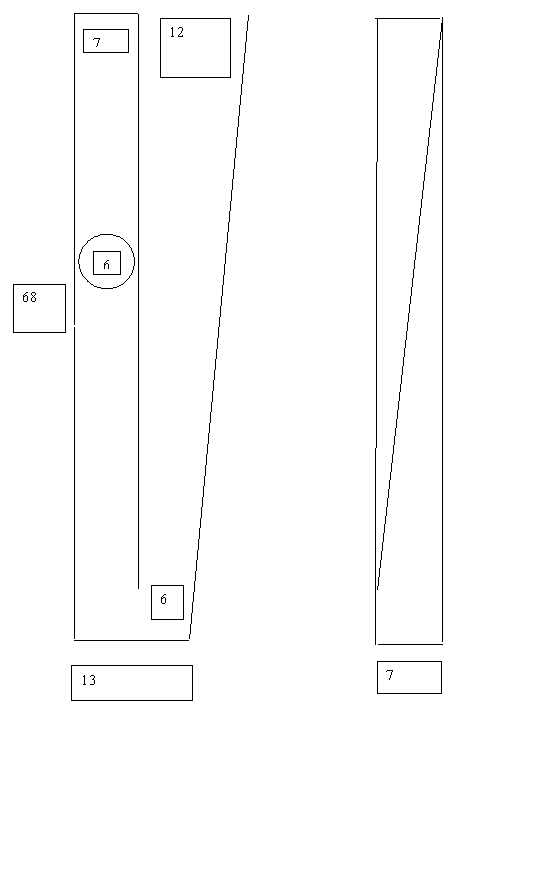

Hello All,
I would like to reach out to you all for a tad bit of help. I am helping someone design a listening room. They are dead set on having the system in wall, and I am dead set on a BIB. Luckily there is a bit more room in the wall than normal, and this may just be workable. But my question is, can the BIB be split and turned without affect the waves in a major way? Basically this means splitting the front and back, so the front would essentially be a Voight pipe venting out of the bottom side into the back half of the horn. I am attaching a very crude drawing, please disregard the numbers, they are just mental notes. Also, before it gets pointed out, the top does need to vent and I think I have that covered, but will be a future question if this idea is feasible at all.
Thanks Everyone!

Think about the sheer size of the WLs the pipe is trying to contain and it should become transparent that they don't care which way you turn them until they are small enough to be disrupted by going around tight corners, which will be high enough in frequency that you don't want them coming out of the pipe unattenuated.
Anyway, you'll be adding damping at the throat to attenuate any reflections back to it, so worst case is it will need more than some other folding scheme.

Well that answer is good, really that is what i was hoping for. But, would I need to consider any type of a V-shape in the bottom of the cabinet just to help guide the waves?

zayne742 said:Well that answer is good, really that is what i was hoping for. But, would I need to consider any type of a V-shape in the bottom of the cabinet just to help guide the waves?
No. As GM said in his answer, the wavelengths being dealt with here are long enough to be ~acoustically transparent to the path direction
