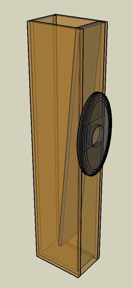

I did up a google sketchup model of the FE126/127 BIB... you might find it useful for illustrating the BIB concept on your site.
snapshot attached. model file is in the Google 3D Warehouse titled FE126/FE127 BIB -- i don't know why it keeps calling me anonymous?
Scott...

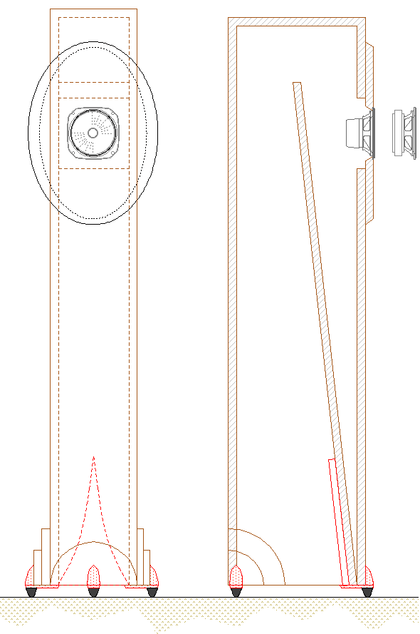

Is there a more optimum position for Zd for FE127. I think this one would be better flipped over (and i have an idea wrt the karlson coupler.
dave

Nice work guys.
Dave- I'll have a check & get back to you ASAP. With it flipped over, & not being too tall, we can move the driver into a notionally 'better' positional along the line. Sounds interesting re the K-Slot too...
See i have these cute little spiked feet to lift the base of the speaker off the floor, but i don't think enuff to provide full mouth volume. The extra required would be a k-slot on the back.
dave

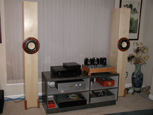

super baffle
I had the BIB upgraded with the super baffle, and certainly found the sound improve quite a lot especially good in the mid-low and low spectrum. I also found the sound more relax and airy. I just love it and will leave the baffle on forever.

Thanks for that Albert. I pick up my birch ply tomorrow morning. I have also found a source of 1.25 thick ash planks which I could use for the front. Rather than have a small dougnut shaped baffle, I was thinking that I could make the BIB, using ply for the sides and chipboard for the front and rear. I could then put a full length baffle ie another front piece (in solid ash) to hold the driver and give it more distance from the internal baffle.
Not sure if it will be worth the money though, as it sounds like you are more than happy using the dougnut shaped supra baffle and it was an improvement on your original build. Do you think the improvement came from the baffle or from the fact that the driver has now got more space behind it?
Martin:scratch:
Martin.
I thought the effect is mainly from the space behind the driver. I just follow whatever the threads recommanded. I thought too much space behind might not be good. You mentioned about the wood is 1 1/4 thick, my baffle is only 3/4" thickness.
Albert
