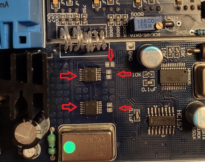

Hi, I recently bought a Teradak 2.7D NOS and it has clicks and pops problems on both channels. I removed all TDA1543 and tested them individually one by one but the click is always there. The problem happens with all the interfaces, USB, Toslink and SPDIF. I suspect that it can depend from Jitter also if I cannot explain how I can have it when I'm connected to USB as Tenor7022 and WM8055 are using same 12Mhz 1ppm oscillator.

I've identified the problem, it wasn't cause by TDA1543 nor from solderings. One of the two 74VHC74 was defective. The problem cannot be detected by Oscilloscope but as I studied how the flip flops were working I've identified also the two pads to bypass them, not before to have removed the thw vhc from the circuit. Now My Teradak is working very well and I'm not sure that I will repolace the two VHC74 because the sound seems very clear also without them and their noisy defect.

As specified before on the circuit there are three pads to bypass the two VHC74 (they must removed before to bypass them), this bypass will apply the clock directly from WM8805 (through HC157) to the TDA1543.
This bypass is quite similar to the one present on Chameleon to bypass upsampler board, you should know that I've also a Chameleon and I've removed this upsampling board because I prefer to have a pure NOS machine, it is a question of tastes and I know that not all love the sound of NOS dac.
Maybe that VHC could improve the sound but I can't notice important differences regarding jitter nor noise, so for the moment i will keep it without clock regeneration circuit exactly as I keep the Chameleon without the upsampling board.
On the other hand, if you look at the original project by kusonoki san, no reclocking circuit was foreseen.
Downloaded image and converted it to jpg. Attached below 🙂
