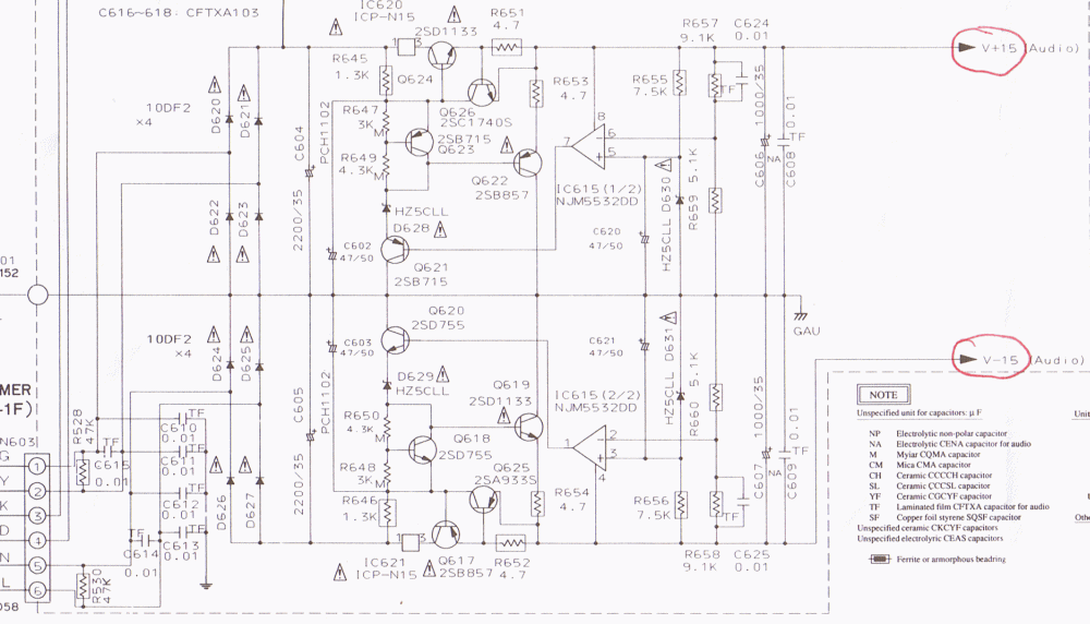

Hi Guido! I am intrested in your clock oscilator , but I don´t understand the the metod of connection , and what I need for upgrade.
So I am asking , do i need only XO2/3 canned module as component , or is there some other components , if I have high quality 5V outpur from cd-player power supply?
Do I only connect XO3 instead of old crystal?

I have never (!) found a clean 5V in any CD player so roll your own or buy XO2 or XO3 otherwise upgrading a clock is spoiled by noisy power supply

I have nice PS that runs in A class , orginally made only for colck circuit.
Player is Rotel RCD990.

Interesting. Never found non "class A" power supplies by the way.
What is the measured noise at the output ? (please in nV per SqrrtHz or in uV+measurement bandwidth otherwise)

I have an rcd990 as well. I was looking into it, but did not do anything serious yet. But one thing I can say right now: Clock power supply is so-so, but the reclocking is dubious. All these supplies are infested by the vicinity [and very bad decoupling] of the PMD100! [the grounds, for example]
Otherways, though it uses the usual hc04 inverter, I agree with You that the clock construction is not the worse possible.
What I did so far was to decouple the PMD100 with smd 10uF ceramic caps directly on the pins, which is fortunately possible [hm, the designer had made a good job, only to be completely neglected by rotel..], this decreased seriously the EMI/RFI activity around there.
If you compare it to the RCD 991, one area where they visibly corrected an error is properly this...

Joseph K said:Gasho,
Ciao, George
