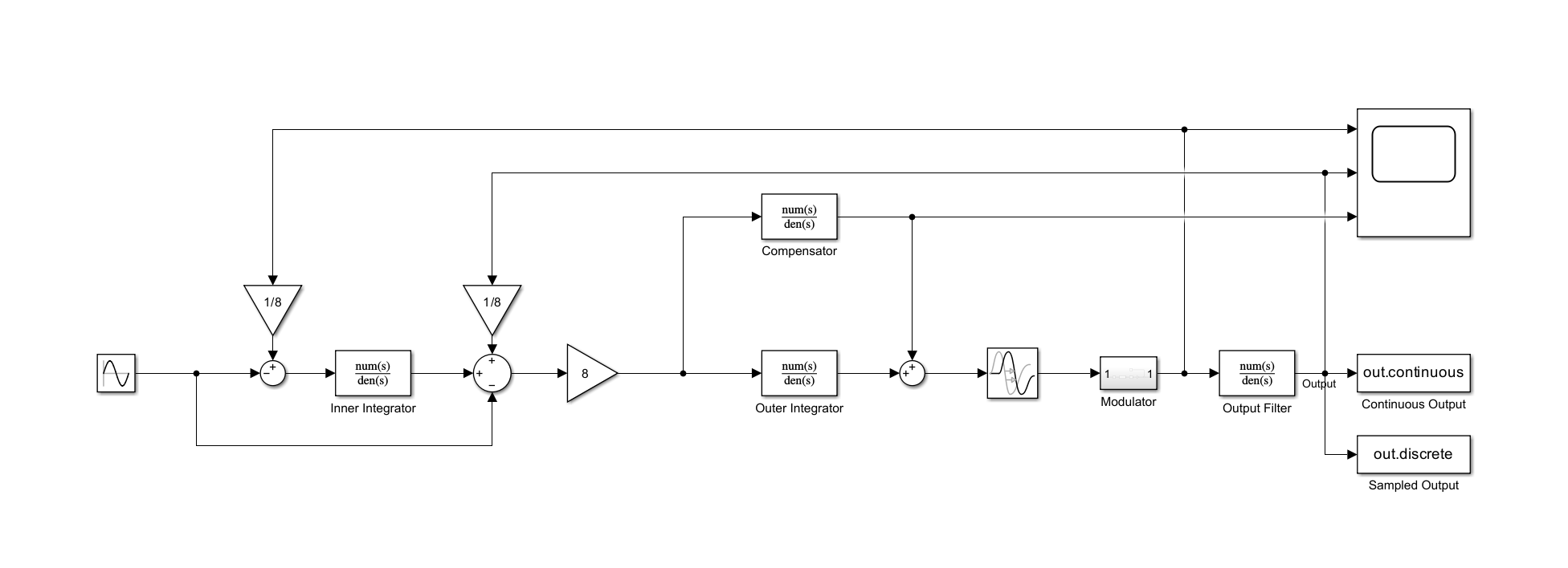

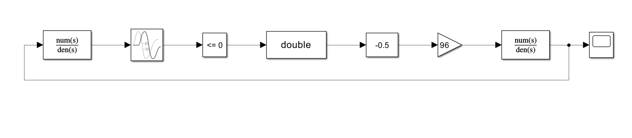

I've dabbled in Matlab (I have it for free because I'm a student) but my experience in control theory is limited. However, simulating it in Matlab as shown below actually reached the same oscillation results as predicted, both for UcD and a custom feedback network.
I think I'll try to optimize pole-zero placement using Matlab and my Python script before using SapWin and constraint satisfaction to find component values. I'd like to get a little closer to 70dB of loop gain. I'm also hesitant to physically prototype because of price and my lack of experience with PCB design.
One more question about feedback loop design: why don't people make the power stage non-inverting so we have more phase margin to work with and can use higher order integrators?

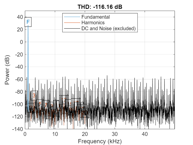

As an update, I reached -116 THD in simulation (Matlab) with the following FBN architecture. The FBN has almost 80dB of gain, though it's mixed feedback (not purely from the output filter). Going to figure out component values and prototype now so I can test output impedance and THD+N. If anyone wants the transfer functions of the stages, they're saved (rather messily) in the notebook. The entire project can be found on GitHub.
Be careful, in simulations like these, the plant is LTI (linear time invariant) and is just what we describe it as, and if we forget / fail to describe it correctly, the results wouldn't be anywhere close to real life. For example, the pole-zero locations could change with load characteristics etc. Any simulation is only as good as the models it uses.
