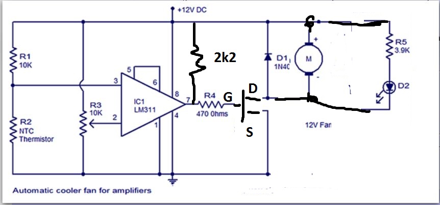

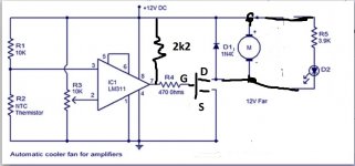

This shows how it should all work with a FET. The thermistor at the left has been set to provide a varying input voltage to the comparator (imagine its heating and cooling). This is the green trace. The other input to the comparator is fixed at one half the supply voltage by the two 10k resistors which are simulating the preset. So by setting the two resistors to the same value there is 6 volts on this input.
Whenever the thermistor voltage 'crosses' the 6 volt threshold the fan turns on. You can see the fan current as the blue trace 9scale at the right). The FET conducts cleanly:
If we alter the preset to give 4.5 volts as a 'reference' then we get this:
And altering it the other way:

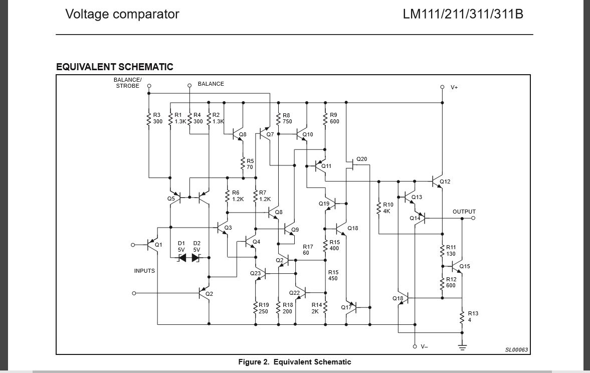

And don't forget that pull-up resistor if using an LM311 🙂

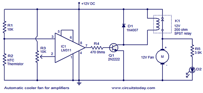

I put (this 2 transistor proportional control circuit) into LTSPICE just to see if it worked. After a little tweaking, the answer seems to be: yes.
I used a low cost 10 Kohm thermistor from (this Vishay series) which is in stock at both Mouser and DigiKey.
Simulation results below. When the air (and hence the thermistor) is hot, more voltage is applied across the fan terminals and it spins faster. When the air is cool, less voltage is applied across the fan terminals and it spins slower. The article discusses how to modify the slope of the curve, via R5.
Turkey worky.
