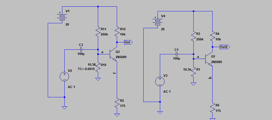

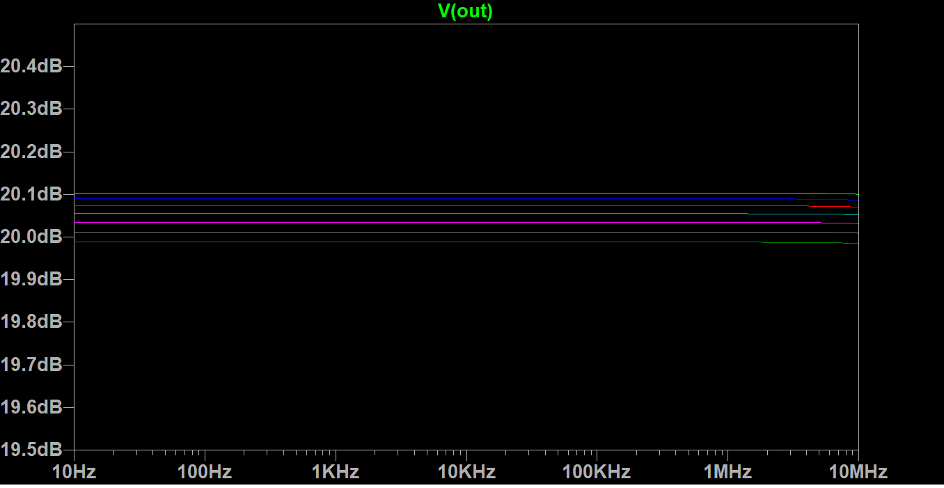

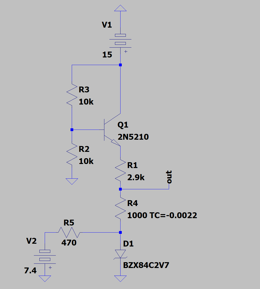

Just opening this for guidance from gurus.

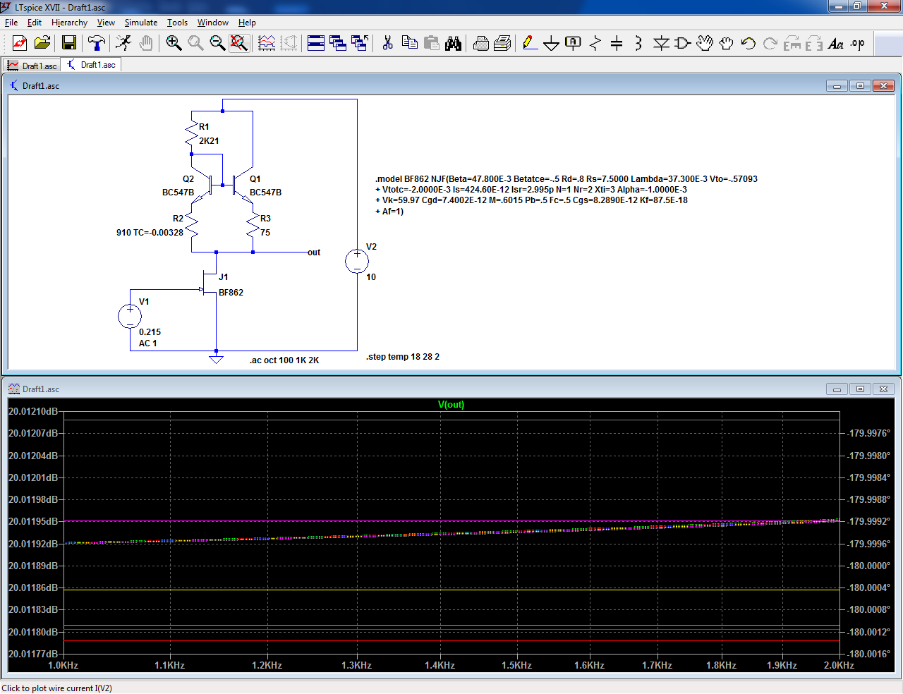

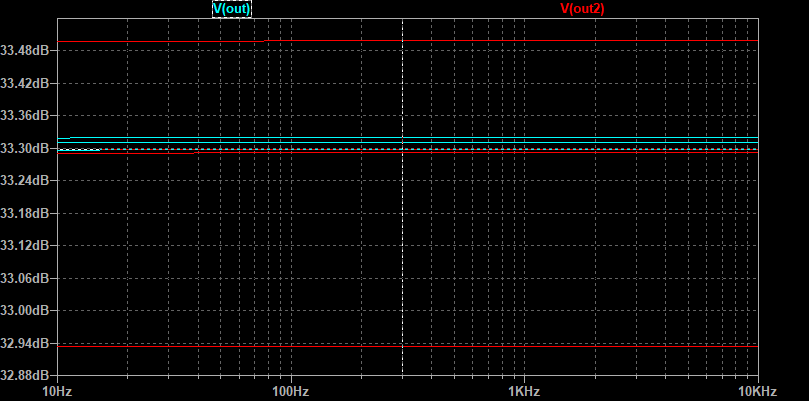

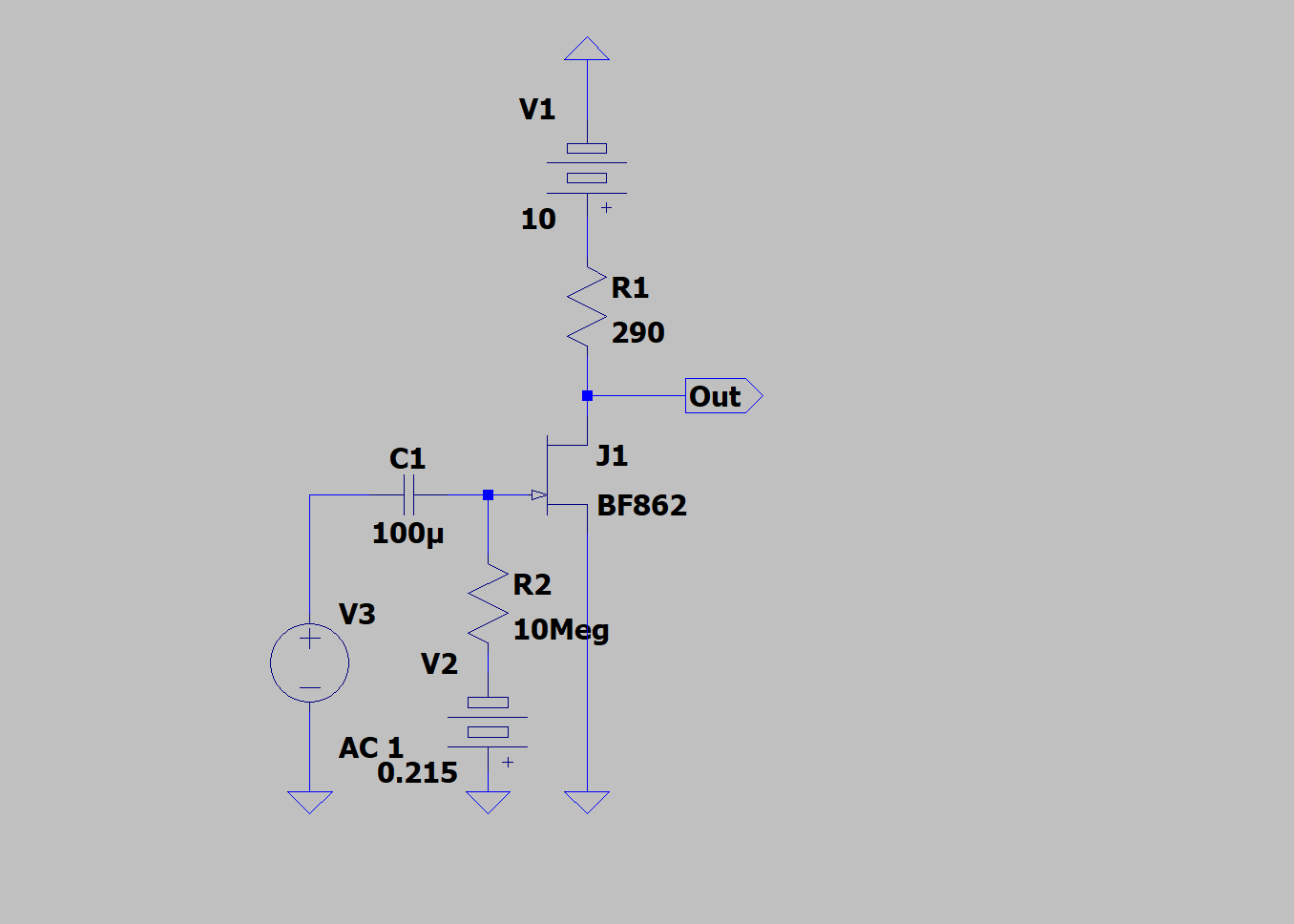

Simple singe-ended JFET amplifier, and gain as a function of temperature (15 to 45C in 5 degree steps) By replacing R1 with a positive tempco resistor (1400ppm) pretty good temperature stability is attained, but positive tempco resistors are a bit difficult to get (I have a couple dozen left over from a log amp project decades ago, but only one value.)
I am opening up for suggestions which would involve NTC resistors. I have some ideas...

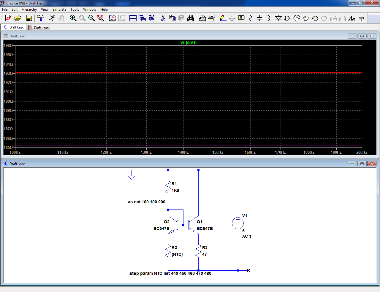

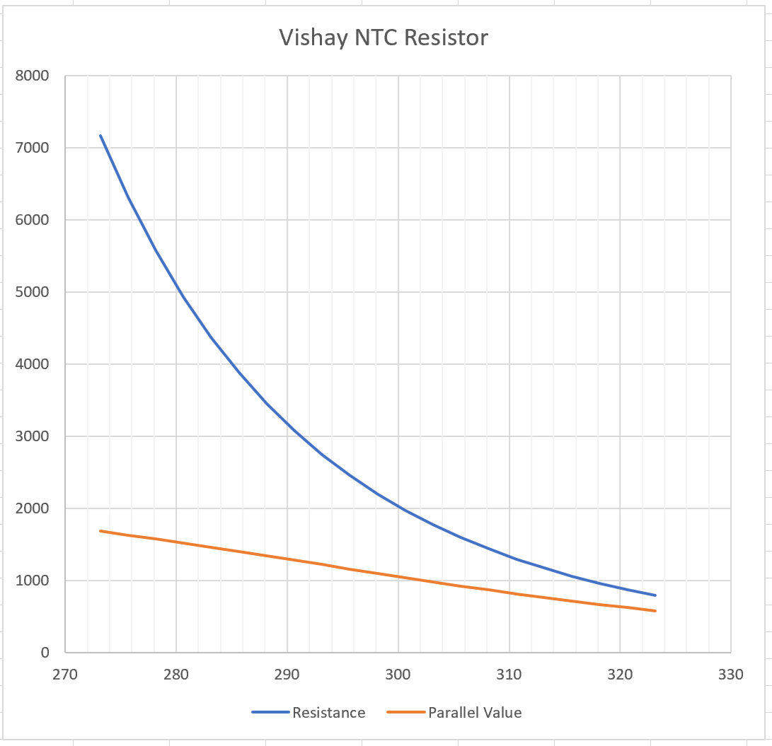

Here's an idea -- I haven't bread-boarded yet but have a bunch of Vishay type 3977 NTC thermistors on the way. By putting a resistor of equal value in parallel with the thermistor a fairly linear gradient is obtained. A 2.2k thermistor in parallel with a 2.2k resistor:

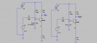

Digging through the Vishay Application notes -- this could go a bit further down the food chain. The first employs a 330K NTC resistor with B of 3930 in parallel with 10.6K for a gradient of -0.0015, the second a 10.3K fixed value.
