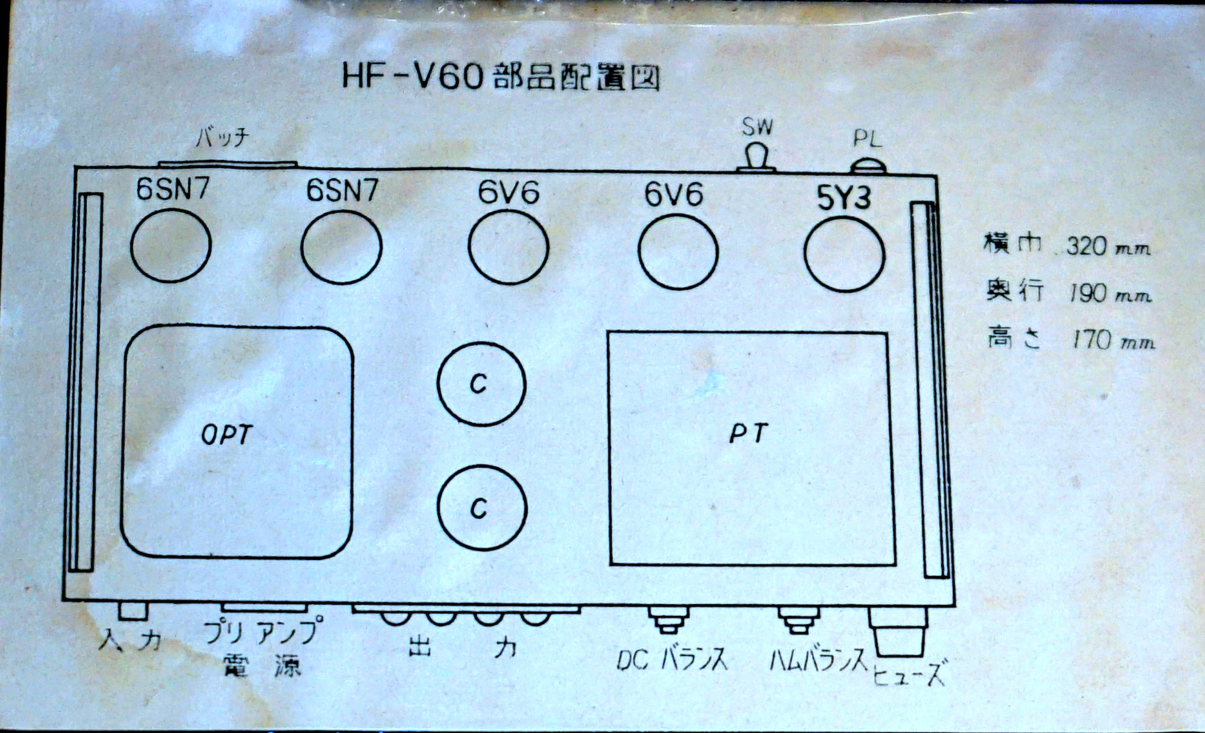

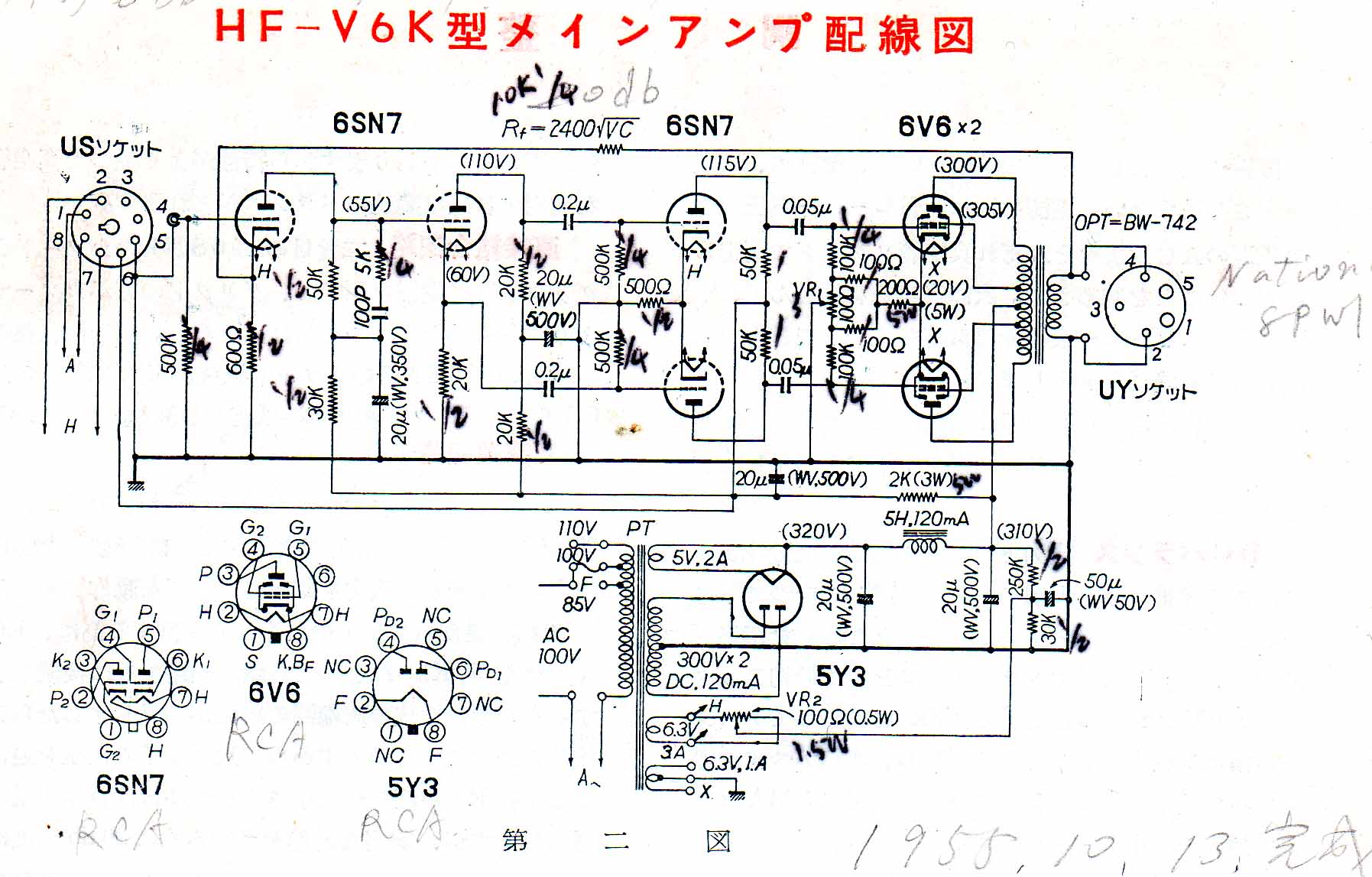

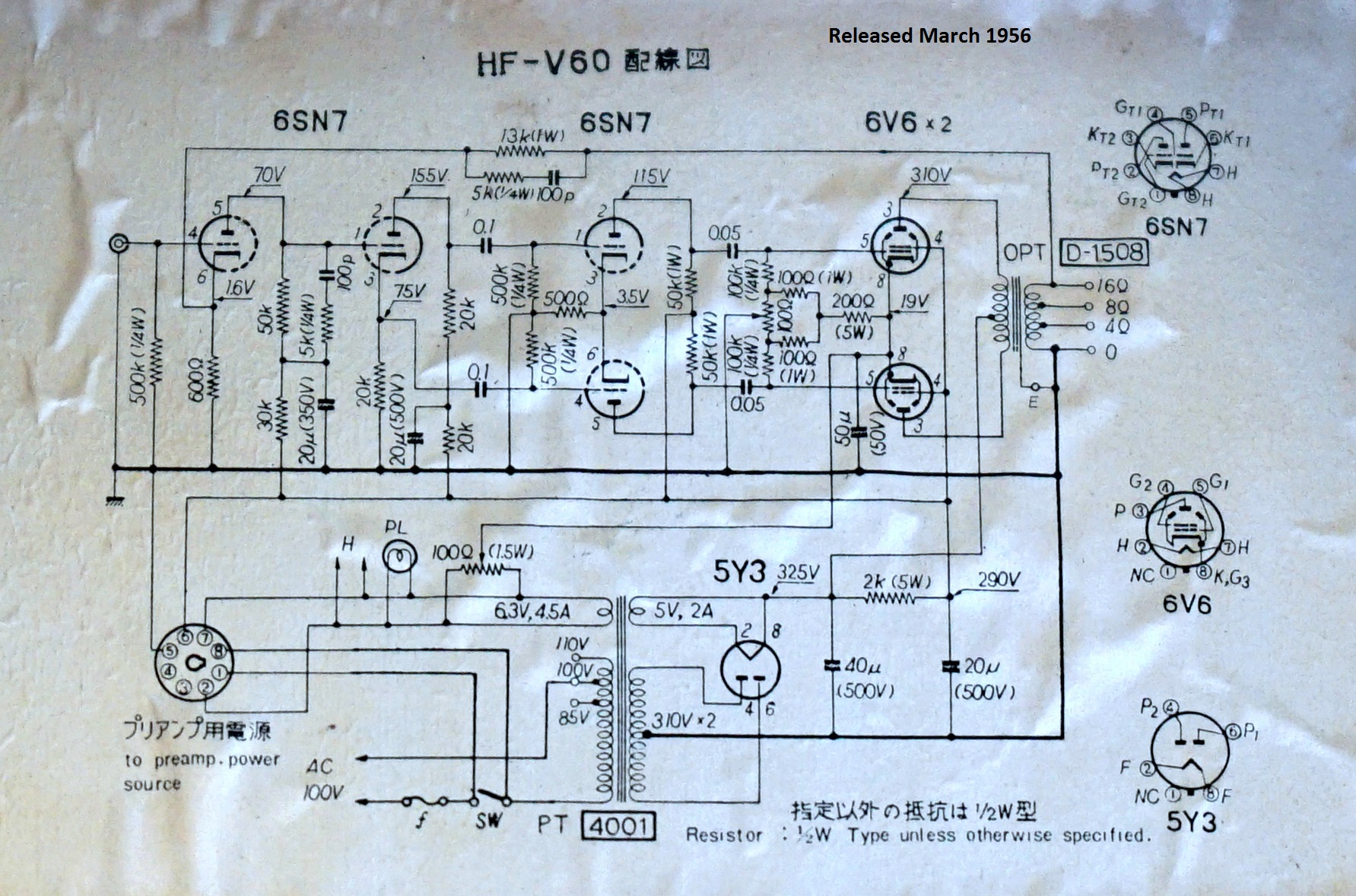

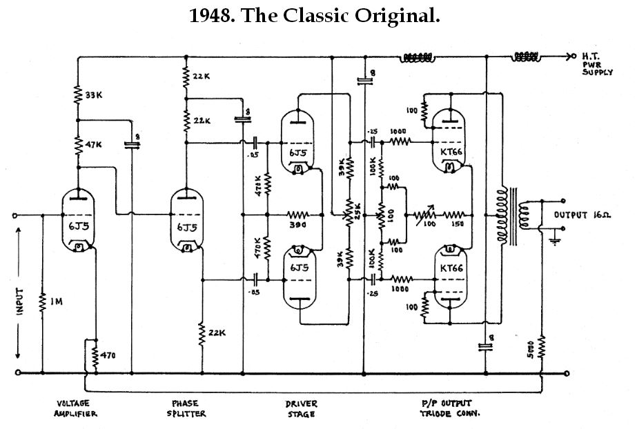

2X 6SN7s makes considerable sense. That fits right in with Williamson style circuitry. I've uploaded the original schematic. 2X of the same triode found in a 6J5 are inside a 6SN7. 😉 So, 2 bottles, instead of 4, take care of the power section's small signal circuitry. The 2 bottles don't have to be "matched", but good section to section balance in the bottle used for the differential amp is in order.
While Williamson triode wired his O/P tubes, scads of Williamson style amps have been built using full pentode and ultra-linear mode "finals".
What has me scratching my head is the non-linear 6SG7. That fits in with a conversion to guitar amp, AKA distortion machine. Perhaps Pioneer used the 6SJ7, in a HIFI configuration. Except for the internal g3 to cathode connection in the 6SG7, the 2 types appear to pin out the same.
While it would be neither inexpensive nor simple, I do see a possible path to a stereo setup. Hashimoto may very well offer the O/P transformer used, currently. Williamson style circuitry is discussed, in abundance, in the DIY Audio archives.

Thank you very much Eli. I understand the dim bulb testing now to check cap and transformer. I also am reading the safety thread pertaining to high voltages.
If I could turn to stereo I'd definitely want that. Im more than willing to take on the challenge.

The 5 Kohm and 470 Ω resistors constitute the global negative feedback (GNFB) pair. 8.6% of the amp's O/P voltage is being fed back.
When NFB is applied to a cathode, as is the case here, that signal has be in phase with the I/P signal. OTOH, if NFB is to be applied to a grid, it has to be out of phase with the I/P. O/P transformer wiring can be manipulated to get whatever phasing is necessary.

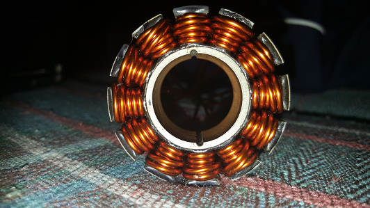

I rewind brushless dc motors for a hobby. I was programming in basic on a vic 20 in the 4th grade. I like to be fully versed on something I haven't ever done before just jumping in. These terms like "o" getter I have never seen before.

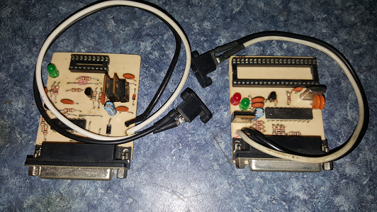

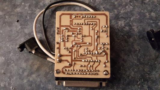

Pic programmers built by me no kits boards and all etched by me.
Currently Im prototyping a single phase sector brushless dc motor with parallel slots and measuring core loss in proprietary powder core material blended by myself using a simple Helmholtz coil.

I asked about The PCB construction and got no answers. But I own a PCB mill so I could probably fashion something real nice If I wanted to. But I have to be fully acclimated to the Jargon before anyone can really talk to me. The chassis and metal work all not an issue for me. I can hold my own here once I understand all the terminology used.

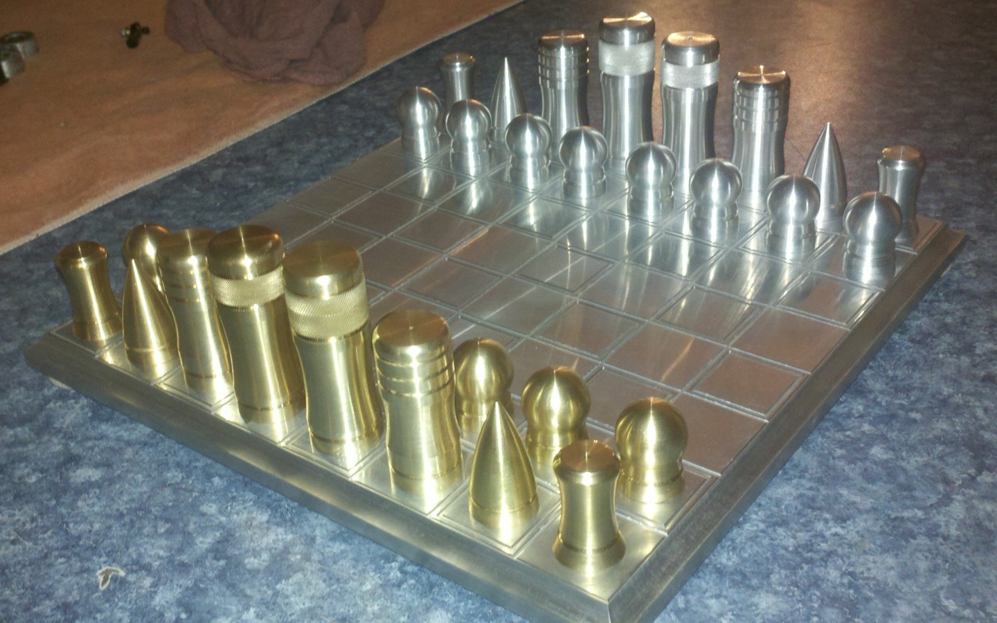

For fun check out this chess set I machined Eli. It was done on a haas mini mill and SL-10 slant bed lathe. I think I received a 98 on this coz he claimed he felt a burr 🙄. The king and queen crowns were done on a Leblonde manual lathe and a knurl tool.
It sold on ebay in days 400.00 smacks. I could make a fortune if I personally owned those 40,000 dollar machines.....

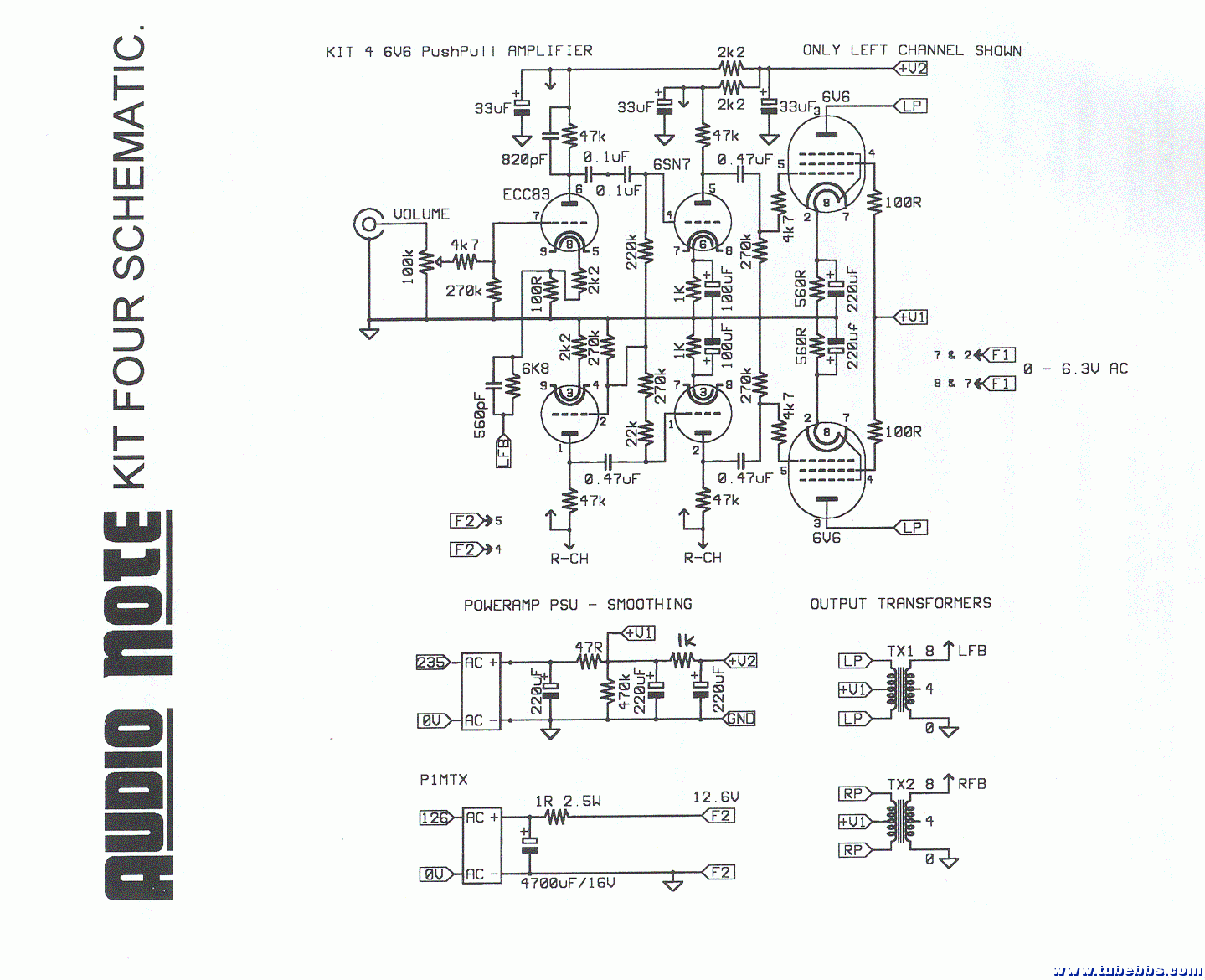

Some schematics attached. Audio Note Kit 4 copied the final stage - check the unusual cathode resistor values. The Audio Note P2-PP is similar, early ones came out with 12AX7, 6SN7 and 6L6 and is 2x20W /side. The AN kit 4 is 2x10 watt. The Sanui UL looks to be 8 watts accroding to the notes made on the schematic.
Am at the moment building the AN kit 4 with Hashimoto OPT's, mains transformer is a Hammond and large enough to drive 6L6's should I want to change from 6V6's.

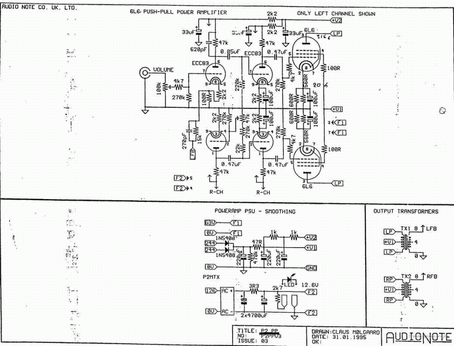

I think attached schematic is for one of the Audio Note P1-PP iterations, not sure. Interesting to see that the 47K trimpot in the floating paraphase inverter has been re-introduced.
What is the purpose of C2/C3 in series? (It also seems a little odd that their values are so different than the other coupling cap)
A 47K plate load on a 12AX7...great...
-probably mistake
-not great, uh a big distortion and minimal gain.
-i´d put in middle 12ax7 fet gyrators instead-gain >80x with hard lowZ drive to endstage
Don't know, suspect it has something to do with balancing the response curve.
MAZDA 12AX7 / ECC83 specs attached. 47K is one of the recommended configurations.

"Recommended" is probably not quite the right word. 12V out at 5% THD is dog poop. The unbypassed cathode resistors everywhere aren't going to help matters.
A 12AT7 or 6922 would do everything better with the available voltage other than acting as a distortion generator.
