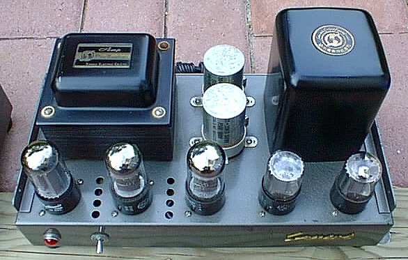

IIRC, Sansui equates to Hashimoto, not Tango.
I bow to your superior memory, Eli. You are correct.
Either way, that is a nice OPT.

It looks similar to Sansui HF-L60 or HF-V60.
I would agree. Seems to be a very similar topology between the pioneer and this Sansui. HF-v60

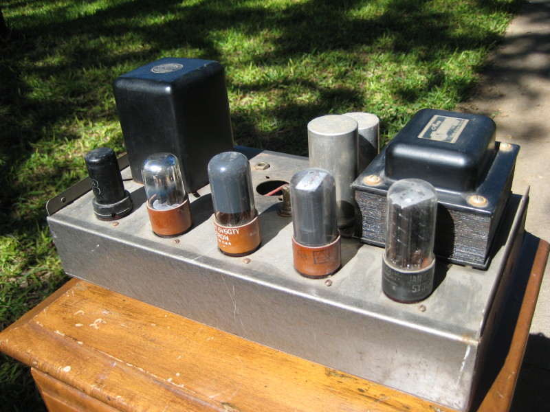

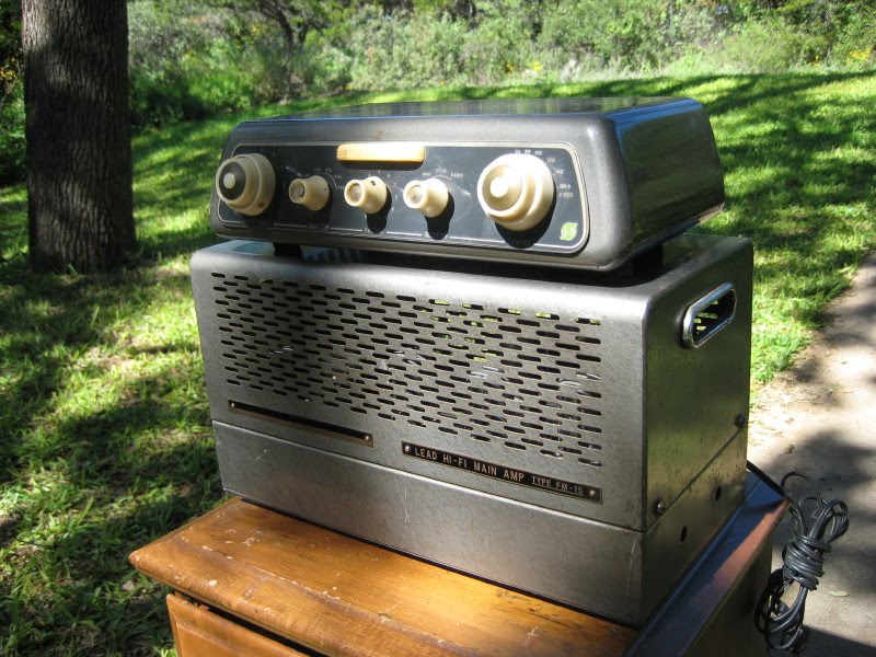

It may already be set up as a guitar amp. The end jacks are clearly added. The octal socket to the OT would have gone to some distribution assembly - perhaps in a juke box. The two end jacks are wired to it, so they are intended for speakers. The other end jack would be an input. The unused octal socket would have been used for some sort of control interface and/or preamp, but no longer needed after whatever conversion was done.
it doesn't look like something a hifi guy would do, but it sure looks like what a zillion guitar amp converters would do.

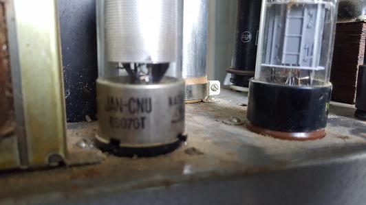

A closer look at one of the pics shows a 6SQ7GT
A pioneer pic I posted or on one of the other units shared? Just wondering as I like to get it operational if possible. I have plenty of electrical experience but I have never touched one of these things. My field of study would leave me to believe it could be laid out much cleaner on the inside. Are modern ones laid out the same way or do the have PCB? How do you keep track of such spaghetti?
build a "dim bulb tester", find a suitable sacrifical speaker for a load,put one hand in pocket and turn the power on....What would be the steps to get it going again.
sorry if that seemed vague but at this point resolving whether or not it "works as is" would be better then wondering what to do with it, no?

Im not intimidated I just dont want to go in blind and create more damage. Yes much more caution needs to be observed off a wall socket for sure. The members made a mention of the 5V4 needing to be swapped out for a 5U4 . The admiral tube also seems to have a crack in its plastic base.The 6SQ7GT post has me lost as I dont see anything denoted that on the pioneer. Those are my questions so far. Since I dont have 2 for stereo operation Id likely repair it or just keep it as an antique conversation piece that just happens to work. As an antique it may be worthy of a collectors coin. Maybe not but it should make a unique piece to look at when in operation. Maybe I could just drive a single Tannoy driver with it. I have one 6.5 on hand from my sound quality car audio days .

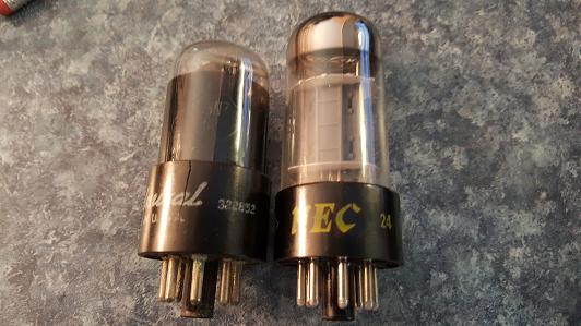

These 2 both read 6SN7- GT on the bottles. So are they just different brands NEC, Admiral anybody? If they are pairs should they match in specs or in other respects? A lot of variations and jargon that's foreign to me when I'm looking at specs to buy them. The transformers look like bricks but do last a long time?
See the crack in the Admiral bottles base....
The photo was blurry, but this is a 6SG7GT not "Q" if that what you were speaking of. I asked but no one answered.

All of the numbers I posted with the photos are correct. All of them them are what I actually have here. No alphabets or numbers have been incorrectly stated. I don't know anything about tube amps but I'm not illiterate fellas. I know all my alphabets.... LOL!
