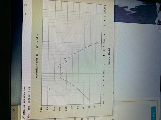

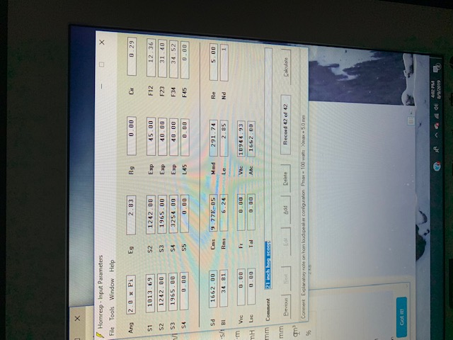

Ok guys ya'll been a big help so I finally came up with some information what do you guys think. I will be building 21 inch hog scoop with 18sound 21LW1400 driver.

the speaker described in your input screen has a "short" 1.25 meter path. With the speed of sound ~343M/s its quarter wave is 343/(1.25*4) ~69Hz.
Below is the input for an 18" driver hog scoop and its path is roughly twice of your input
Can you post a drawing or link to a drawing of the cabinet you want to examine with hornresp ?
scaled 1.17:1, I get about a 2.8->2.85M path for a 21" version - roughly a 30Hz 1/4 wave.
one the model is established, 21LW1400 can be plugged into hornresp along with the scaled cabinet's width - then one can use a "wizard" (!) to examine the effects upon response from narrowing the whole cabinet - it may look better in some instances

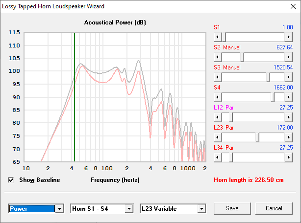

Hi Brian and GM - I was looking at scaling the posted hog scoop schematic by 1.17:1 for OP's 21LW1400 but goofed and entered things "ND-wise"
might you re-arrange this expansion for proper TH sim ?
that lossy LE sag looks right - (this is a 4.5" coil ?)
  • goofedhog21.txt
