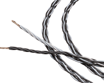

One of those cables (DNM Reson II) sounded harsh, thin, with tizzy white-noise treble. Bass was muddled and uncontrolled, mids were unpleasant/painful/fatiguing.
The other (4PR, 4VS) sounds more natural, with solid, deep bass, sweet, realistic treble, and less offensive midrange. Bigger soundstage and more natural detailing too.
If anyone is suffering with thin, spaced cable, give something like these or phone cable a try!!!
-Simon (expecting flames...)
edit: system is solid state amp, normal dynamic speakers, and similar interconnect. Also, to be fair the Reson sounded good on cheaper equipment... (ie. when I bought it several yrs ago!)

how are they braided?
Might not have pointed out, they are Kimber cables, sorry. Perhaps you thought they were DIY ones... There are 8 conductors: 4+/4-. Each 'conductor' is a bundle of cores, in 'VS', they are varying diameters. Not sure exactly how one would do a braid like that at home! 4PR and 4VS both sound nice, each use polyethylene (spelling?) insulation. This factor may also have a bearing on the SQ, being less harsh etc (the Reson cable uses teflon). Mr. Feedback will have something to say about it perhaps.
