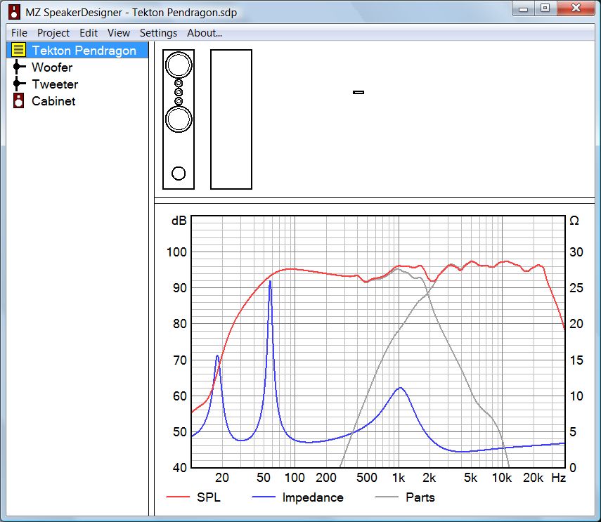

The impedance plot of the Tekton Pendragon published by Stereo Mojo allows to do some reverse engineering and even to conclude on the crossover.
The woofers certainly are not Delta-10A, it's a driver with much lower Fs. Hints on the net (Legend series, 4 and 8 ohm version) led me to the conclusion that it's more likely the Eminence Legend BP 102.
A simulation of the reverse engineered speaker shows a crossover at 2 kHz.

great info thanks! Does that by chance have the port tuned to around 20hz or so in line with stereo moho's review findings?
