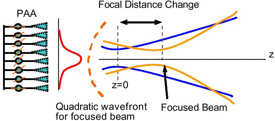

Quadratic phase array discussed here [...] To me it looks like the behaviour of a curved array (CBT), only difference being how phase deviation is born (distance or electrical) Easy with a radar or antenna working in a narrow passband...
I'm curious if you have any "solid" evidence about what sort of array algorithm(s) they might be using. The Quadratic Phase Array is presumably better than the Bessel approach for line arrays with many elements (the asymptotic efficiency is higher, as described in the 2000 JASA paper by Aarts). However, there is no indication from the product literature, or from the patent text linked to by others, that a sophisticated array algorithm is being employed by Tekton. The patent text is actually too painful for me to read carefully, but a cursory glance gives no hint of a non-trivial array algorithm. Of course, that doesn't mean they are not using one. Also note that Tekton is using 2D arrays, which makes a (careful) analysis even more difficult.
both, i suspect. first one then the otherNeither, I suspect. It's just marketing reality. A patent is a useful tool to help sell product, simple as.

There is a theorem in math that says that there always exists a polynomial of order (n-1) that will exactly pass through n points in a plane.The Quadratic Phase Array is presumably better than the Bessel approach for line arrays with many elements
If you have, say, three drivers, there will be no difference between the Bessel function (Jo, zeroth order Bessel function of the first kind) and a plain old quadratic; a quadratic is already a polynomial of order (n-1), where n=3, and the higher-order coefficients that differentiate the Bessel function from a simple quadratic will all be zero.
In a nutshell, with 3 drivers, there will be no difference at all between a quadratic and Jo(x) Bessel fit.
As you say, if you have "many" drivers, there may be some slight difference between Jo(x), and a plain quadratic (x*x).
But I suspect that, for a practical number of drivers, this is going to be more a case of gilding the lily than a revolutionary improvement. I would be very surprised if there turn out to be significant benefits.
-Gnobuddy
I am not sure there is such a theorem about polynomials intersecting planes. What you may be referring to is the Lagrange polynomial, which is the polynomial of least degree passing through the n points (x_i,y_i) with i=1,n. Indeed, this polynomial is unique and has order n-1.
If you have, say, three drivers, there will be no difference between the Bessel function (Jo, zeroth order Bessel function of the first kind) and a plain old quadratic; a quadratic is already a polynomial of order (n-1), where n=3, and the higher-order coefficients that differentiate the Bessel function from a simple quadratic will all be zero. In a nutshell, with 3 drivers, there will be no difference at all between a quadratic and Jo(x) Bessel fit.
I don't understand your point. In particular, I don't know what you mean by "fit", or how this relates to Bessel arrays, which are not fits to J0(x) by any meaning of the word "fit". A Bessel array uses properties of the generating function for Jn (not just J0) to obtain a phase factor with (nearly) constant amplitude. For a 5-element Bessel array, these amplitudes are Jn(1.5) where n=-2,-1,0,1,2. The choice of 1.5 is, in essence, arbitrary but is chosen to get as close as possible to integer amplitude ratios. The argument 1.5 is a fixed quantity and does not refer to the location of the array elements.
This is not the difference Bessel and Quad. Phase arrays (QPA). A QPA modifies the generating function to give better efficiency at the cost of a slightly worse (irregular) polar pattern.As you say, if you have "many" drivers, there may be some slight difference between Jo(x), and a plain quadratic (x*x).
