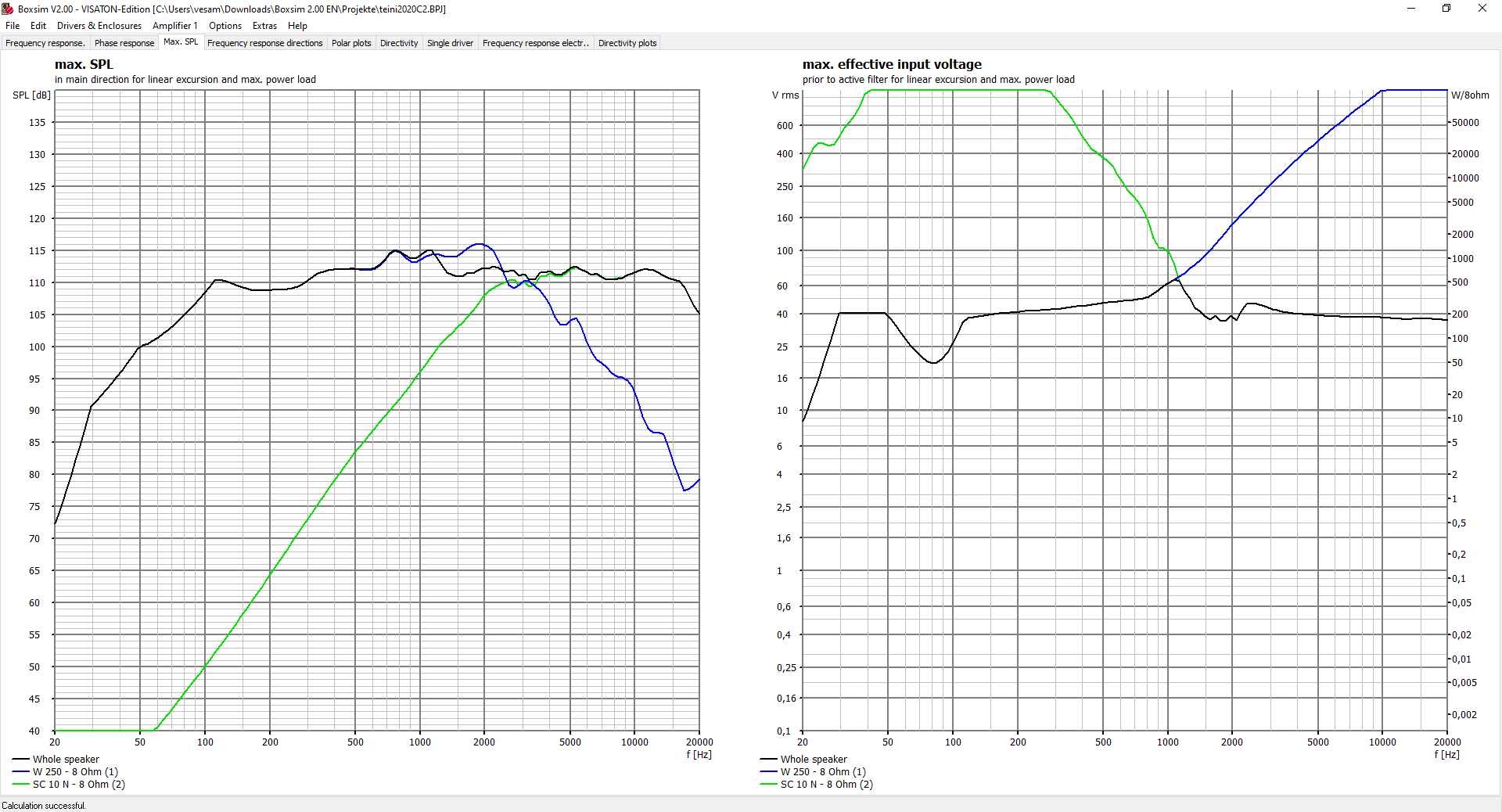

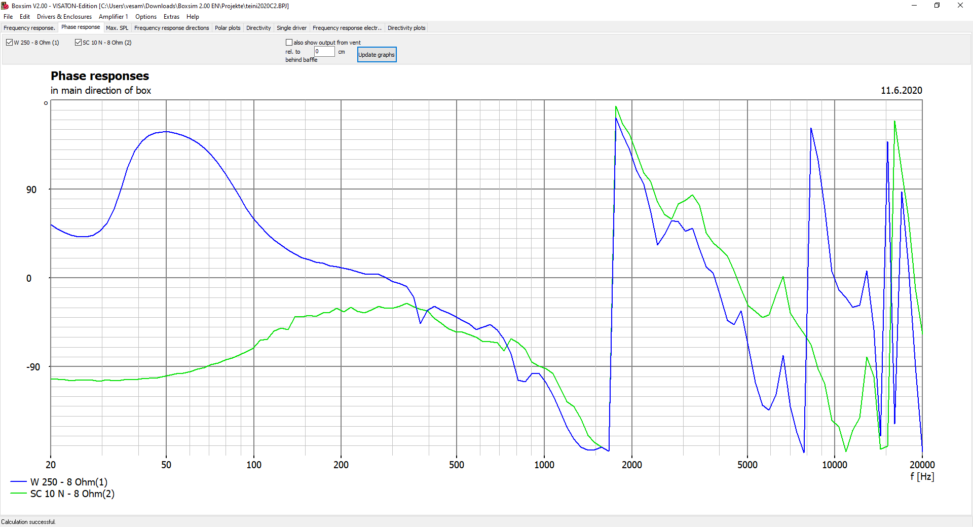

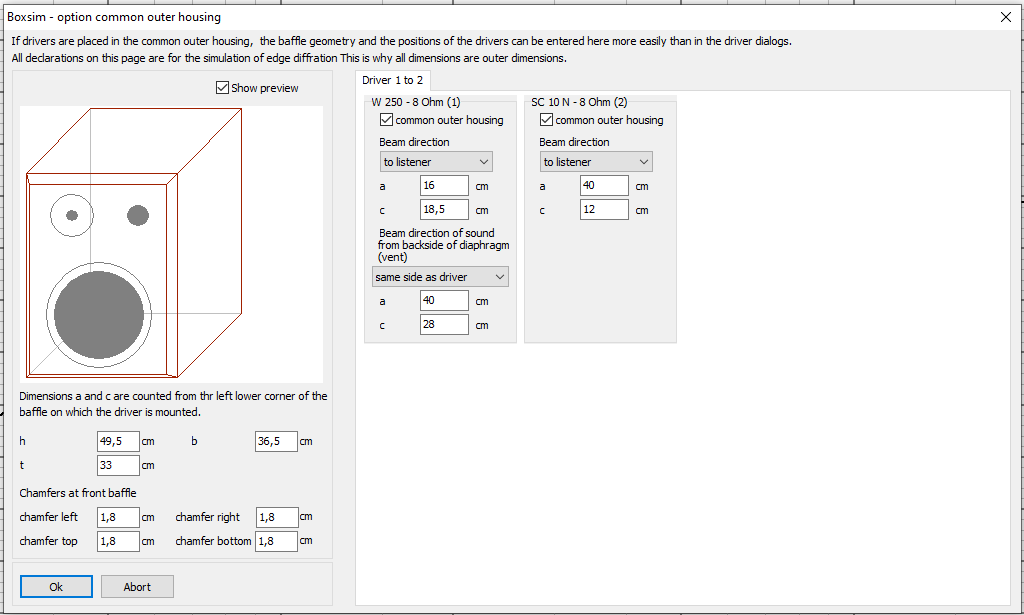

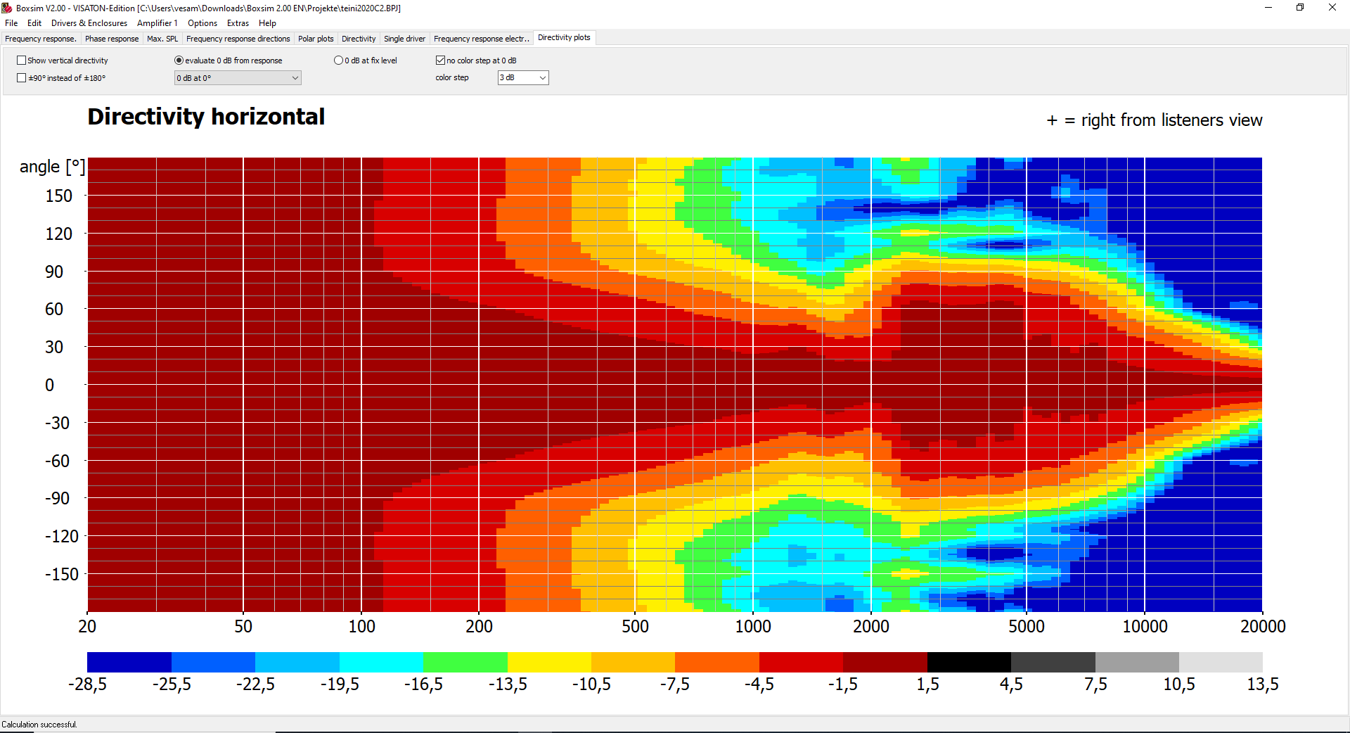

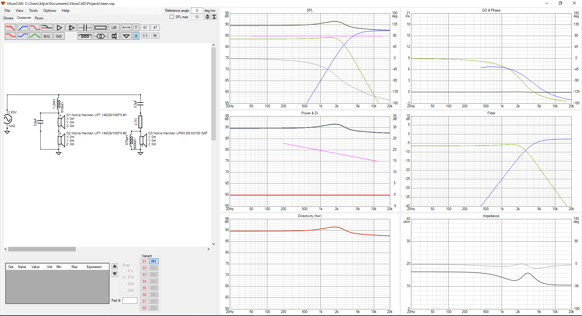

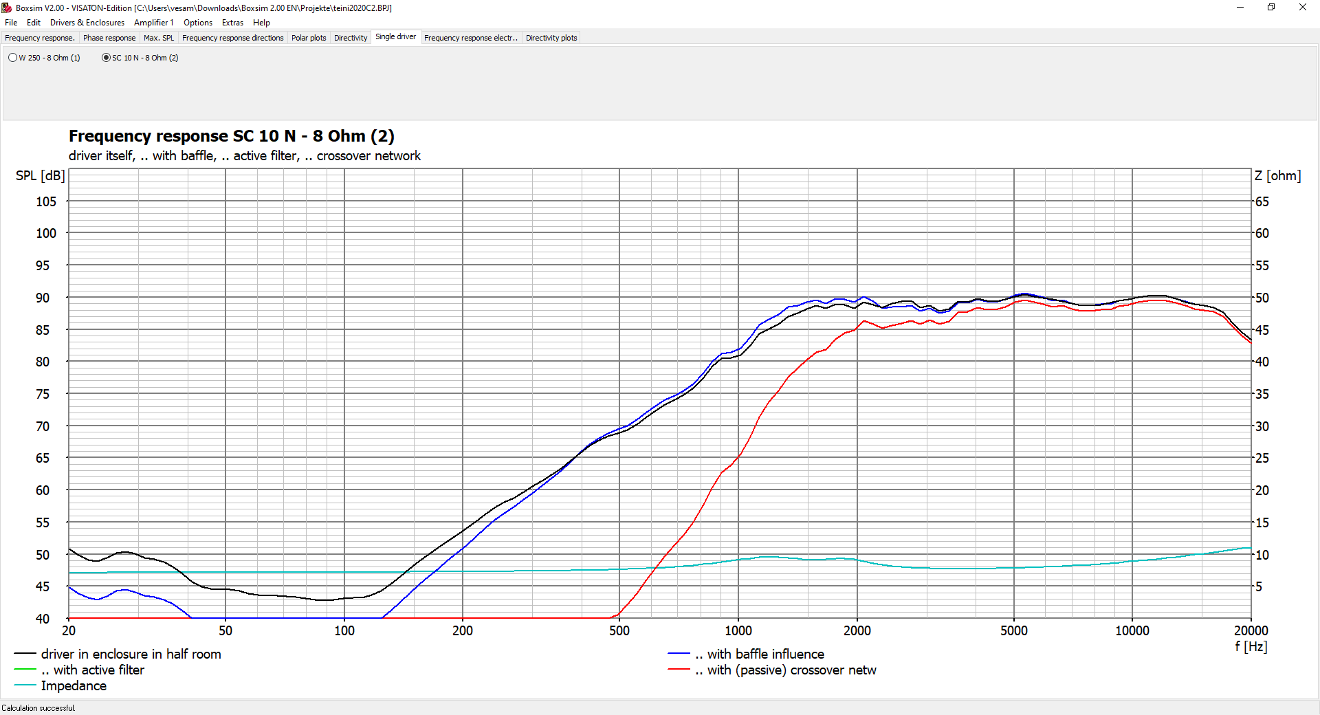

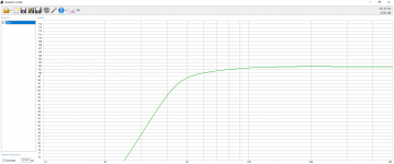

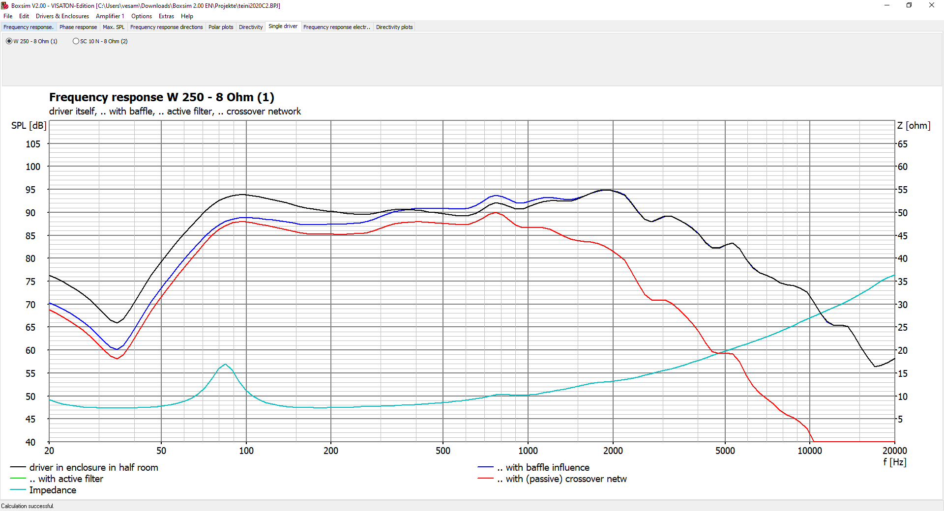

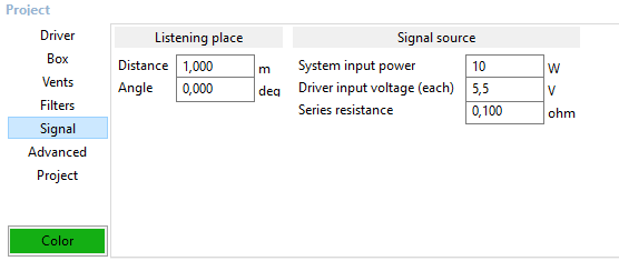

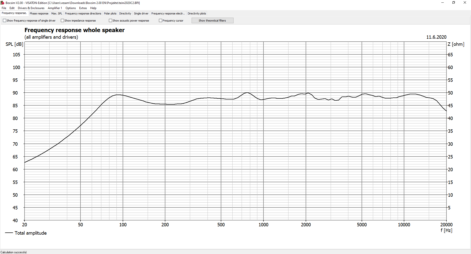

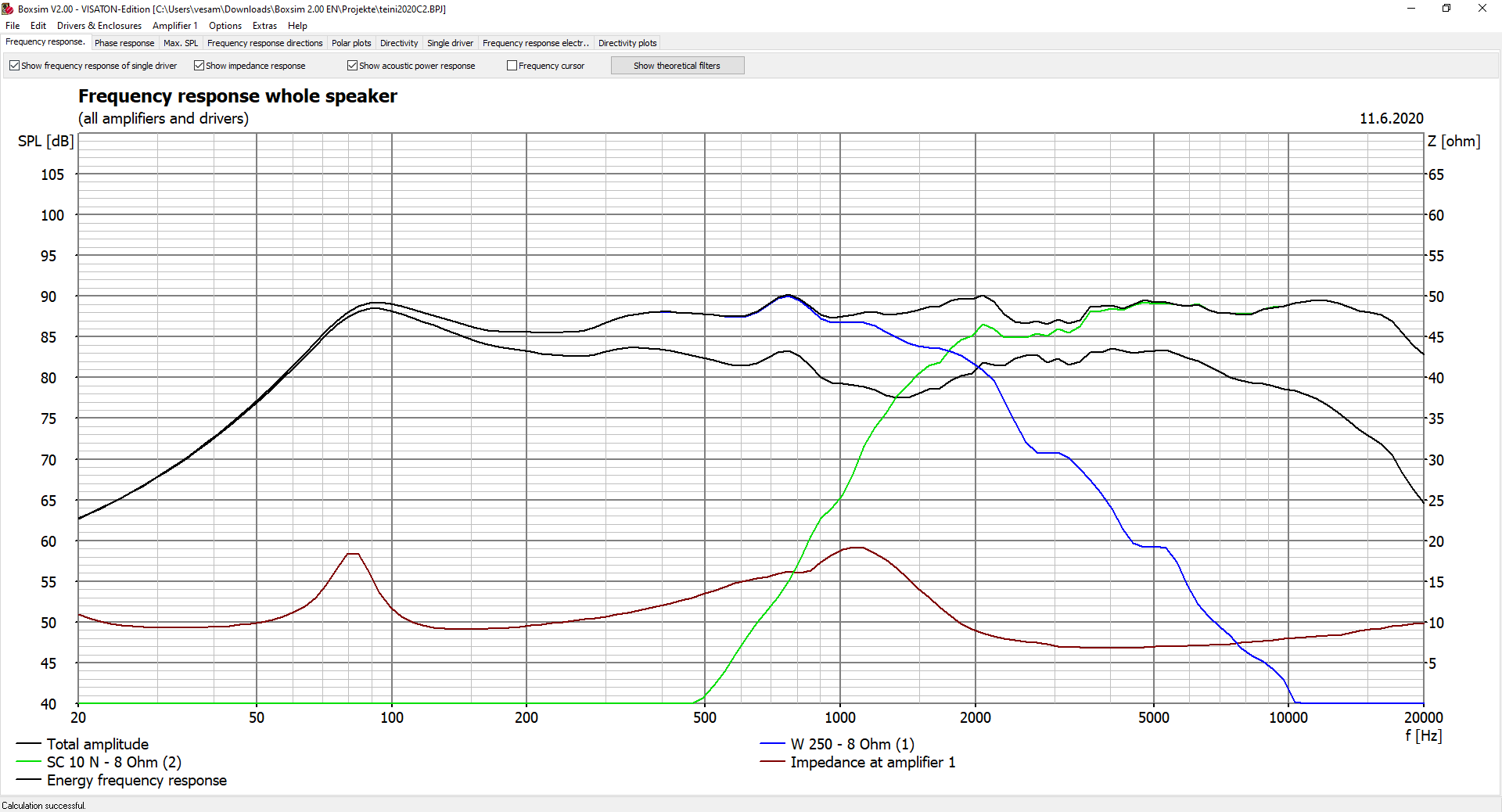

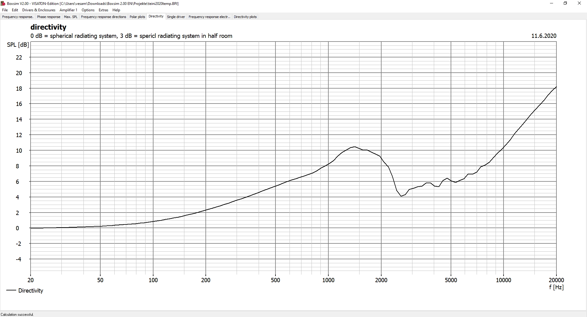

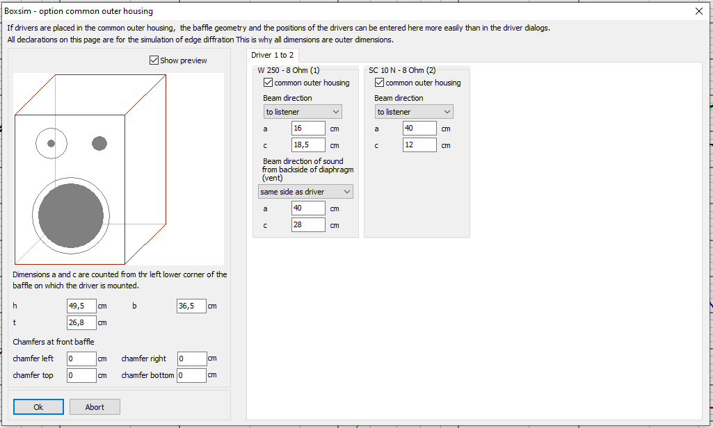

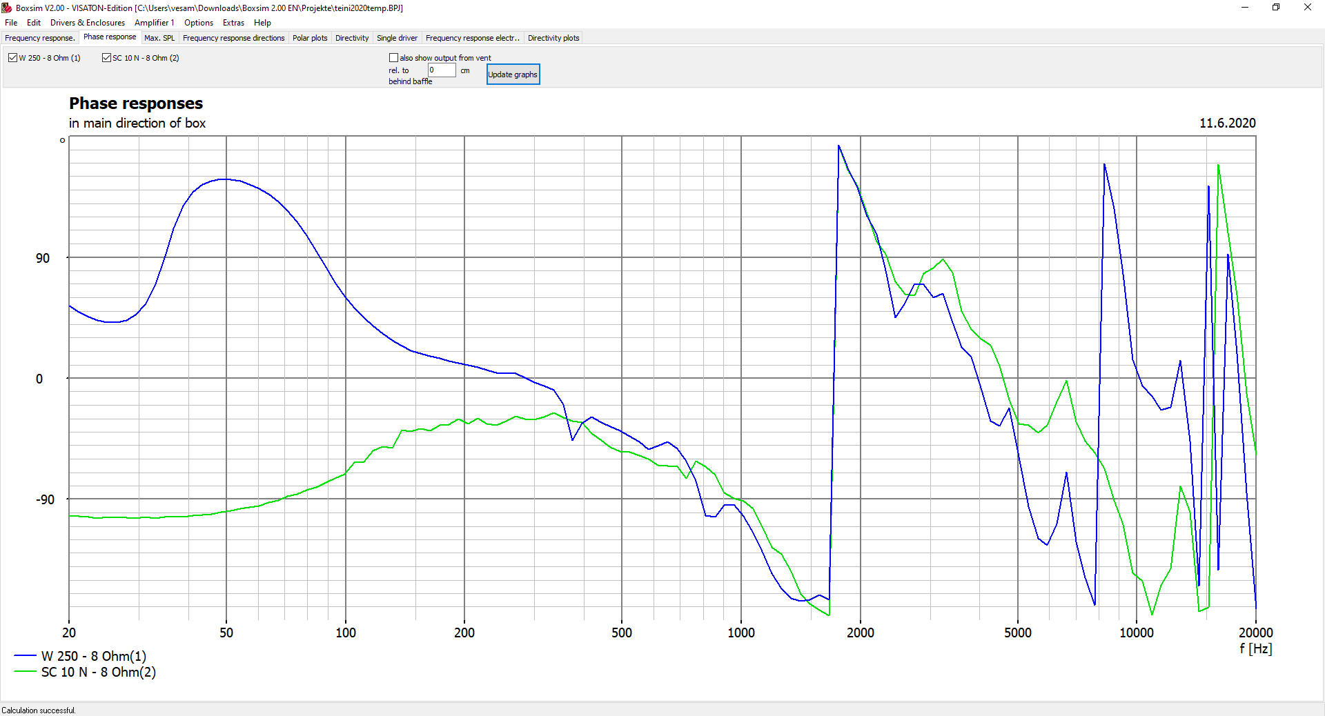

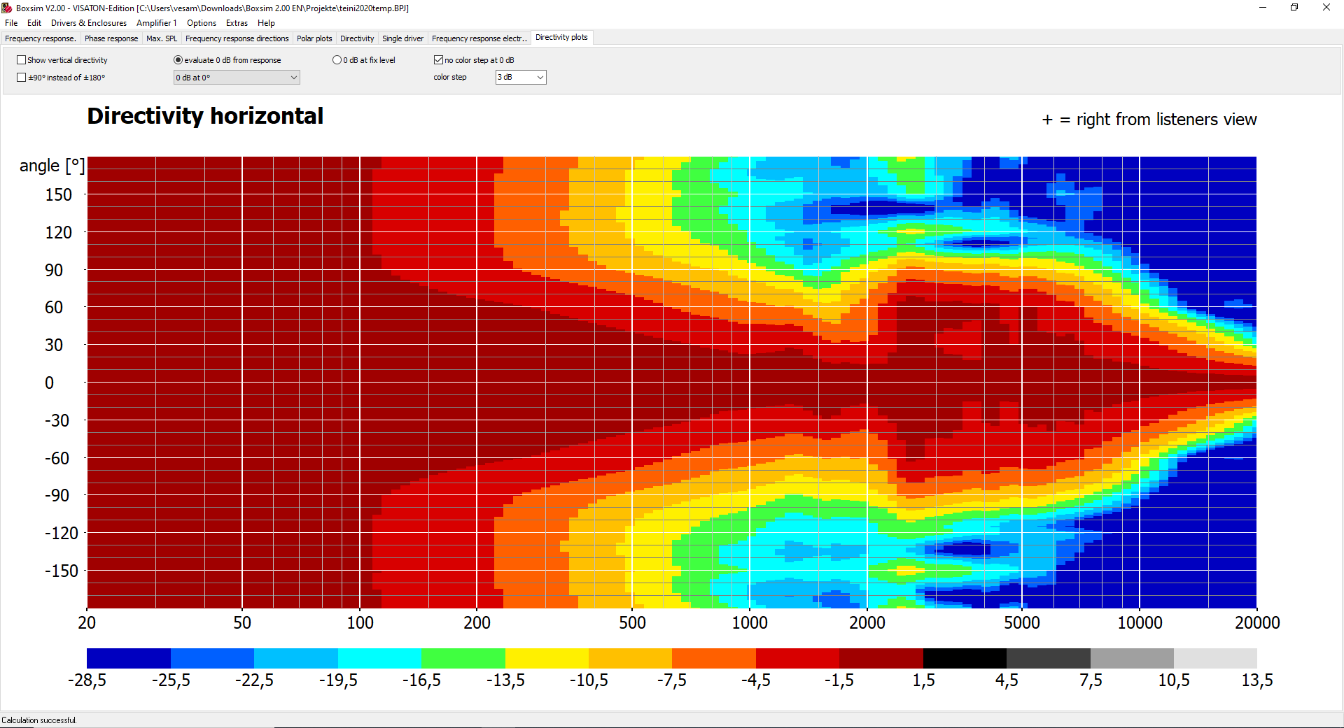

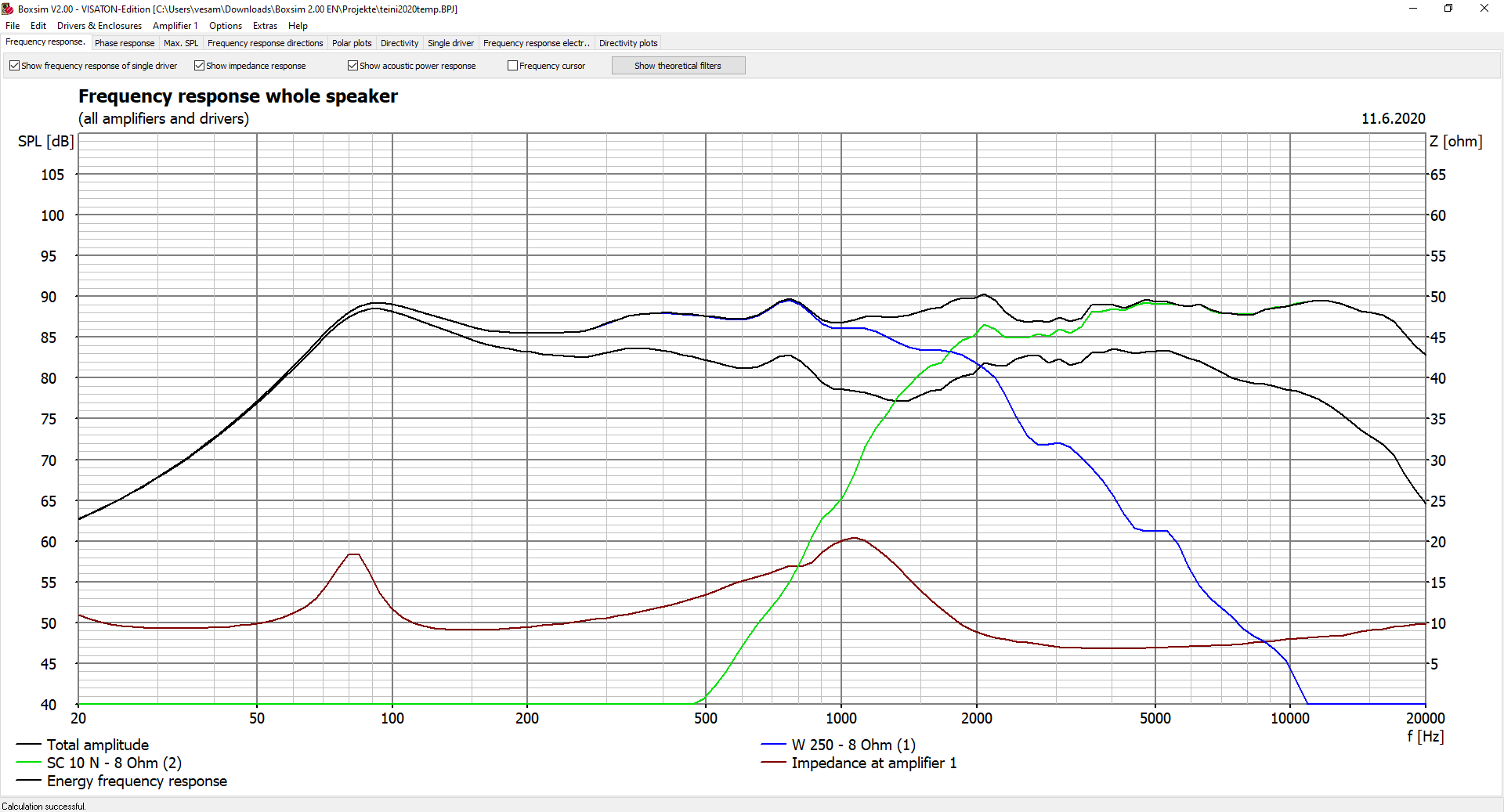

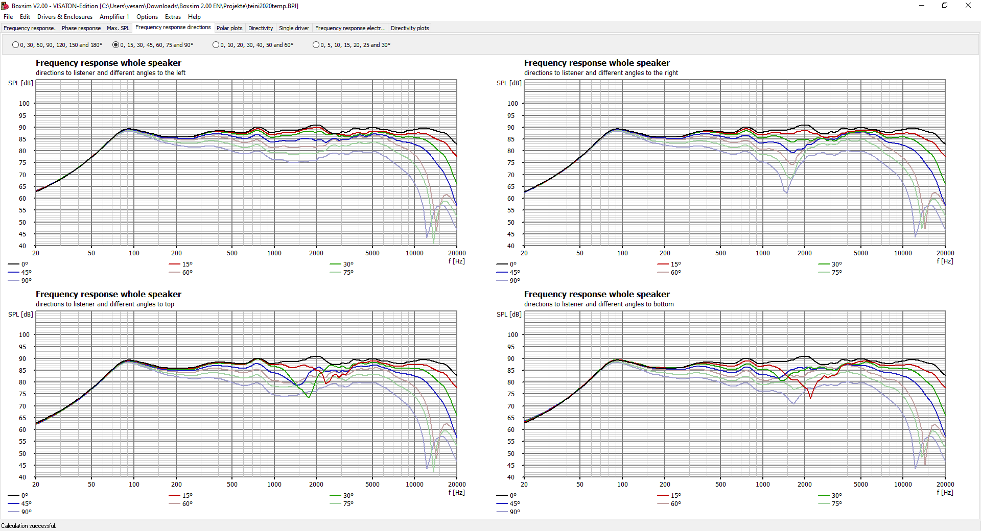

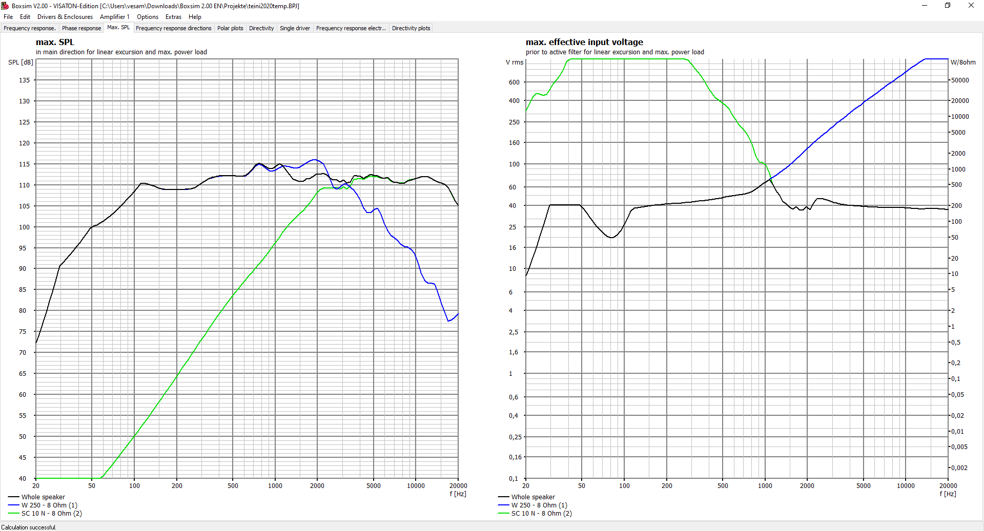

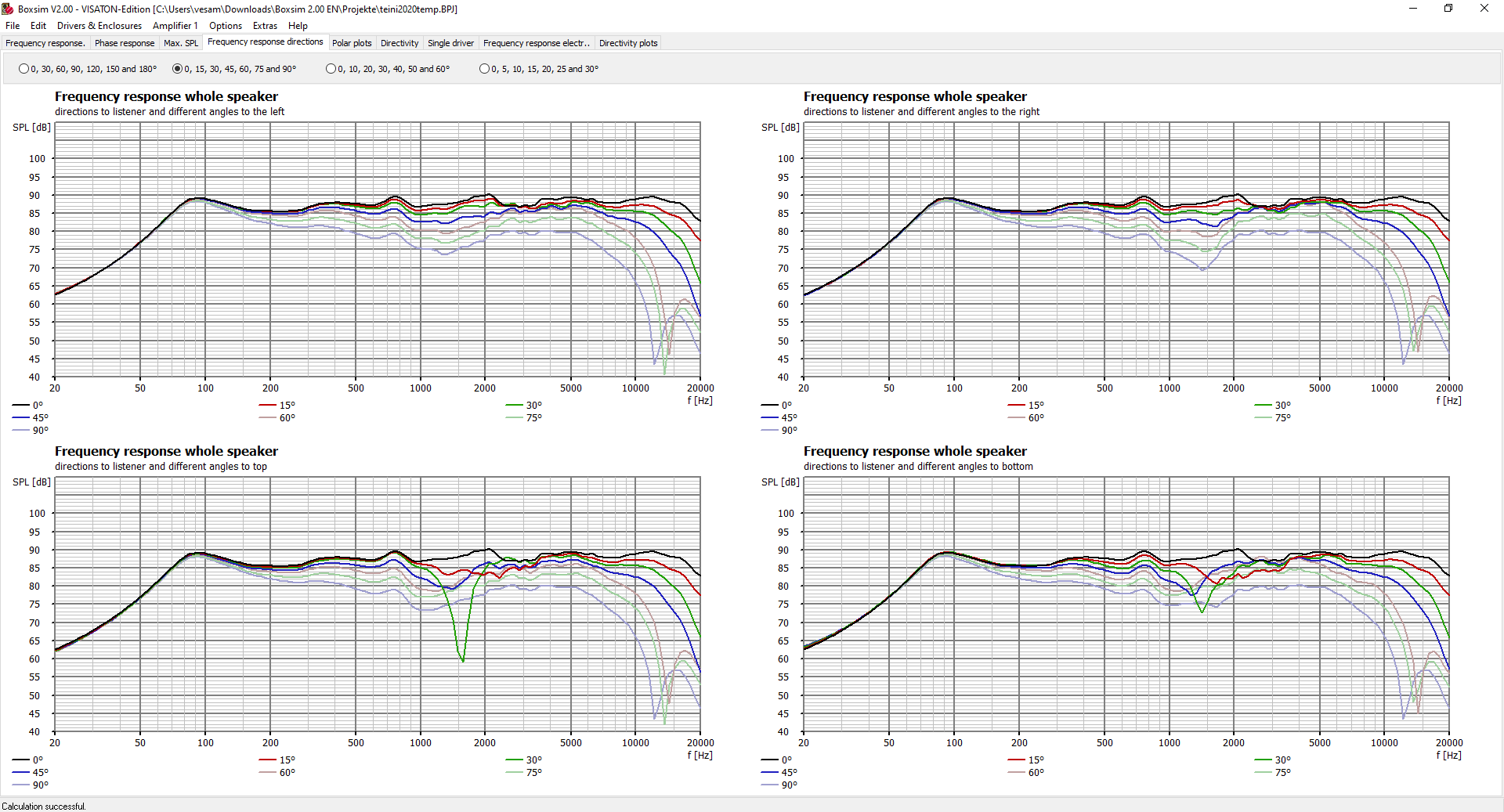

This is the best so far I could come up with designing Teen2020.

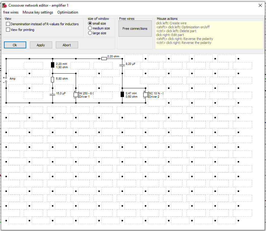

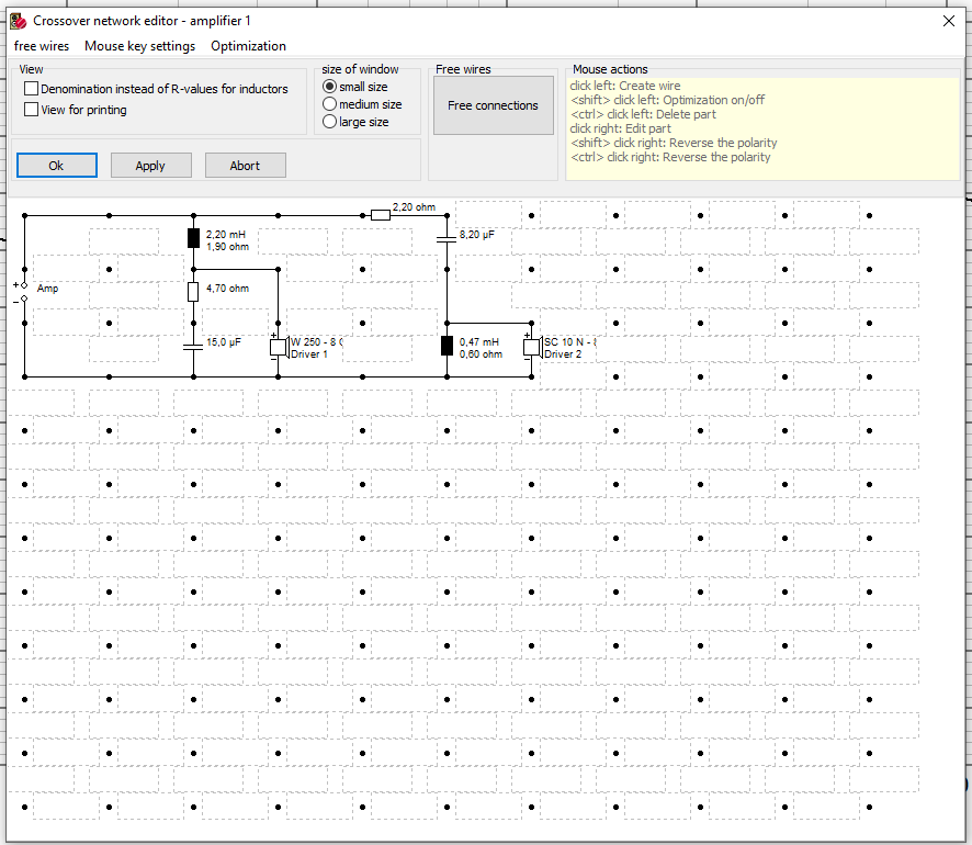

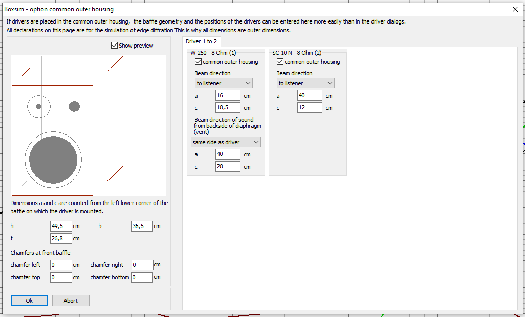

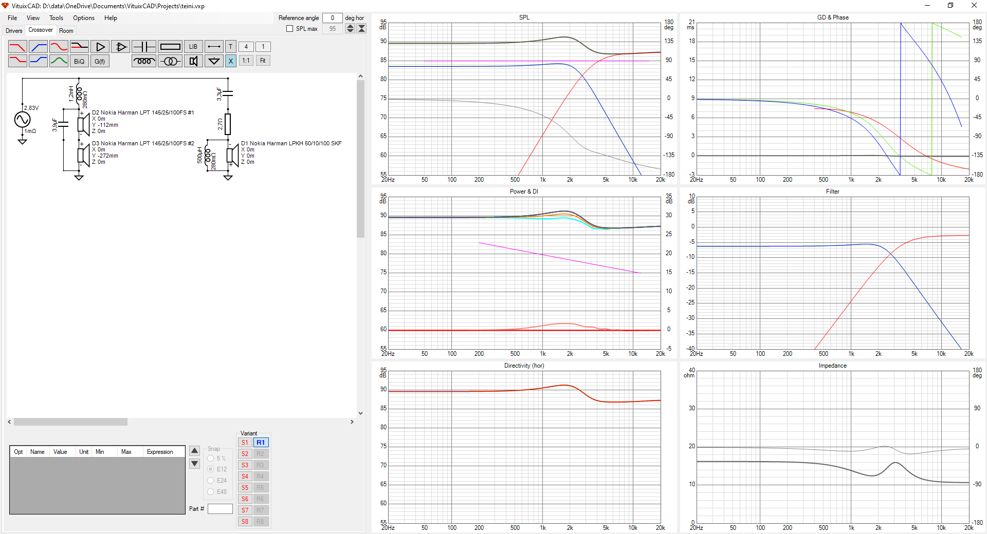

Erkki1 gave me the crossover electrical plan and suggestion was crossover @2200Hz, but didn't have the box optimimized to it. I learned how to do it and the crossover sets to @1720Hz. Some of component values was pretty close to what shop has to offer. I also tried to keep it simple because variance of the component actual values. I ended up crossover @1747Hz.
Ok, just make sure that the tweeter can go as low as you specified in the crossover. I suggest you use erkkis crossover, 2200 hz sounds better imho.
and please check all boxes in the frequency graph.
Did you mean this? 😉
yes, thanks. It gives a good overview of the total spl, the individual drivers and the total impedance.
Boxsim has quite frequently a tendency to move crossover frequecy lower than is good for the tweeter. But the algorithm is propably just optimizing the frequency response. If you want to keep crossover frequency at certain area, you should set some components to a fixed value (= not included in optmization). But, it is an iterative process anyhow.
Afterwards it would be interesting to see how the simulation compares to measured frequency responses and polar patterns.
BoxSim actually uses the boxes size. Latest graphs have this correct. Crossover @1737Hz

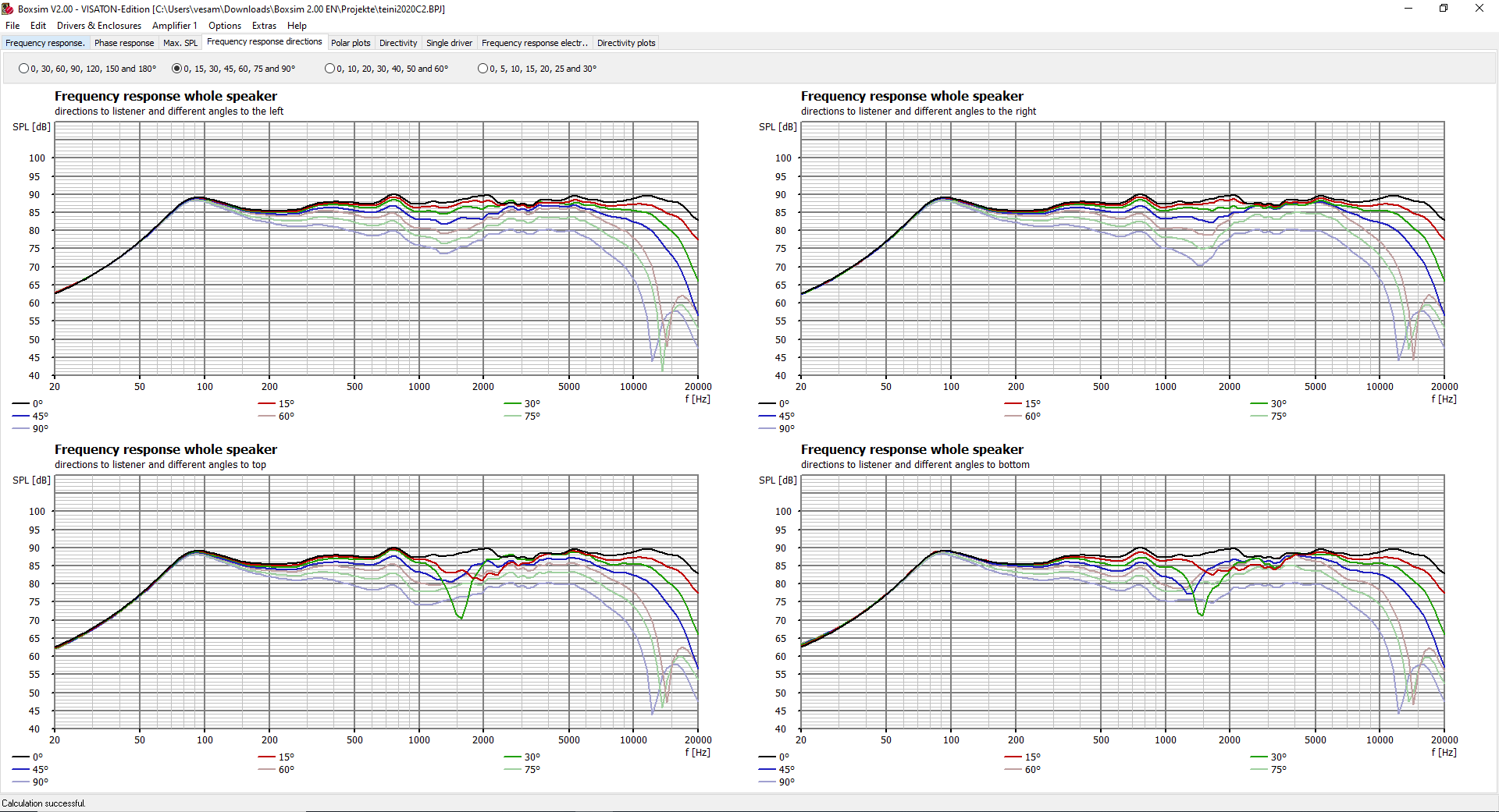

I am currently working on rising the crossover (a) 1737 -> (b) 2170Hz. Frequency Response Direction with 2170Hz behaves differently. There "V"'s don't line up. Does it cause concern?

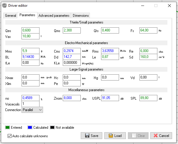

Original Teen Wall Speaker

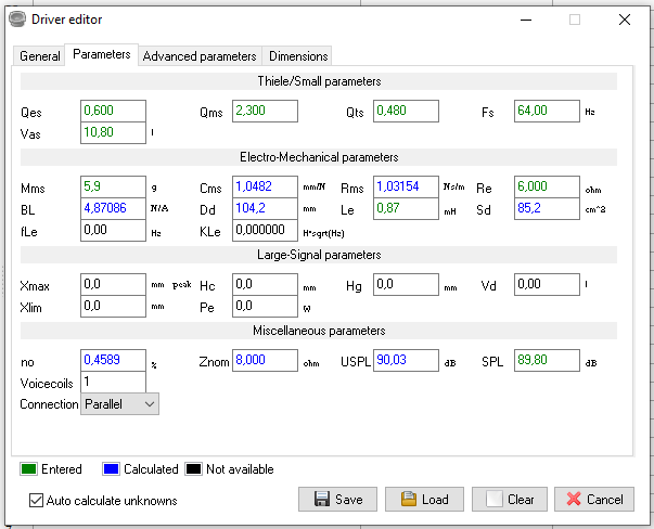

Bassdrivers: Nokia Harman LPT 145/25/100FS
Measured parameters:
89.8dB
Re 6.0
Fs 64
Qts .48
Qes .6
Qms 2.3
Le .87
Mms 5.9g
Vas .38 cu.ft. = 10.8ltr
Outer dimension: 145mm
Installation hole: 116mm
Tweeter: Nokia Harman LPKH 50/10/100 SKF
Impedance: 8ohm
Outer dimension 51mm x 51mm
Installation hole 43mm

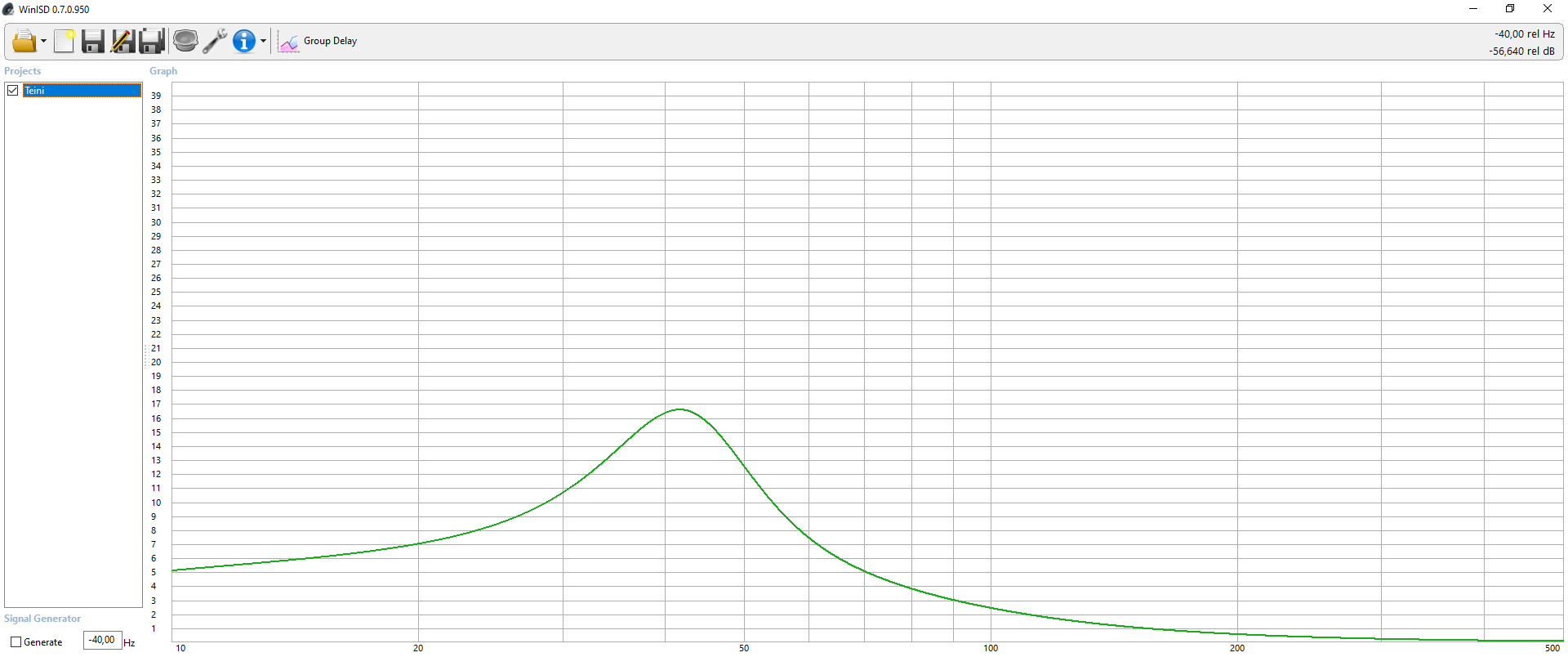

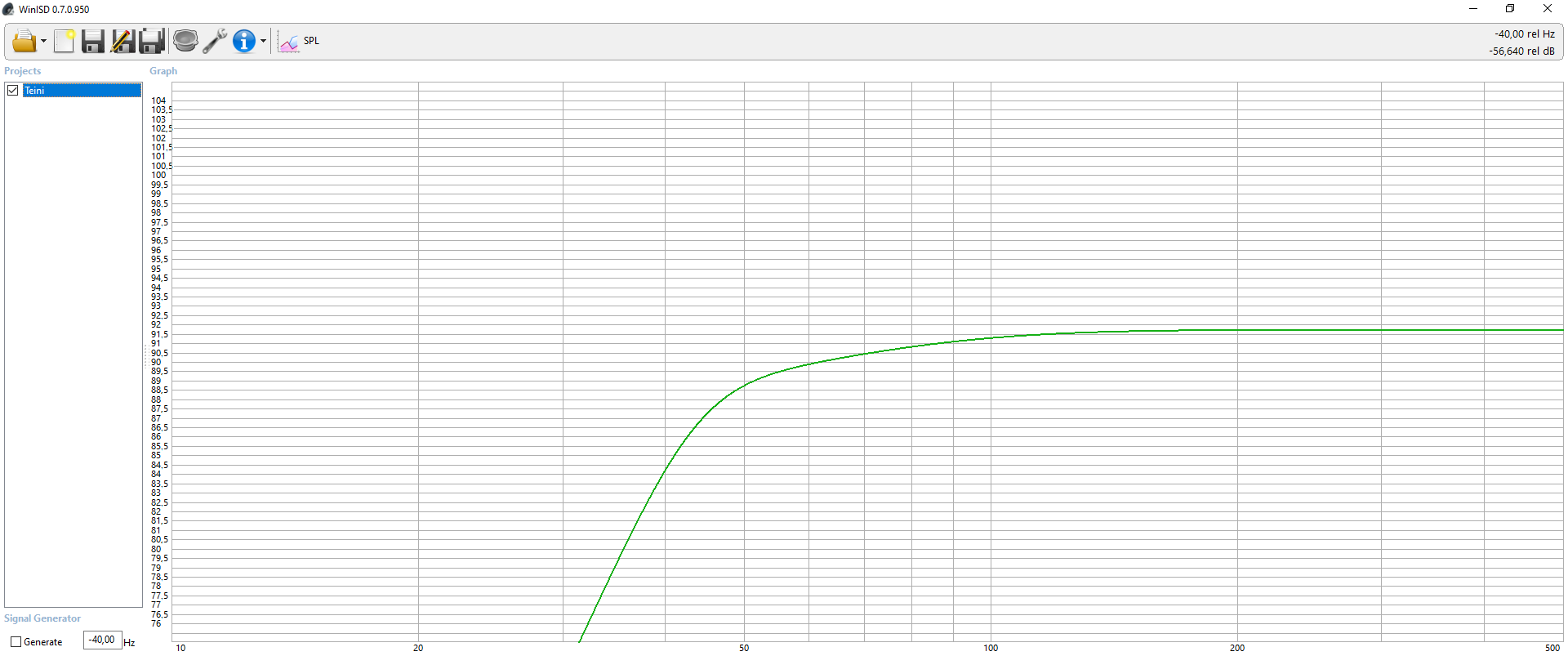

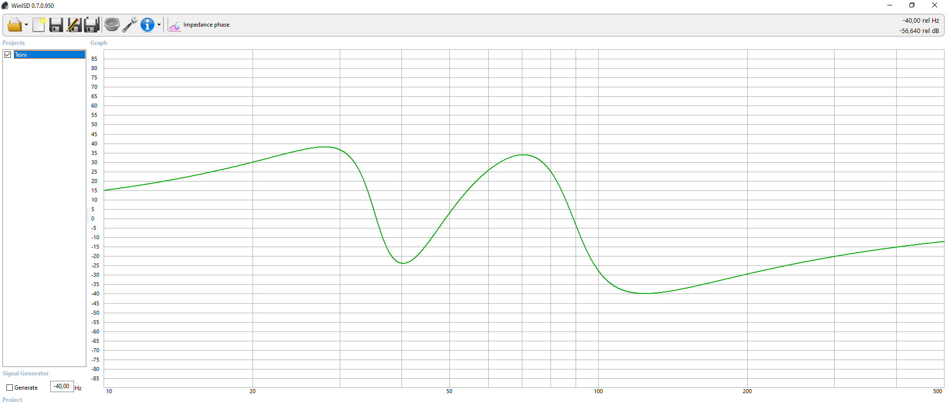

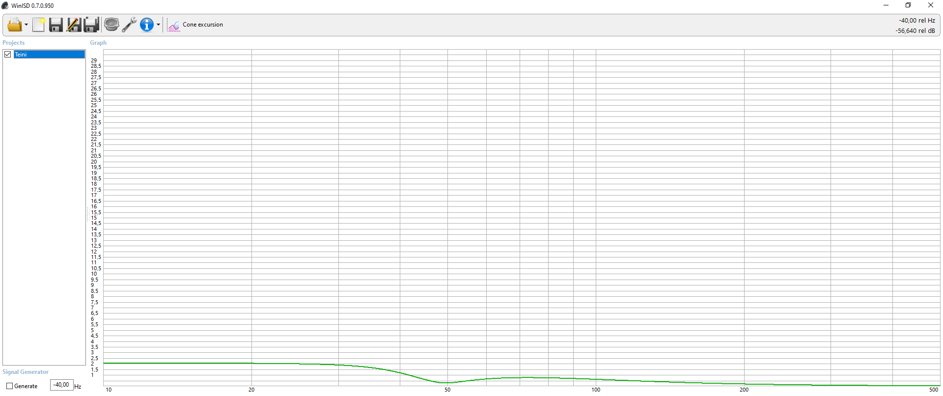

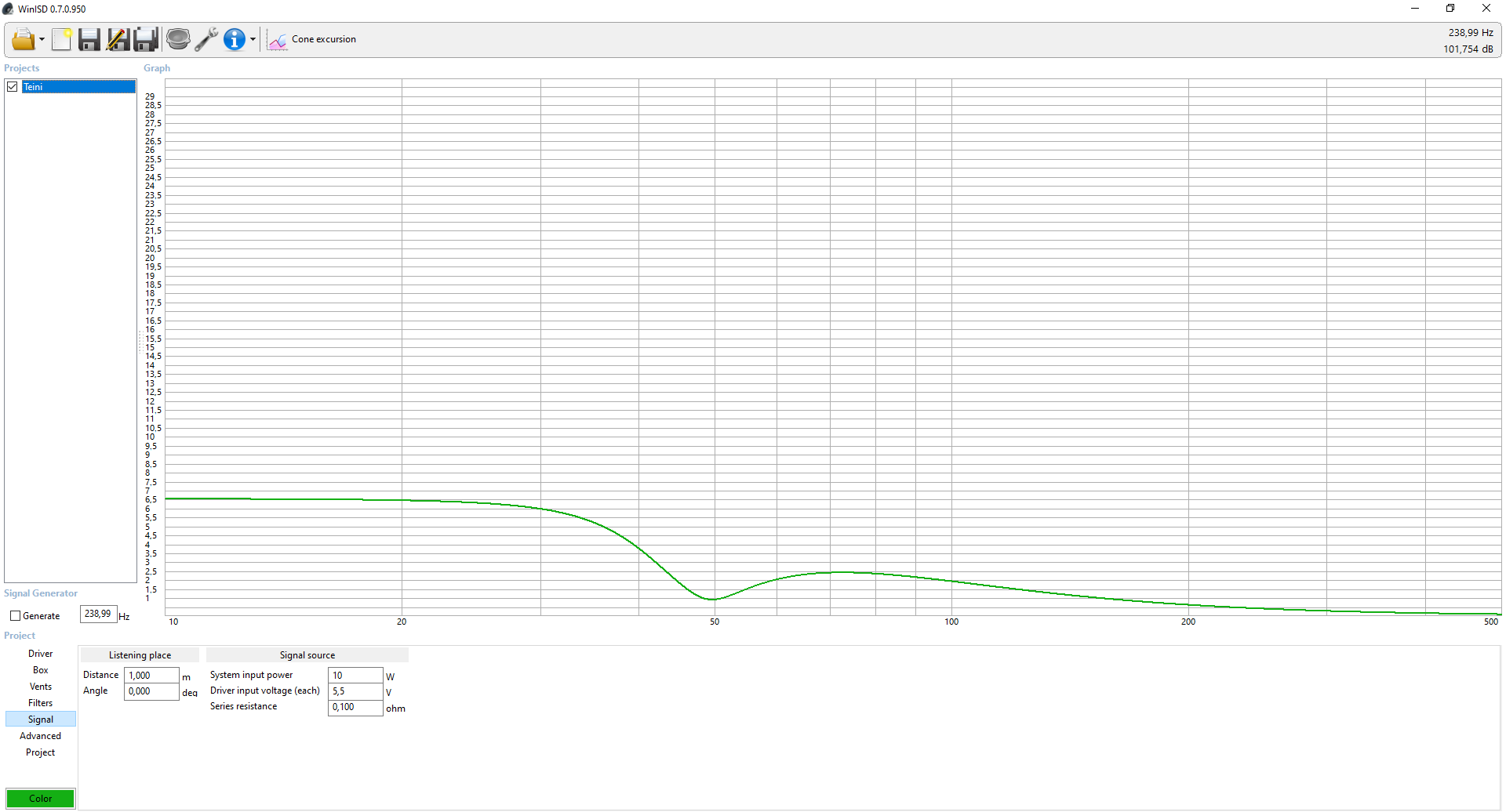

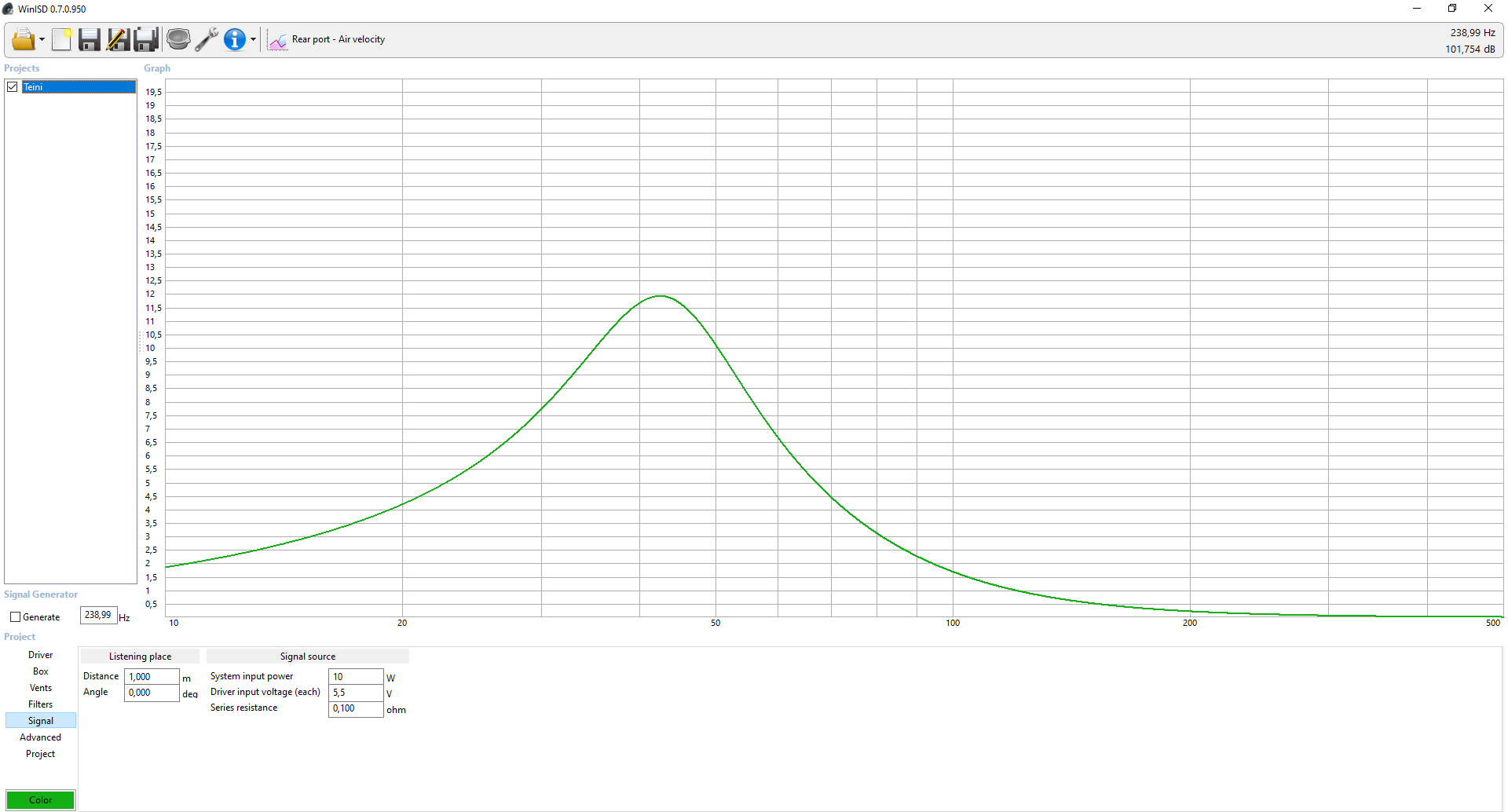

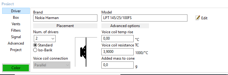

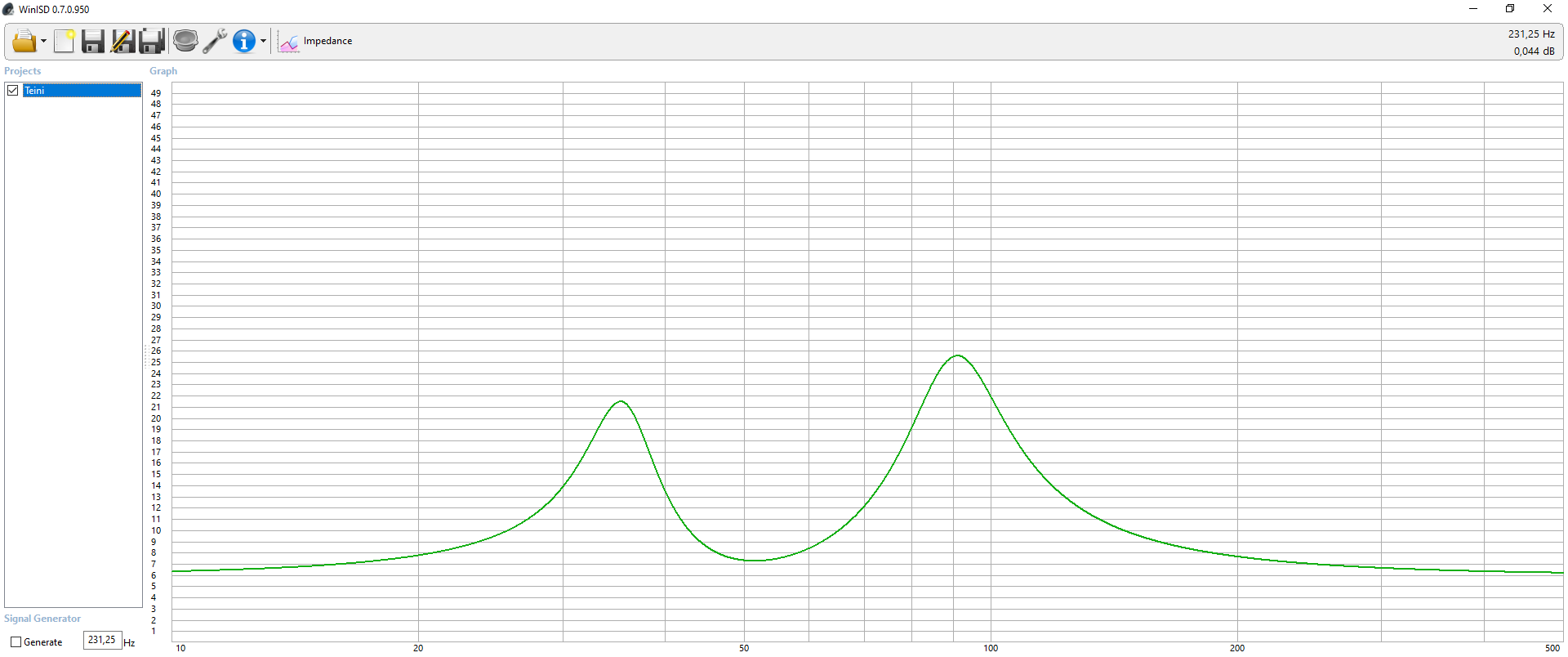

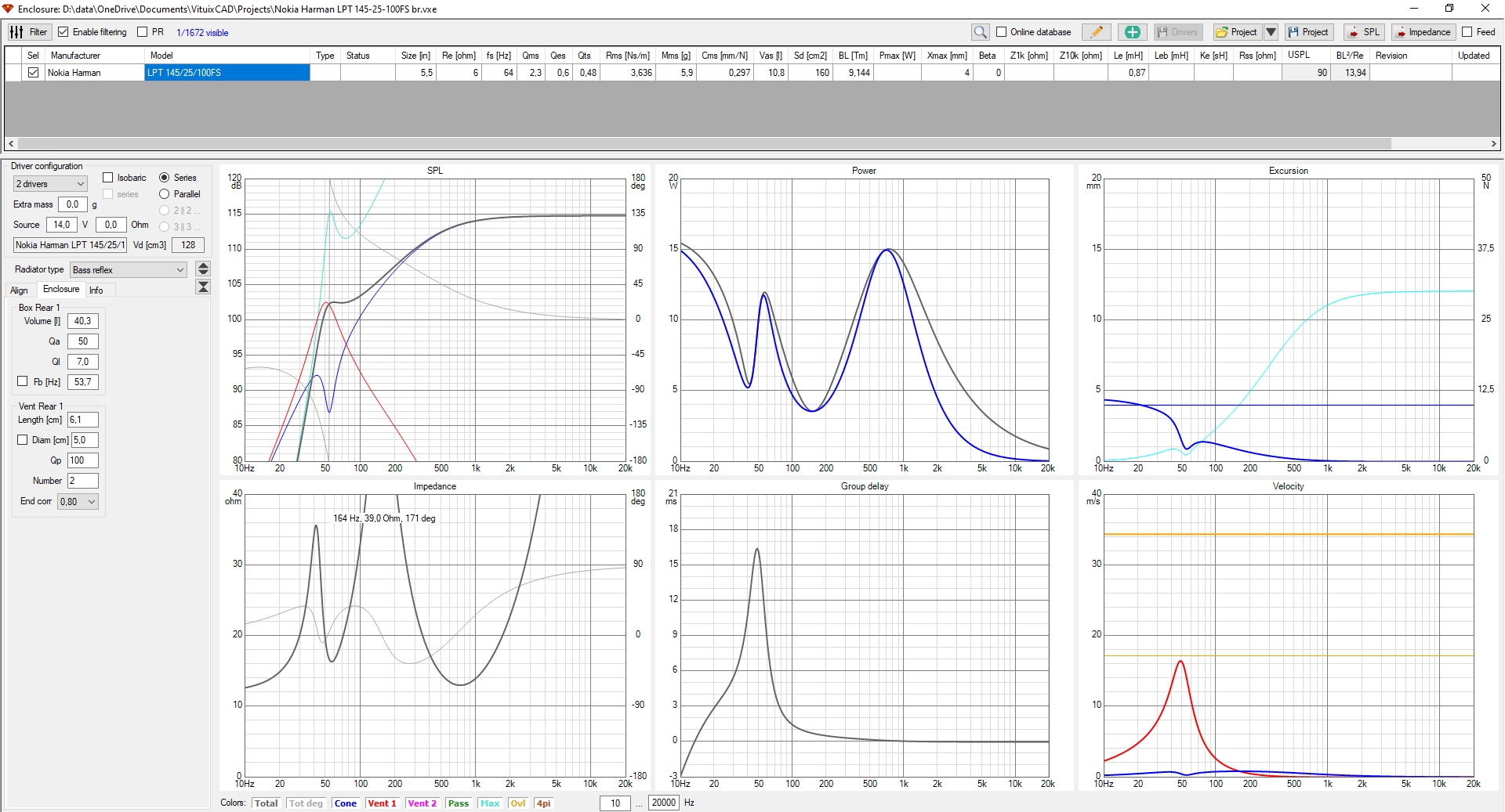

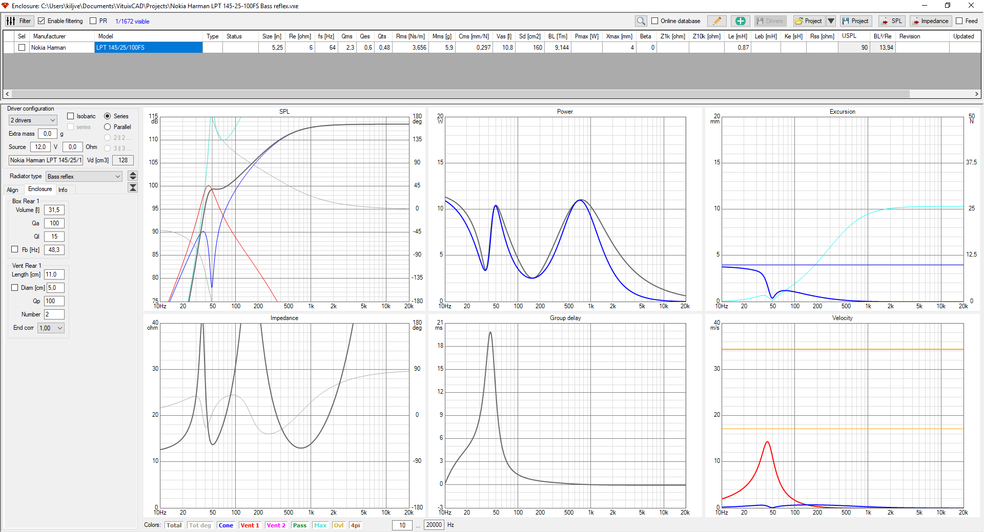

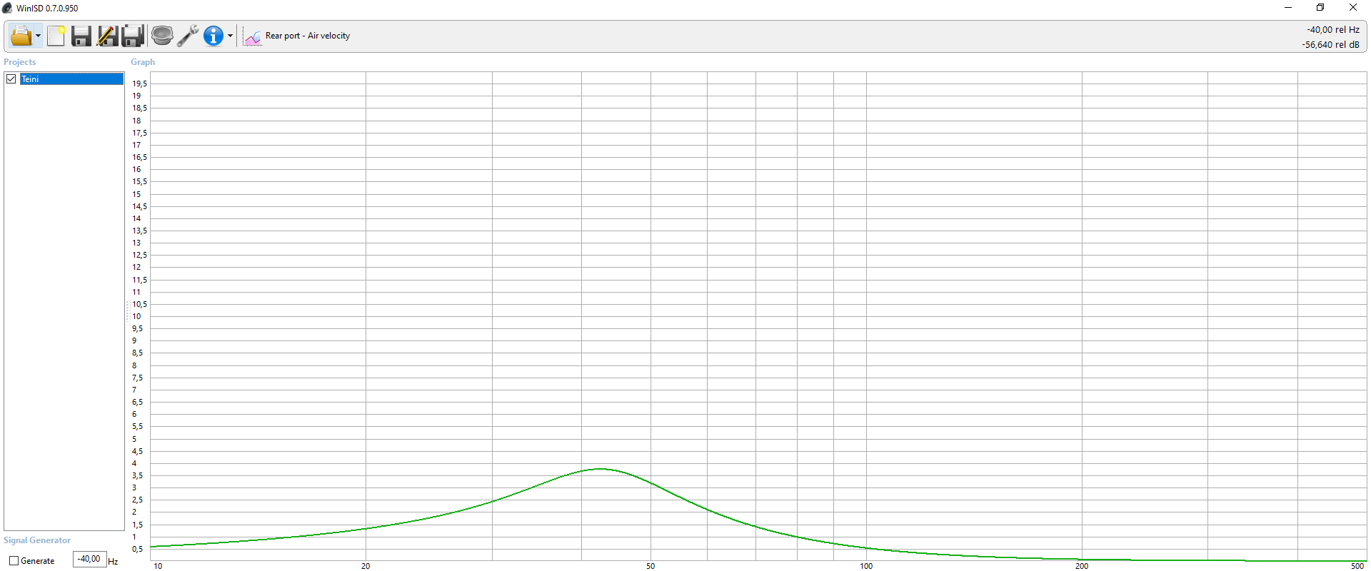

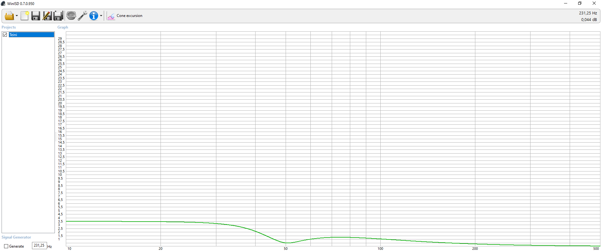

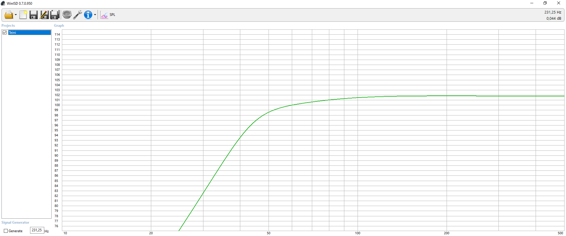

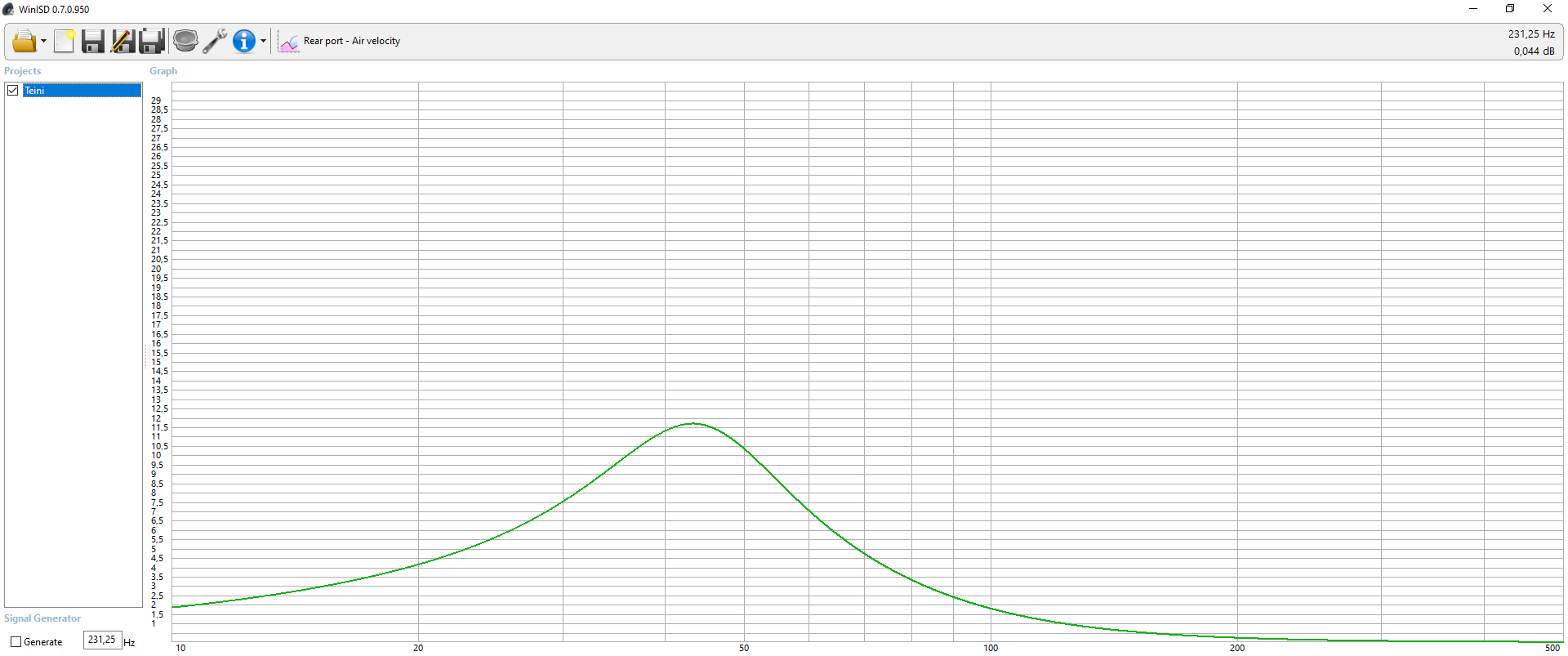

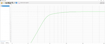

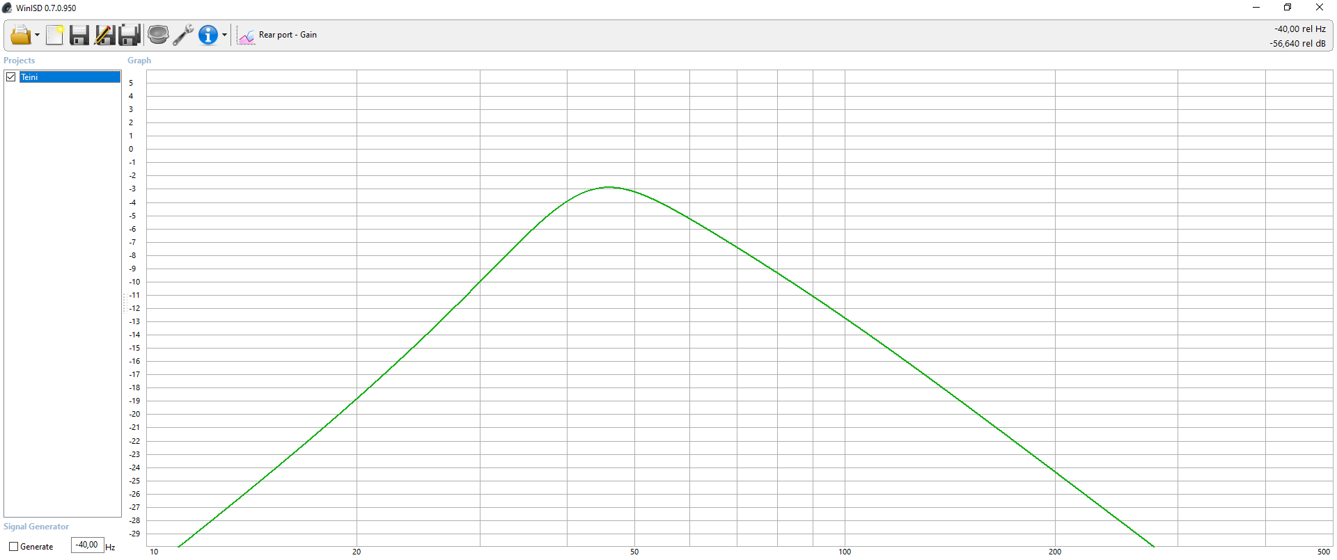

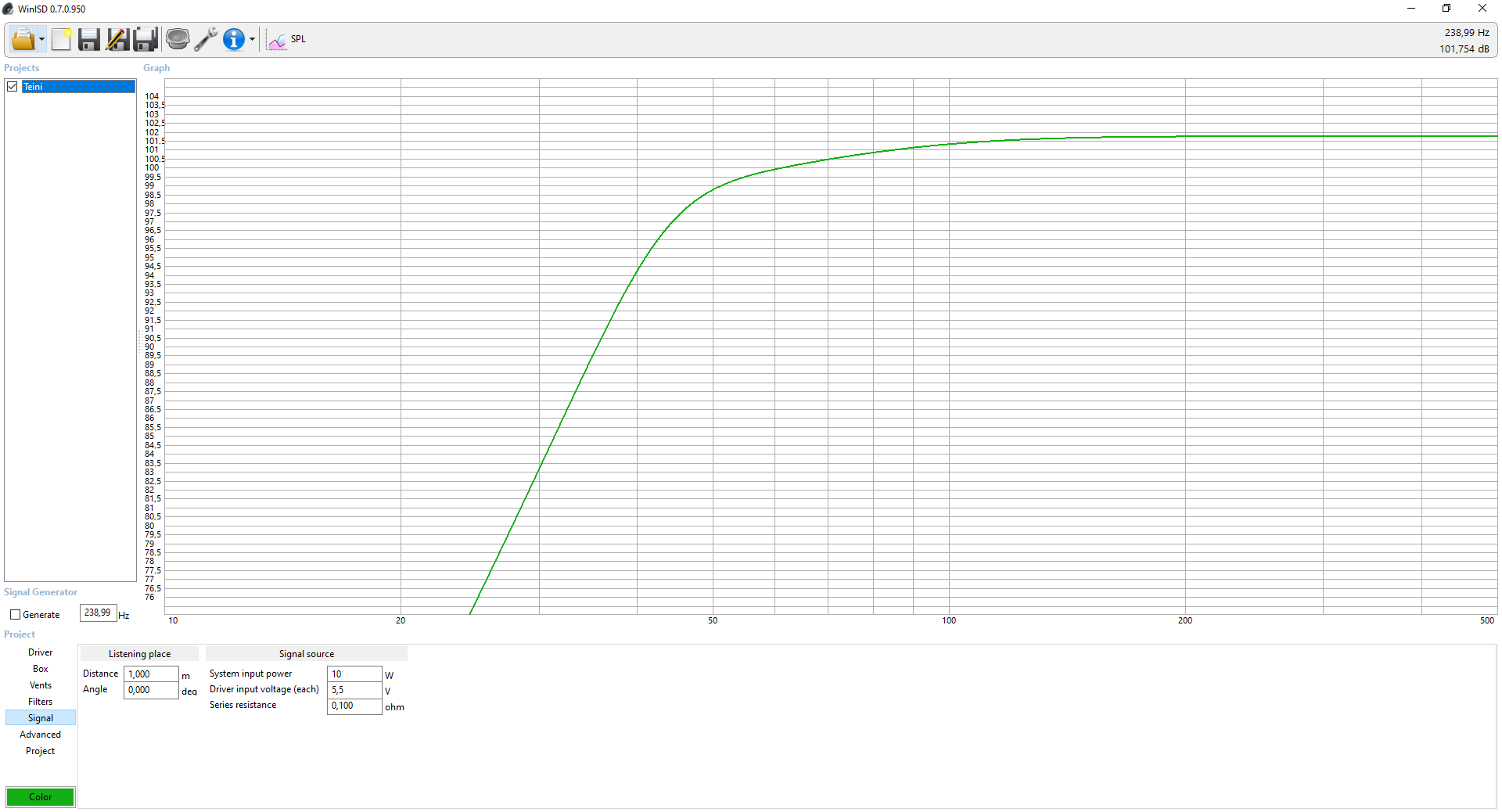

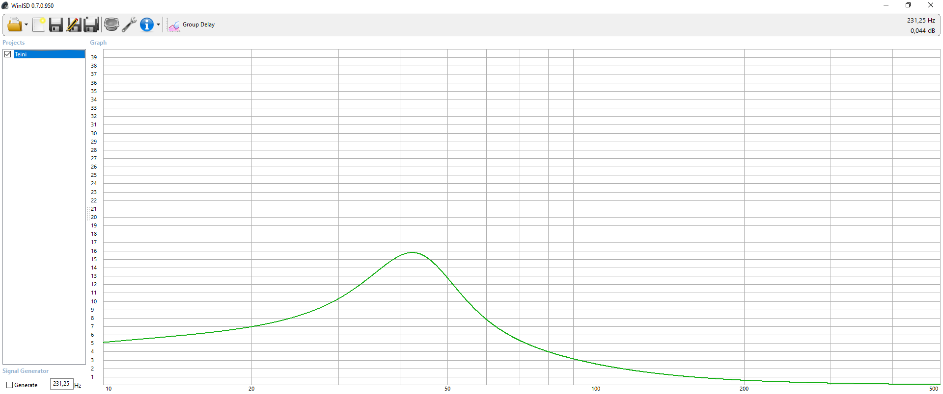

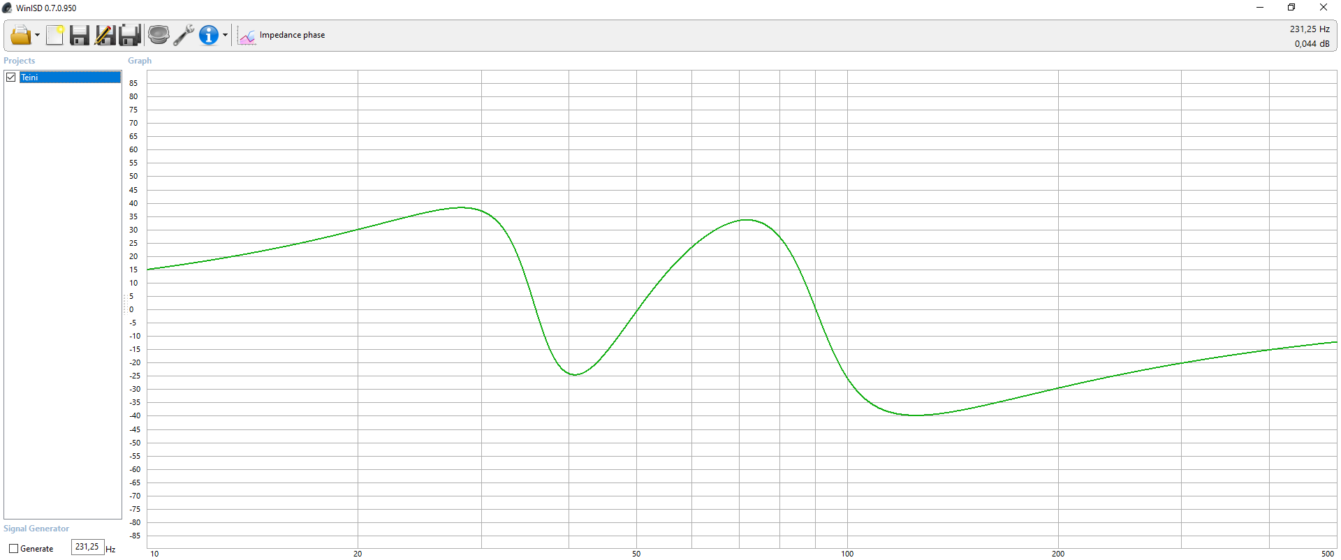

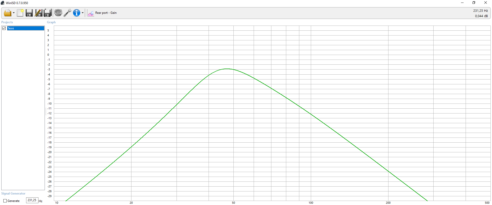

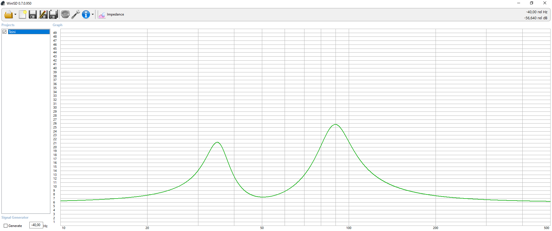

Some checking with WinISD
89.8dB
Re 6.0
Fs 64
Qts .48
Qes .6
Qms 2.3
Le .87
Mms 5.9g
Impedance: 8ohm

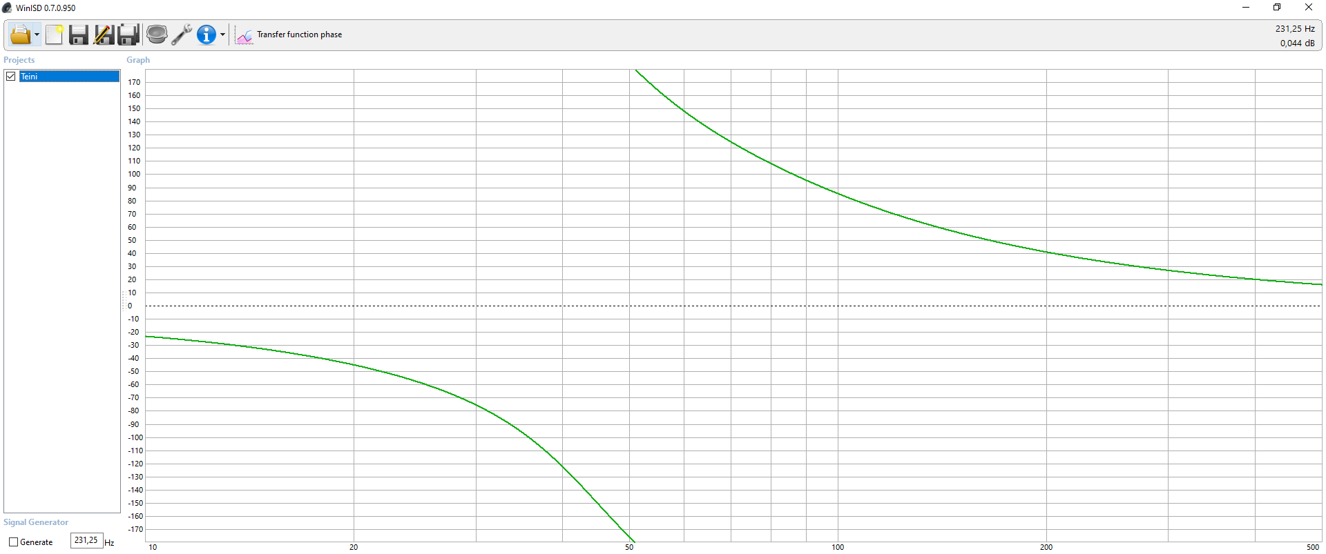

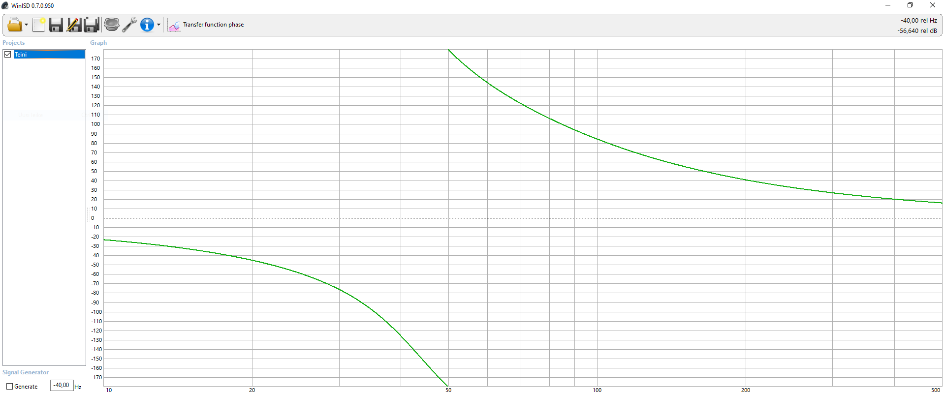

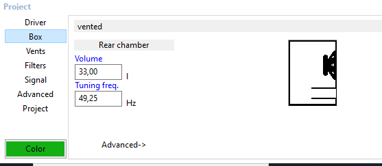

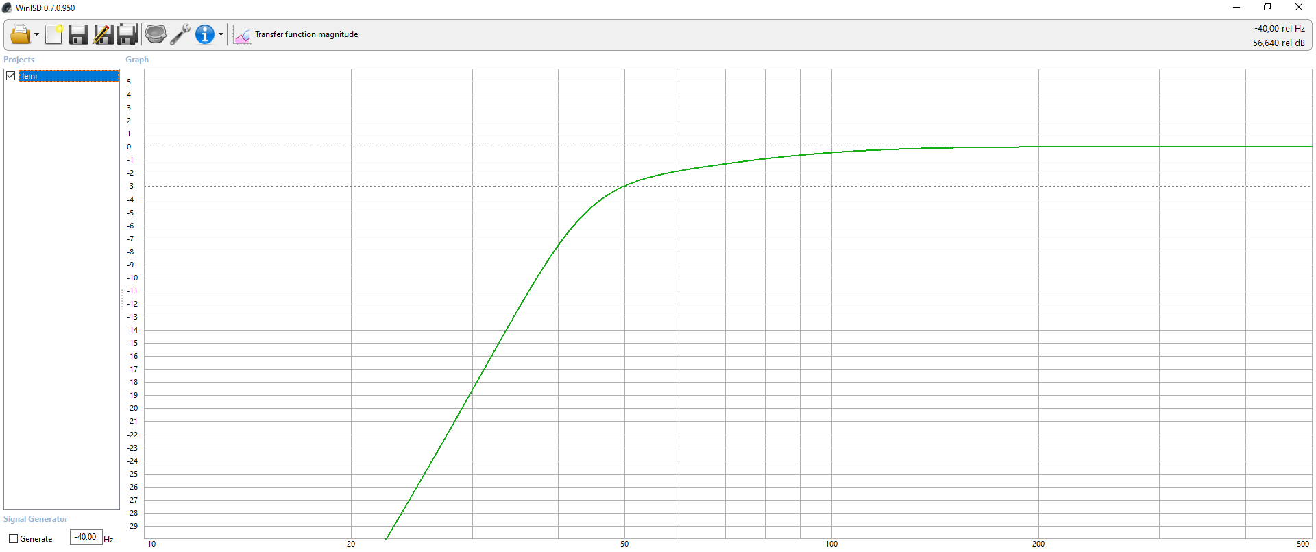

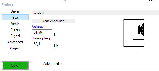

Support structure takes up some space so actually volume is 31,5L

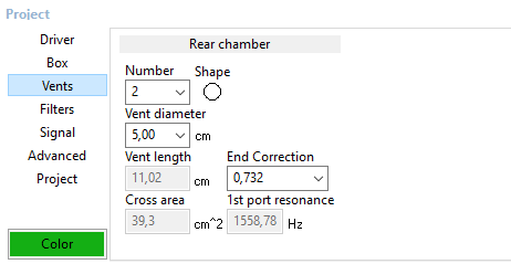

The Original Teen Wall Speaker DIY kit was meant to placed at wall. I am thinking about something that is placed 10cm at front wall.
Outside HxWxD
1220*200*216
Inside HxWxD
1196*176*192=40,4L

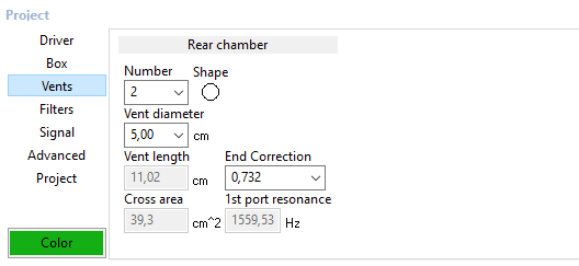

Chebyshev tuned
Bass reflex tuning frequency Fb=53,7Hz
Bass reflex port 6,1cm long and 5cm diameter
Number of ports 2pcs
Ports face backwards
Probably doesn´t go low as original but gets more power at 50Hz
Outside HxWxD
1220*200*216
Inside HxWxD
1196*176*192=40,4L
Chebyshev tuned
