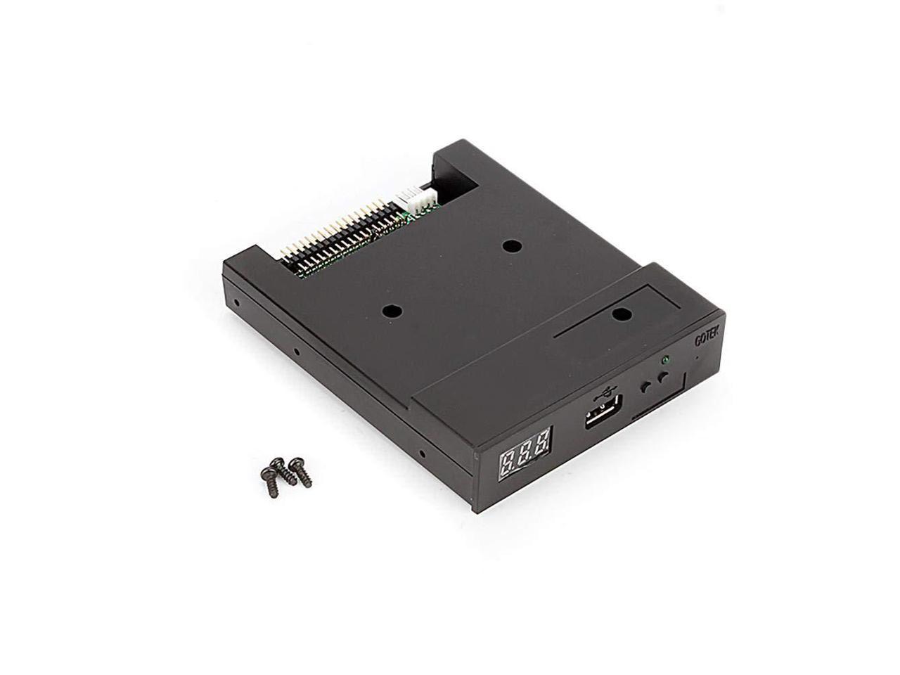

There is a thing which looks like a floppy drive on the PC side but is really flash memory and a button to "change disks". Like $40.think twice about using this system today is the floppy drives.
I can't remember the trade-name of the thing so I am hoping someone else does. If you can transfer the box of diskettes to eRAM, the thing will run faster and for years more.
EDIT: ah-ha.
https://www.newegg.com/p/1B4-0AEF-002R6?Description=floppy drive
Looks like a 3.5" flop on the back. Front is 0-999 display, button, and USB port. Since you have 5.25" drives, you need plug-converter and 1.44M driver support in the TEF.... and 1983 is not promising.
If you get this far, http://www.deviceside.com/ may be useful.

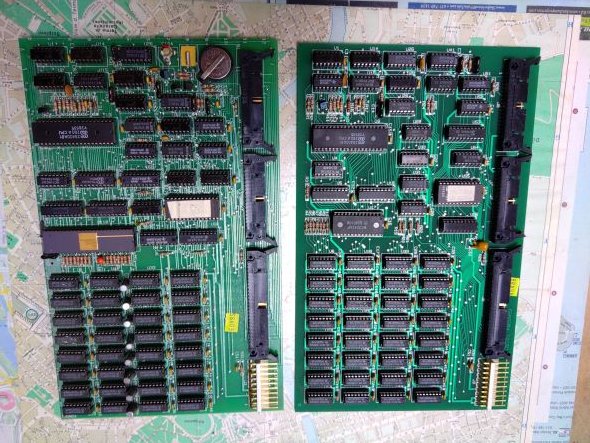

Good point!! The TEF 12 and TEF 12 PLUS appear to be identical machines -- with the exception of the CPU card. In the PLUS, the Monitor has been updated from "V17 8-18-83" to "Mon21 TEF12+ 5/15/88" and the (socketed) memory has been bumped-up 4x to 1MB from 64KB. But if the schematics are to be believed, there was only one I/O board, which would be able to read all these densities. So, it's software?I probably do, I'll look tomorrow. The problem is going to be how to get it to you in readable form. My TEF10 can't write TEF12 floppies (different densiry and format).
All my hardware docs are for the Tefdos machines (PLUS), which uses both 790K and 1.4M disks. Is it possible that the TEF 12 (CP/M 2.2, not PLUS) will also read the TEF 10 low-density disks?
FWIW, I found these specs as parameters for something called "fluxengine" (on Github): Techron TEF 10 - DSDD 96 tpi 5.25" - 512 x 10 Techron TEF 12 - DSHD 96 tpi 5.25" - 512 x 17. And there is an extensive list in a diyAudio thread about CP/M boot disks that also highlights the "DD" vs. "HD" difference (w/o sector details). I presume that "512 x 10" means 10 sectors/track, sized 512 bytes (or 17 for the TEF 12).
I also found a Techron System 12 (not PLUS) brochure hidden away on Facebook that mentions "1 MB disks" and didn't say anything about backwards TEF 10 compatibility. Could they have made these machines floppy incompatible . . . ??
That could very well be. I went from 10 to 12+ so no experience with the plain 12.
Yes, Keith Jebelian significantly expanded the monitor functions in the Plus.
Makes sense.But if the schematics are to be believed, there was only one I/O board, which would be able to read all these densities. So, it's software?
