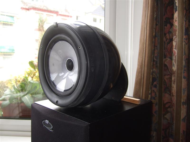

Never saw the black fiberglass ones. But I was living in the land of Focal at the time (Paris). Maybe they didn't do them in France?
Any particular Seas driver model number?

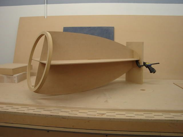

The H1333-08/06 T18RE/XFCTV2
The crossover for this poly cone driver will be challenging enough. I don't want to think about what it would take to get the mag cone version sounding good. For that matter, I'm not even sure I can get this one to my liking, but it sure will be fun to try.
I have yet to see that shape elsewhere to use to pattern off ( a mold ).

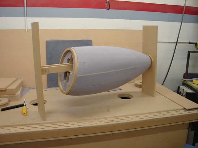

This picture you see is a 3D model, so I don't need a mold. The file will feed into a CNC milling machine which will do all the work.
There is discussion as to merits of any exotic curving shape beyond spherical or ovoid.
There is probably a lot to it that I haven't considered. I've been thinking of ways to shape the interior so that the concave surface does not create a central focus point. I've got a few ideas, but nothing solid.
The KEF 207/2 uses a slightly ovoid(?) enclosure for the 6.5" Mid/HF driver, the B&W 802 however looks slightly more elongated on it's Kevlar driver and much more so on the tweeter portion.
That's the part I'm having a hard time with. I don't know how to model it, or even consider it conceptually. Someone here mentioned a ripple tank. It seems like an interesting idea. I'm not sure if the results apply though. For instance, a ripple tank will let you visually track the wave, but what happens when you apply a set frequency instead of a single pulse?
Makes me want to buy a waterproof speaker and see what happens.
I'm hoping someone a whole lot smarter than me will chime in.
In the past I put a lot of effort into deadening the cabinet, but never thought much about undamped waves passing through the cone.
I have designed and built some pretty unique/effective racing mufflers in the past, but I am having a hard time applying the same concepts to a speaker.
Maybe this thread should turn into a discussion of killing what comes off the back side of the cone as opposed to just making a rigid non-resonant cabinet.
BTW, if you look at the top view of the enclosure, you will see that it rolls back rather abruptly where it meets the driver frame. I wonder if I should re-shape it so that the radius starts gradually right from the edge of the driver?
All of this stuff is easy to change at this stage so I will not start making sawdust until I have some confidence that the shape is correct both internally and externally.
Any input is appreciated.

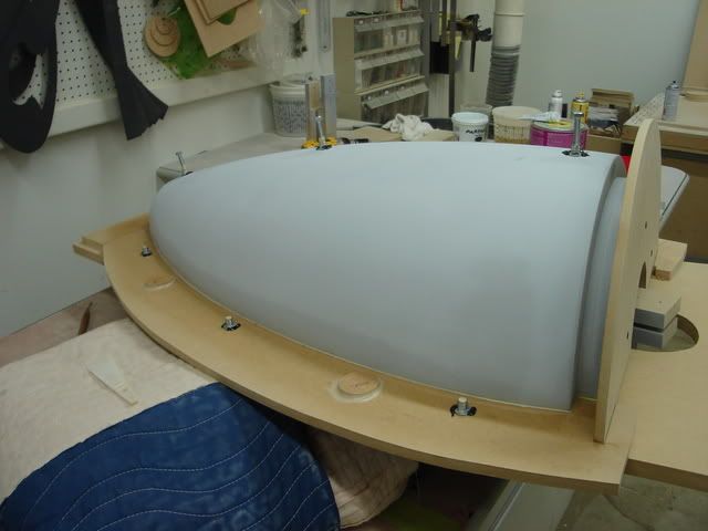

I re-designed the basic external shape to get a better blend with the driver face.
I also have less of a sphere, and I hope that this will make it easier to control reflections inside the cabinet.
Follow the link to see the new shape.

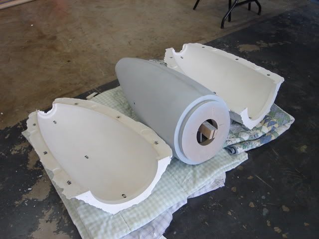

since you know how to make a mold you are a step ahead...
now to create the piece to make the mold is not that bad either...
these are pics taken from a car audio build done by Chris Yato...but you get the idea

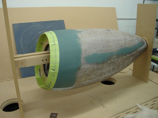

trusound
Great pics:
I'm guessing that the "blue filler" in the 2nd pic is the same blue board insulation that I am familiar with.
If so, it gets used extensive for stage stuff/props as well - it's very easy to carve and shape.

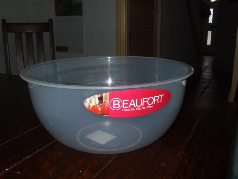

While there is plenty of information available for designing the correct size rectangular speaker enclosures, I haven't seen able find anything for spheres.
Does anyone know if there is an optimum diameter of sphere for a particular size driver and what about the internal volume? Use the recommended volume for a sealed rectangular enclosure or what?
I have a couple of 6 1/2 inch Kef Uni-Q drivers which want to build spheres for. Any suggestion regarding what size I should build the spheres?

HK26147 said:I posted a link to SpeedCrunch...
Thanks for the reply but working out the volume of a sphere I can already do and that is not the problem.
The problem is what size to make the sphere in the first place. After all for example, I could put a 6 inch driver into any size of sphere that it would fit into, an 8 inch, 10 inch, or even a 36 inch sphere for that matter.
What I am really asking is what is the optimum size sphere for a particular sized driver that will enable the external curve to minimise diffraction as much as possible?
One could imagine a 6 inch driver in a 6 inch sphere there would be practically no curve, it would be all speaker. Similarly the same driver in a 36 inch sphere would practically be all curve and very little speaker. There must be some optimum external size surely.
Has anyone done any studies of this and come up with some recommendations do you know?
For the internal volume I will just make it the same as what is recommended in a speaker enclosure design programme. I can do this independently of the exterior diameter by just making the walls thicker or something.
The general rule is that obstacles capable of diffracting (bending) sound must be large compared to the wavelength of the sound involved.
500Hz has 27" wavelength
1125Hz has a 13.5" wavelength
1.5" - a typical round-over radius = 9Khz.
6" = 2250 Hz
12" =1125 Hz
At what point ( wavelength size vs radius ) that the effects starts to manifest, or if it has been quantified - I don't know.
Curves on the scale we are talking about would have to considered in the range of HF, if the above applies.

Well, I have made a couple of 8 inch spheres for my KEF speakers and now that they are completed they looked a little small to me. Not much curve relative to the size of the speaker.
Even so, I have tried them out and I am very pleased with the results. Can't notice any better frequency response in anyway, but definitely a much better soundstage. In fact an amazingly better one, which really adds life to the music. Hard to define exactly, but a very noticeable improvement.
I looked at the Nautilus design and they have a lot bigger sphere relative to the diameter of their driver. I measured it at approximately 2.35 bigger. Which equates to instead of only a 200 mm sphere which I have made but a 350 mm one. So the next project is to make some larger spheres and try them out.
The method of construction I used was fairly simple. I noticed in the supermarket they had different size plastic mixing bowls and I bought 4 220 mm ones. Only 99p each. So that definitely didn't break the bank.
From a supplier of fibreglass and resins and I got some 400 g chopped mat and a bag of Crystacast, a plaster casting powder.
I started off by spraying the INSIDE of the bowls black. Cut 2 circular plywood rings of the correct size to mount the speakers on, placed them inside 2 of the bowls and plastered the INSIDE of the bowls (one layer at a time) with two layers of chopped mat. Let the first layer dry for approximately threequarters of an hour before laying up the next layer.
Plastered up the remaining two bowls, with two layers of chopped mat.
When the bowls were dry, cut-off the now surplus bowls bottoms so as to be able to mount the speakers. I also cut off the bowls rims. Stuck the two halves together with No Nails. Made an elastic band from a bicycle inner tube to cover the bowls joints.
Working from the inside of the bowl leaves a professional shiny exterior that requires no finishing whatsoever.
Nice work and quick too.
