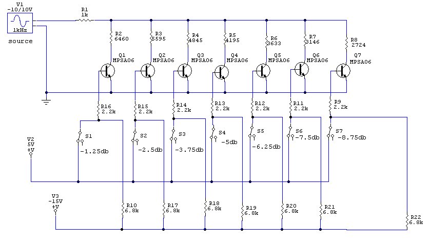

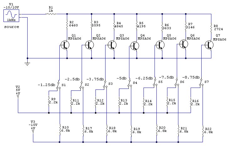

Referencing the attached schematic:
Switching the bjt's with +5V (as from a microcontroller) will pull the shunt resistors to ground. Each consecutive resistor from left to right is added to the previous (I have a spreadsheet to calculate values if anyone is interested). The -15V supply turns the bjt switches completely off (should be higher negative voltage than the highest negative-going signal excursion).
Simulations show low distortion and very little if any affect on bandwidth (ie capacitive loading).
I have no idea if this is Wayne's circuit or not, but it seems to work well, is cheap and easy to implement. I'm going to try it in a preamp soon.
I will be adding another ladder for the 10db steps, so I should have an attenuator with a range of -88.75db to 0db in 1.25db increments.

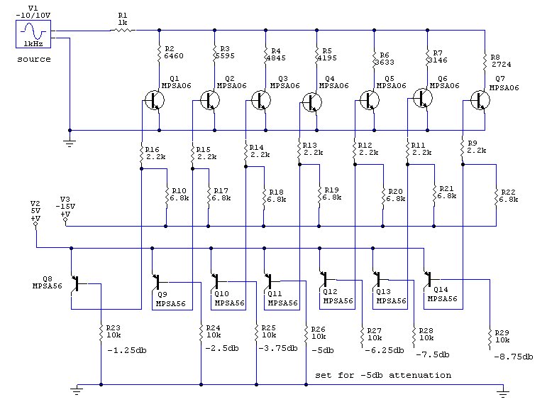

a better arrangement
This switching arrangement should work better. Think of the switches as active PNP elements pulling up to 5V, and the 15V pull-downs will work when they are in a floating state. I think this should work straight from a microcontroller, but would have to test the idea.

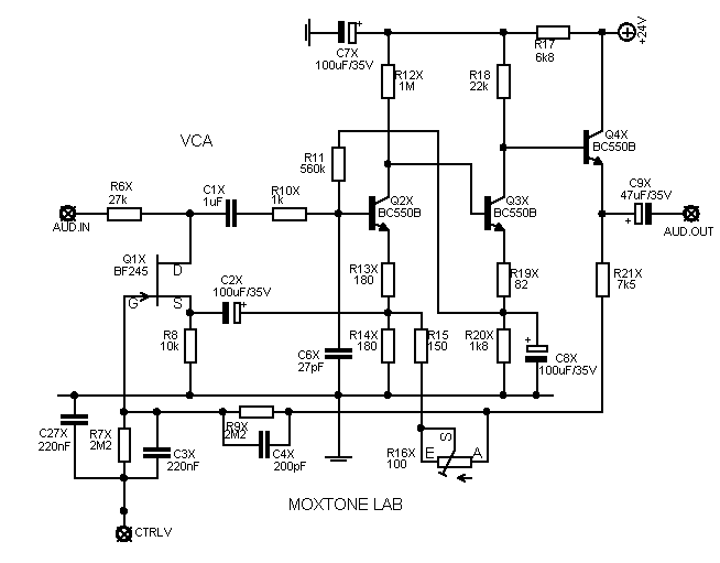

On mixing desks, we often use VCA. They're not the same thing. Attached picture is VCA create by one of our member.

MaxS said:Attached picture is VCA create by one of our member.
Khm, as much as I'm flattered by the attention my little picture is receiving here, the credit is due elsewhere I'm afraid. I did not design the VCA in question. It is part of the old and famous UREI 1176 fet-based compressor (cloned and heavily modded by yours truly). More importantly, the VCA is not suitable for wide-range volume control applications. For this purpose, THAT 218x ICs may be a better solution, which is also used by many professional console manufacturers.

Is your technique similar to Wayne’s? I rather doubt it for several reasons. You will need some kind of buffer between your two proposed ladders if they are both to operate at a virtual earth point. The Pass pre-amps have a single gain stage which would preclude this arrangement. I suppose this problem could be overcome by using a single ladder and extending the number of ‘switches’ to match the desired number of attenuation steps but that would require a significant amount of components! Anyone already tried this out?
The other reason I suspect your approach is not the one used in the Pass pre-amps, is that in order to stand any chance of obtaining a patent, a circuit needs to be both sufficiently novel and non-obvious. No offence, but I don’t think your approach meets these criteria although I am no expert.
Anyway, the approach doesn’t have to be the same as Wayne’s to be useful. Personally I am more interested in how to build an attenuator with similar benefits to those claimed by Wayne’s arrangement rather than necessarily coming up with something similar in execution. Always assuming that it is possible of course 🙂
Looks good and I see no reason why it shouldn’t work well. However, I’m curious as to why you have opted for a parallel arrangement for increasing attenuation values rather than individual, i.e. so that there is only one resistor to ground at any given setting. What do you see as the advantage? I suppose it may increase the headroom by reducing the signal level that the attenuator typically sees. Then again it will be more difficult to arrange for precise attenuation values due to resistor tolerances as the number of parallel resistors increases. There is also the potential issue of more base current flowing to earth at values of attenuation where several ‘switches’ are on, but I’m not sure whether this is of practical significance. Personally I’m more inclined to the topology suggested by both maik and Dave earlier in this thread (posts #58 and #59).nobody special said:Anyone figure this out? I think I might have... Nelson?
