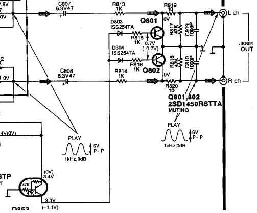

BTW switching to gnd using BJTs is a very popular technique in
commercial audio systems.
Uli

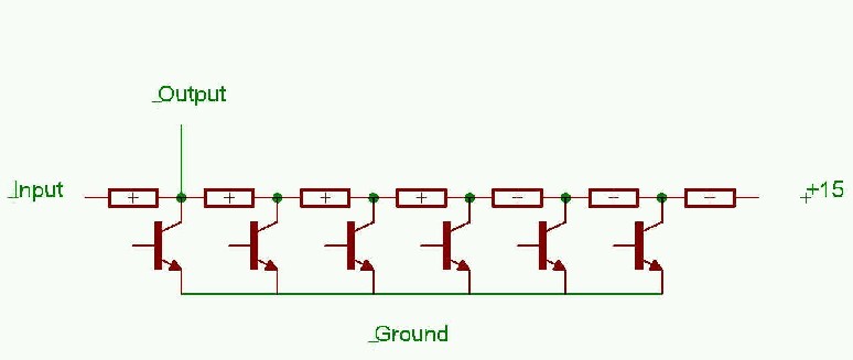

What about the following circuit. Think about R1 as a
large shunt resistor (let say 10k). The subsequent
resistors may define a divider ratio for input/output
as you like. The last resistor connects to a positive
supply. It can also be a current source. The control
logic must ensure, that at least one BJT is conducting.
It will create a voltage devider for the input signal
and it will be biased by the current defined by the
resistor network and the positive supply.

maik said:What about the following circuit. Think about R1 as a
just a thought-regarding symmetrical inputs-it's better to have attenuator arranged in shape of two series resistors and one shared shunt element(s);
positive and negative legs are virtual grounds ..I know that this is obvious (and really have no time to further investigate actual topic on the bench) ,but-just as agenda......
