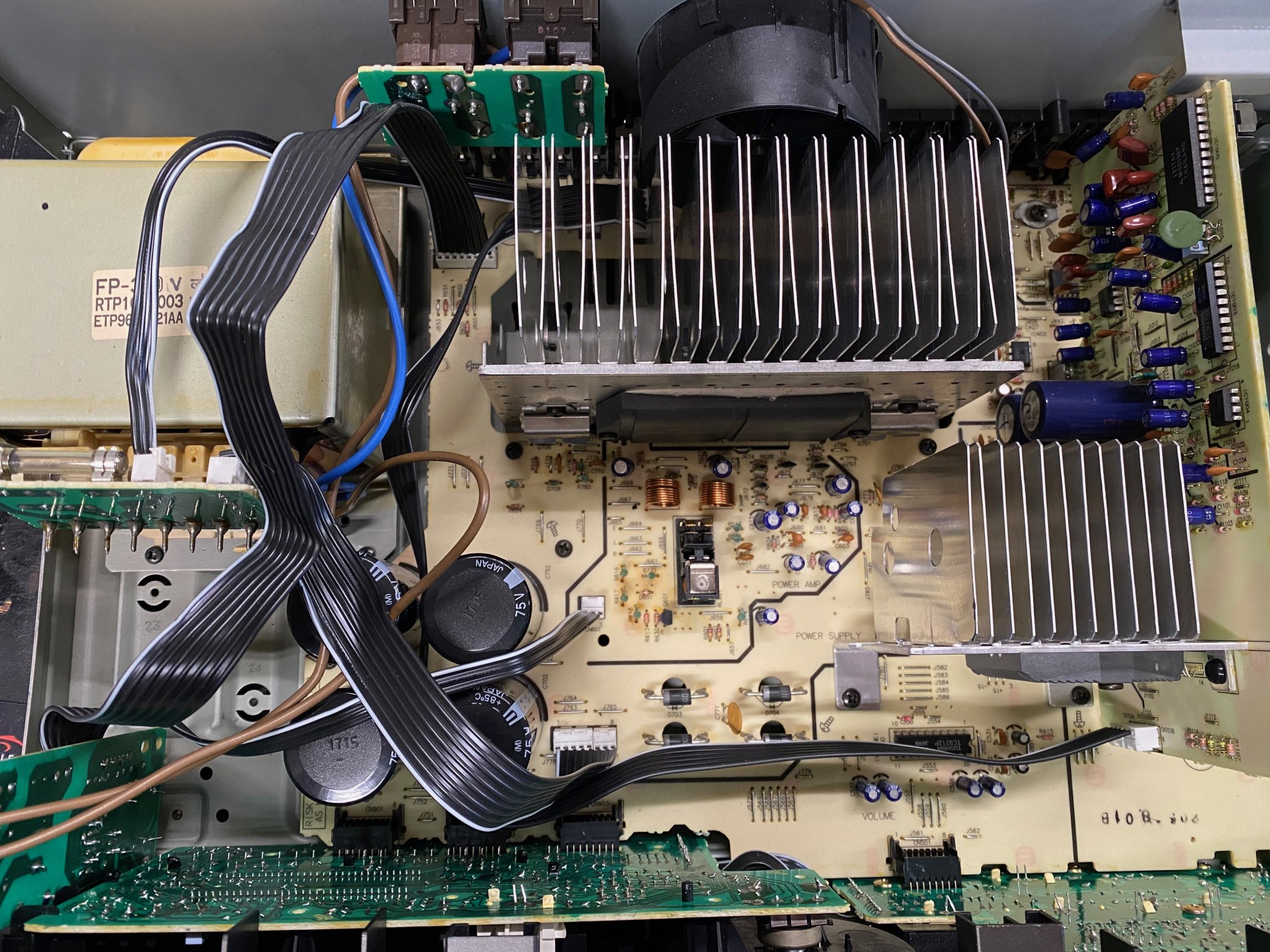

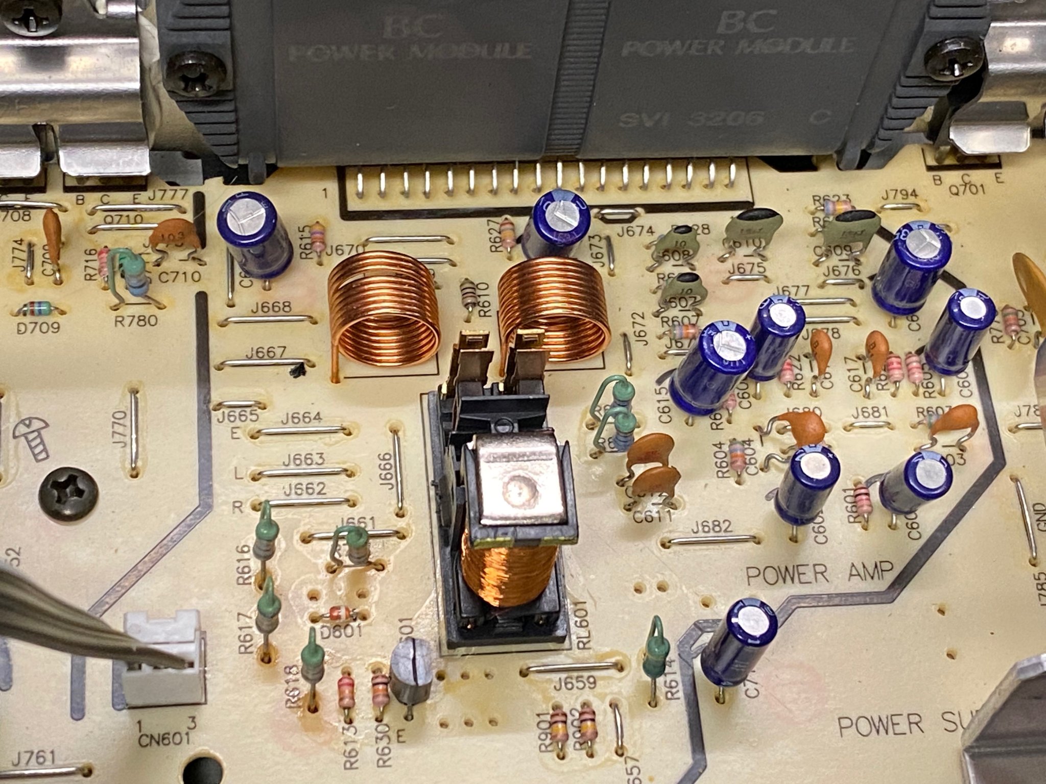

Hello, i am looking at a similar issue. Amp was working fine, then got some low volume, and noticed display had disappeared. Restart, no display, check all 3 board fuses good. My main board does not have the Q705, 706 as in the technics schematic. They are nowhere to be found on the main board. Could it be located on another board? I also don't see any hot spots, which areas on the main board produce the most heat. Thank you, Bj
@Bjjbj I don't have my unit here to look at it but I remember they were hiding under one of the heat sinks...I think the smaller one so you'll have to pull that off first. Also rather than removing the whole main circuit board for the repair, I just cut about a 1" hole in the bottom of the receiver sheetmetal with a Dremel so that it could be easily accessed.
Neil
Neil
Hobo, well i cut the hole, didn't see any cracks. I re touched the solder spots of Q705 and Q706, along with the small adjacent cap. Turned on, and nothing??? I flipped unit over, and tested Q705 at the pins, 12 volt at the center, and 6 volt on each end, hmmph. The when I went to flip it back over wa-la, the display was on, all the buttons worked, including the FET coupling light which never worked before. BTW, when i re-touched pins, the solder sucked down and left gaps, so adding solder seemed necessary. Stoked so far, off to test for sound, fingers crossed. bj
Semi good / bad news. Display was working, played for an hour, then display went out. Still had the music playing with working bass, treble, and balance controls. No volume, bass boost, lights, or input buttons worked. Re soldered all nearby to Q705, and display back on, but after an hour same exact issue. Tested Q705 and found 12 volts at center , but no volts on the outer pins. Could be q705 is failing when hot, or i have to remove bottom and do a complete solder check on the whole board. Suggestions? I can replace the transistors without removing the bottom. bj
Hello again! Sounds like progress. Did you check for continuity between the pins around q705 where there should be continuity? I remember I found there was no continuity between two pins where there should have been. Because reheating the joins didn't fix it I had to jumper a piece of wire between two pins...
Well after lots of testing and repairing a few traces, it worked again for about 10 minutes. Voltage from Q701 is 14+ volts, so voltage in to Q705 is the same. When the unit kicks out, I am seeing that the input voltage of Q705 is still 14, but the output voltages are gone, hence the no display power. So gonna say its the transistor on the blink. Ordering one up and we will see. Unless someone out there knows of a better replacement. bj
