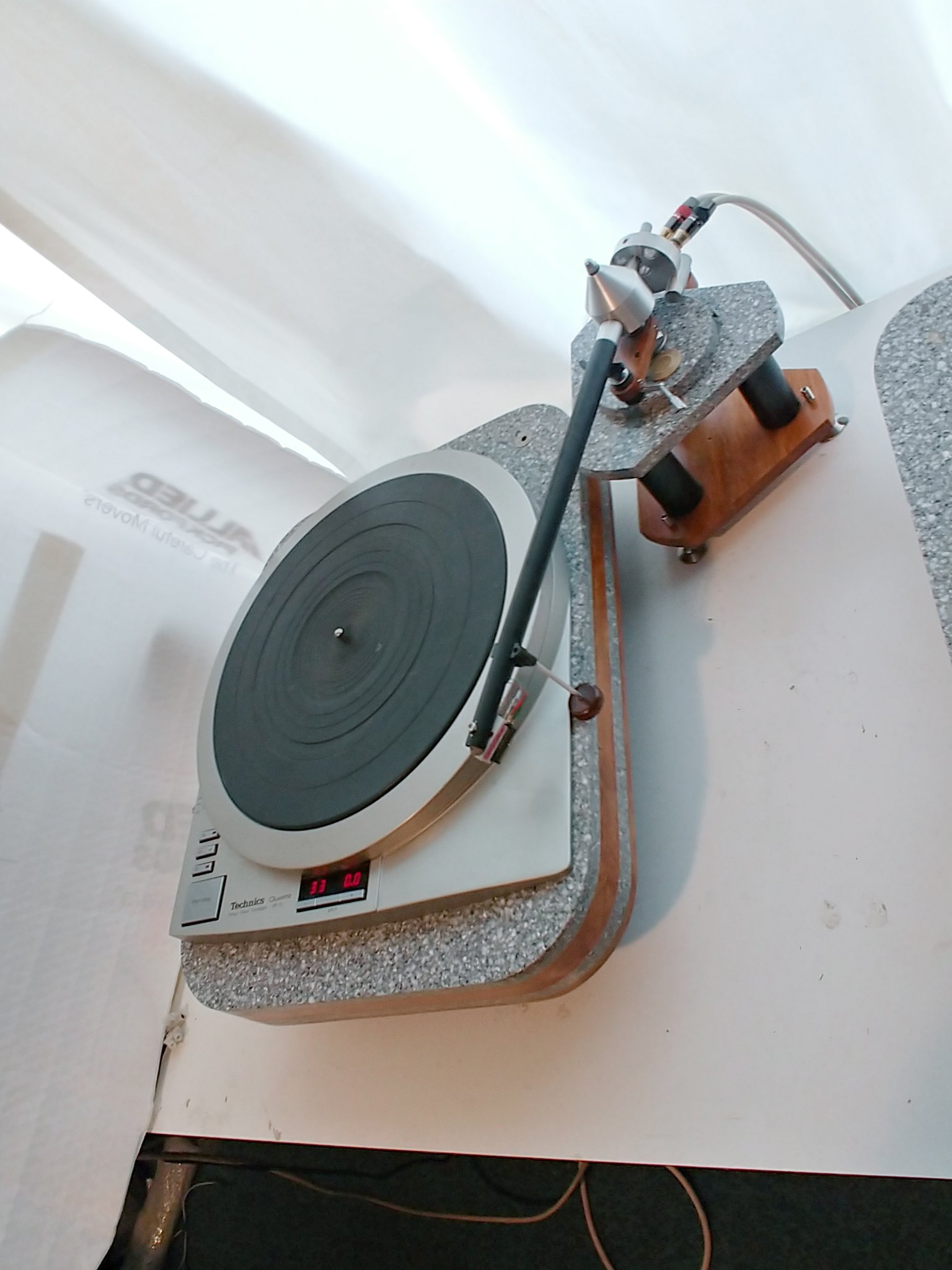

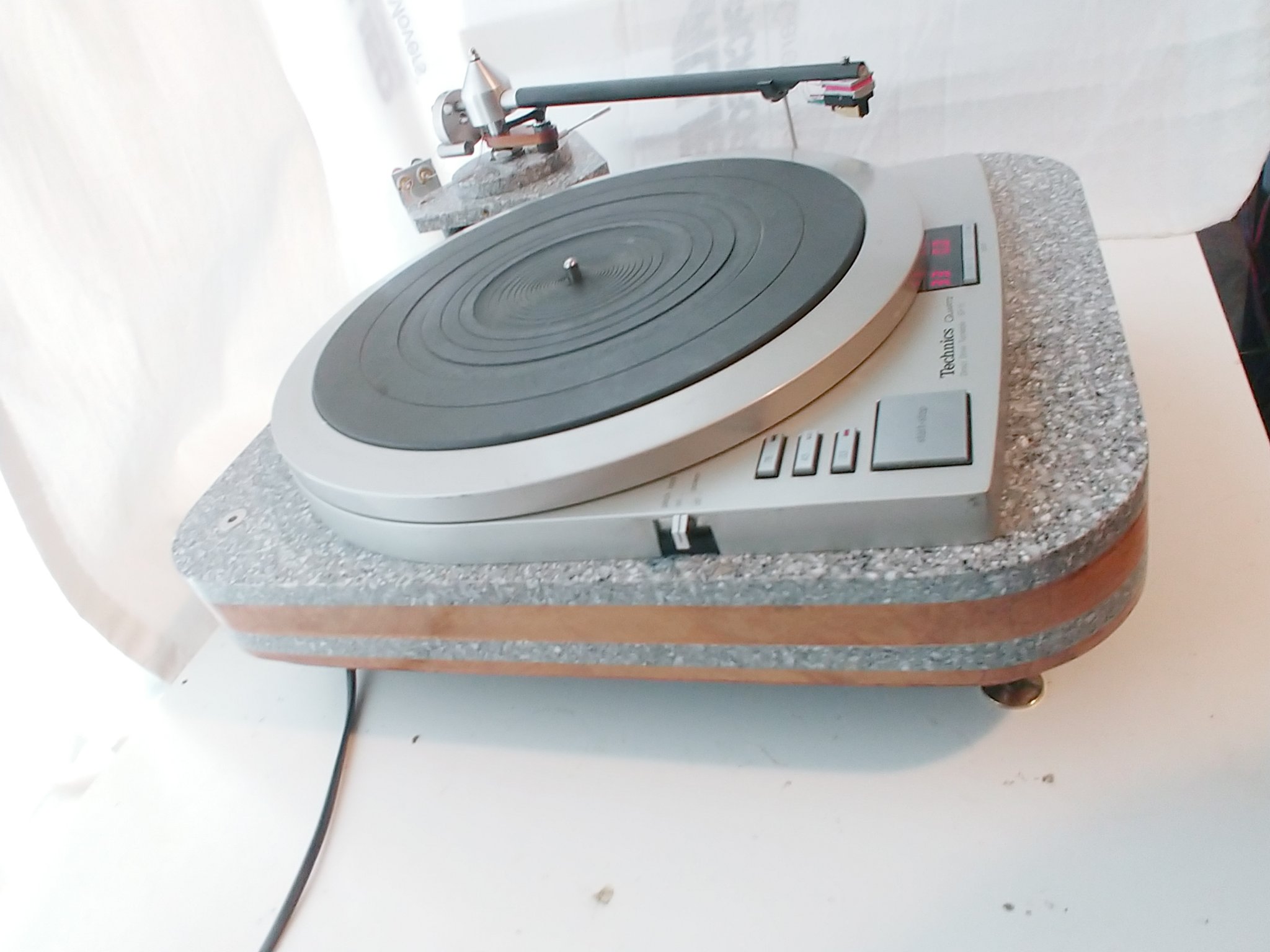

Below is my plinth design for an SP15, I got great results from using a local wood Rimu & the insert sink cut outs from a local kitchen top manufacturing company. And note I keep my 12'' arm away from the T/T on a separate pod
Cheers

Resin / bento makes a great plinth. I made mine smaller than most and I'm now looking at making a Permalli base for a no plinth build.
If down the track you end up building the R/B plinth you should seriously consider separating the motor from the electronics. The improvement is significant. The remote motor removes all of the bits in the SP10 chassis that can vibrate.
