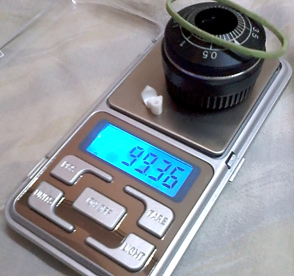

One more of my non-scientific crude torture test experiment. I replaced the stylus on my turntable with pointed plastic nail on clamp, tied with rubber band and counterweight on the headshell placed on not so good running record. The strobe was steady. Counterweight with rubber and dummy stylus was almost 100gms. Arguments about this being (1) constant fixed drag, (2) plastic stylus will have less friction and (3) How electronics handle the varying drag (if any) should be heartily contemplated. But at 60 times normal tracking force the turntable did very well.
Video : Drag Test
