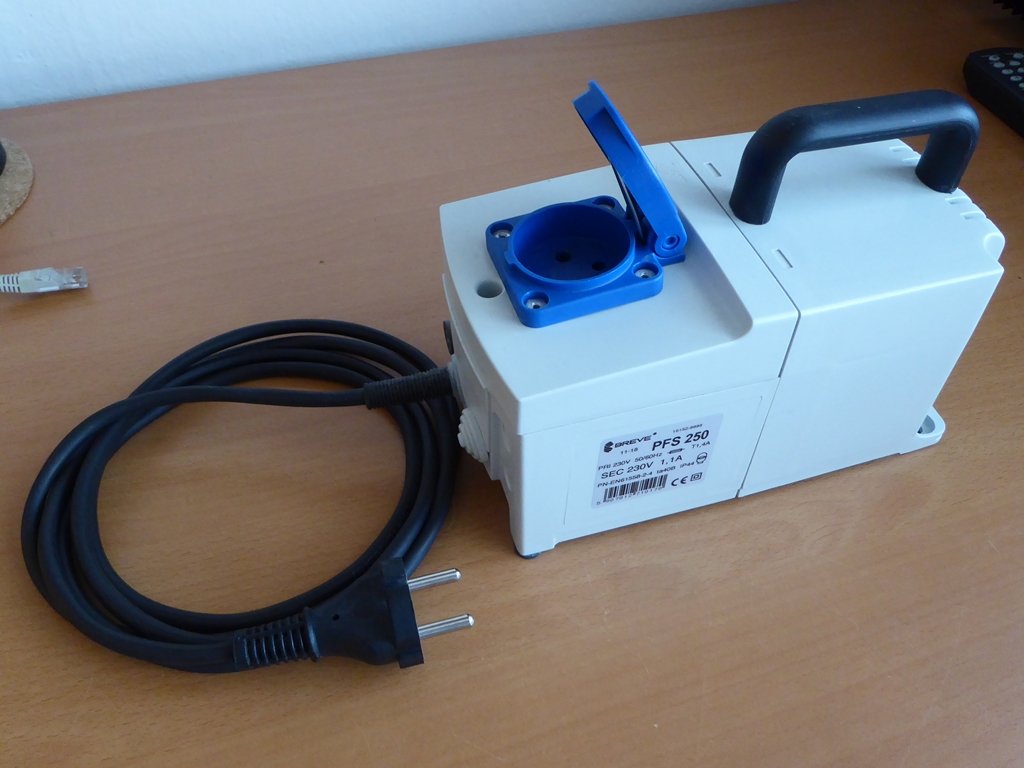

Here (EU standards) we have both possibilities. I showed
the case of double insulated isolation transformer. There is no PE and you may connect only one instrument to its secondary outlet. The standard can be seen in the photo.
