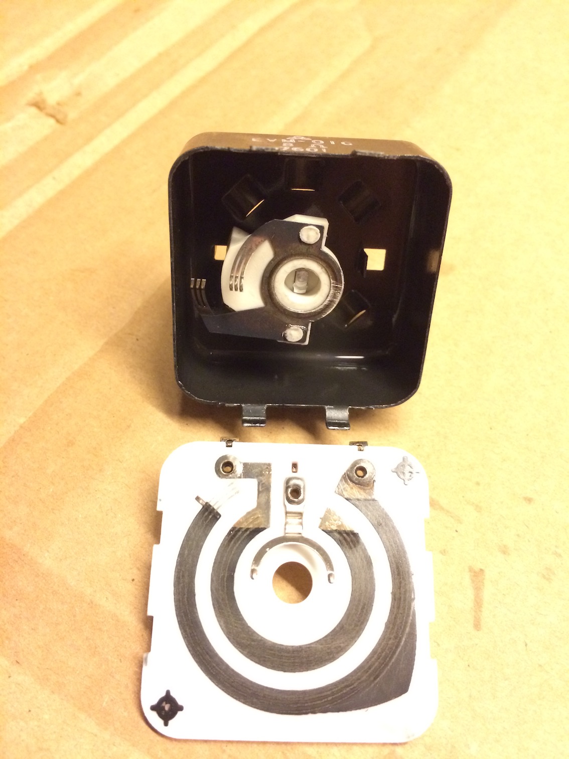

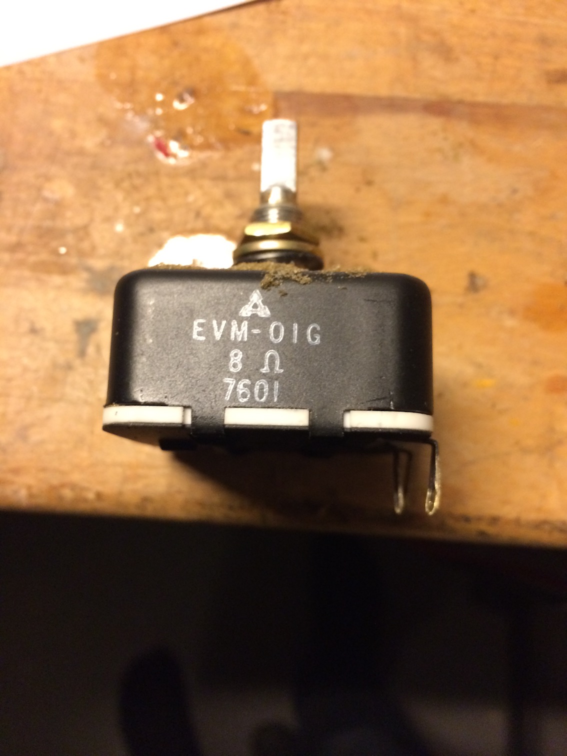

VR1 measurement.
Speaker 1
9 12 15
2-3 14 8.4 3.3
1-2 600K 640K 510K
Speaker 2
2-3 6.6 5.1 2.1
1-2 850K 1.3M 1.6M
Now this can't be good.

That is a weak link maybe... I heard another person mention theirs had breaks and cut out.
My variables weren't that great either. One would cut out when you'd dial the tweeter back about 1/6 way, but left both set to wide open usually, so it wasn't an issue for me at the time. I never measured them through the rotation at spots, except to ensure both were same at that max setting.
Are you modifying the crossover or is this an extra protection that is in the manual?
The principle of the VR1 seems alright, it reduces the series resistance as it gets turned to the right. The exact position for both of the speakers with equal amount of padding should probably be set by measuring spl.
Disassembled the potentiometers, no rivets just un-bending four flaps. After some cleaning the resistance from 2-3 ranges from 7.7 to 0 on the first and 15 to 0 ohms on the on the second potentiometer. Guess I could mount a 18 ohm resistor in parallel with 2-3 on the "bad" potentiometer.
The potentiometers is quite an open construction. Foam mounted on top of the housing had dried out. Resulting in particles of foam on the resistor strips.
