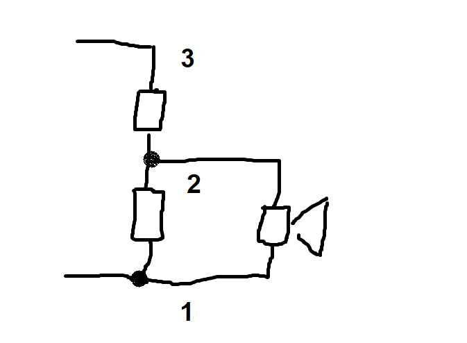

Than you both very much, I noticed the value of one side of the L-pad increasing as the other decreased generally.

"You now have the two series resistor values needed to replace each pot with fixed values"
Not 100% on what you saying here Mooly 😕 do I just need one resistor in parallel with the speaker the same value as across 1 and 3
or do I need one in series and one in parallel as the L-pad calculator depicts. Noting there is already
resistors in series in both circuits.

So I think I have got it now🙂 I just need to put resistors, close to the normal values
across 3 to 1 ie in parallel with the speaker?
Am I on the right path now gentlemen?
The speaker should go to the junction of two series resistors, the value of the 'top' resistor being the value you measure between points 2 and 3, and the value of the bottom resistor the value you measure between points 2 and 1.

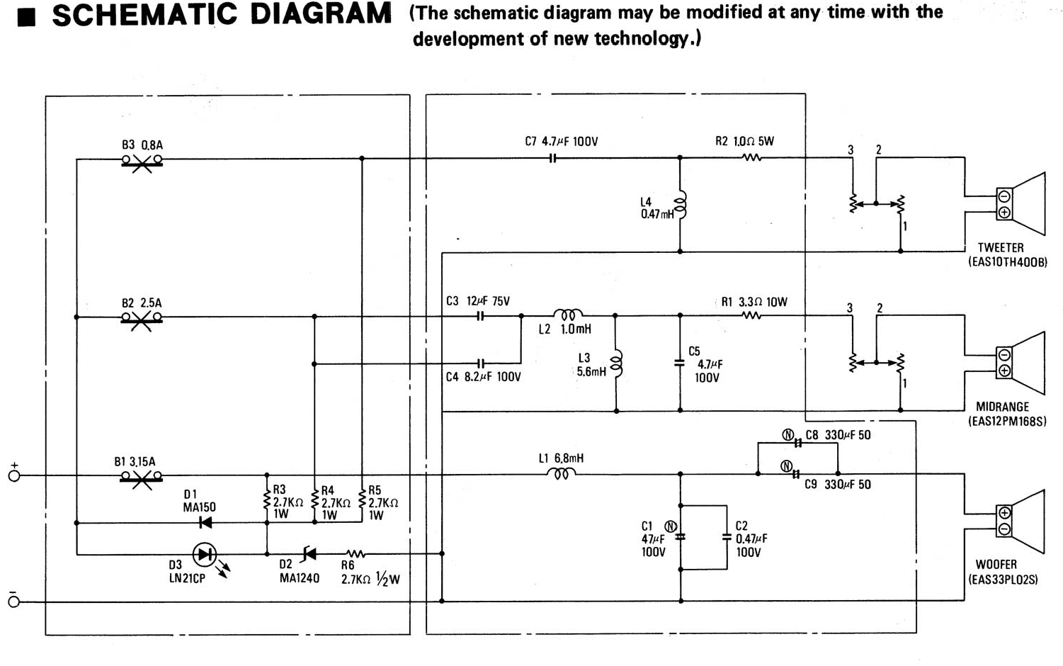

Thinking I need to sort the amp out first, been studying the schematic :boggled:

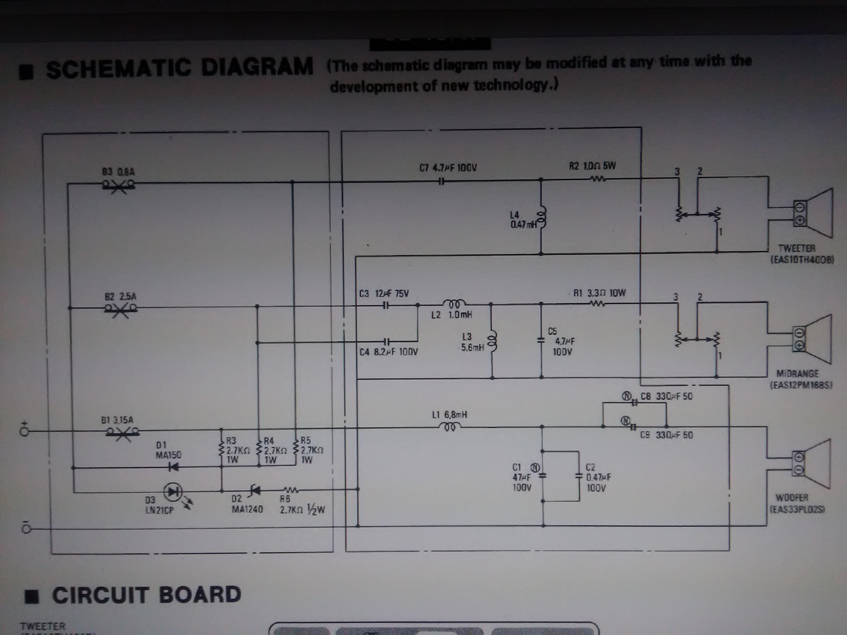

The LED on the speaker appears to be a simple indicator with a discrete AND gate logic arrangement, although part of it doesn't look right tbh.
The three drivers are fused, so all good there.
The output side of each fuse goes via a 2k7 into the LED. There is a reverse biased diode for polarity protection for the LED and also a zener and resistor for overvolts.

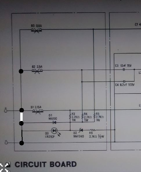

The rest of the connections don't make sense tbh. Is it like this ?

Well that LED shown on the speaker crossover simply responds to the voltage applied to the input.
Now this will be an old LED and as such far less efficient than modern examples. Lets say it needs 3 milliamps to be bright and that it drops say 2 volts. That means we need to see 3ma in the series resistors, and which are effectively all in parallel giving the equivalent of 900 ohms.
So we need 4.7 volts applied to the input to do that, and that voltage can be DC or peak value AC to light the LED. 4.7 volts peak is just the equivalent of 1.3 watts RMS into 8 ohms.
So the LED will light at relatively small input voltages.

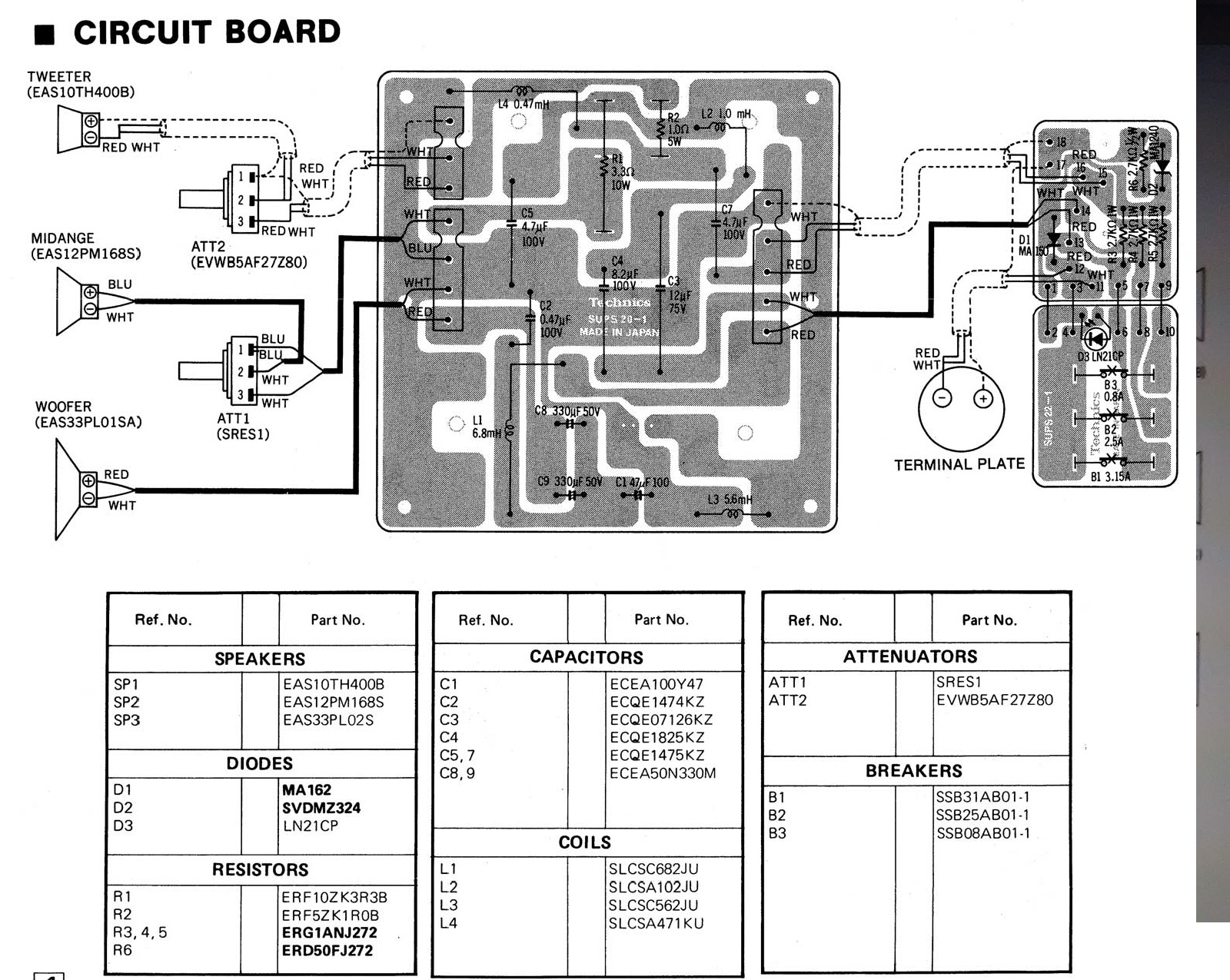

The board layout shows something different again... which is that there is a missing connection on the circuit diagram but and so the LED is effectively across the incoming audio feed but now with a series zener and resistor. So the LED will not light until the zener voltage PLUS the LED voltage is exceeded.
The three 2k7 resistors modify that behaviour in the event of a fuse/trip opening.

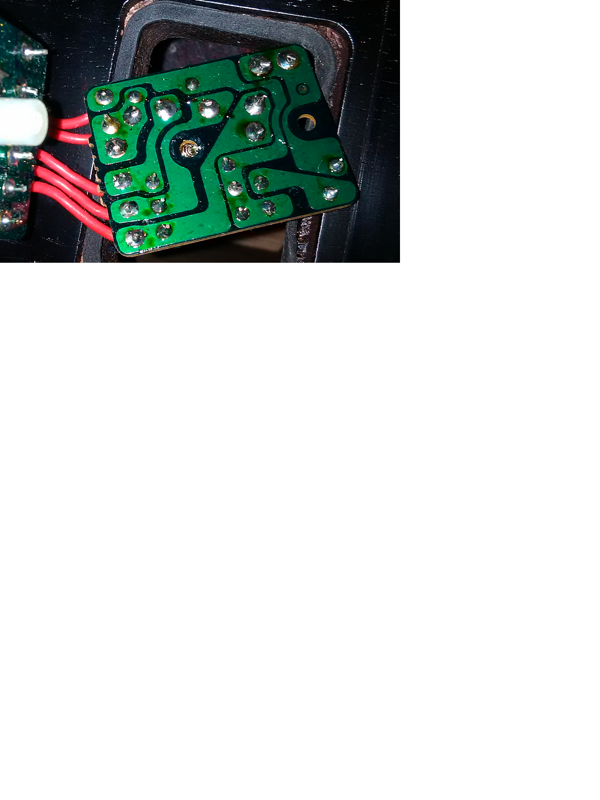

Good morning 🙂 I took some photos of the overload board. I afraid I had to use my phone, the computer doesn`t want to talk to the camera since the last windows update 🙁
I wonder how good the contacts are in those overload breakers ? These days I think it would be pretty much unheard of to add something like that to a 'hifi' design.
I am wondering whether they would be better either linked out, or if you still want protection then replaced with solderable fuses such as 'Wickmans'.

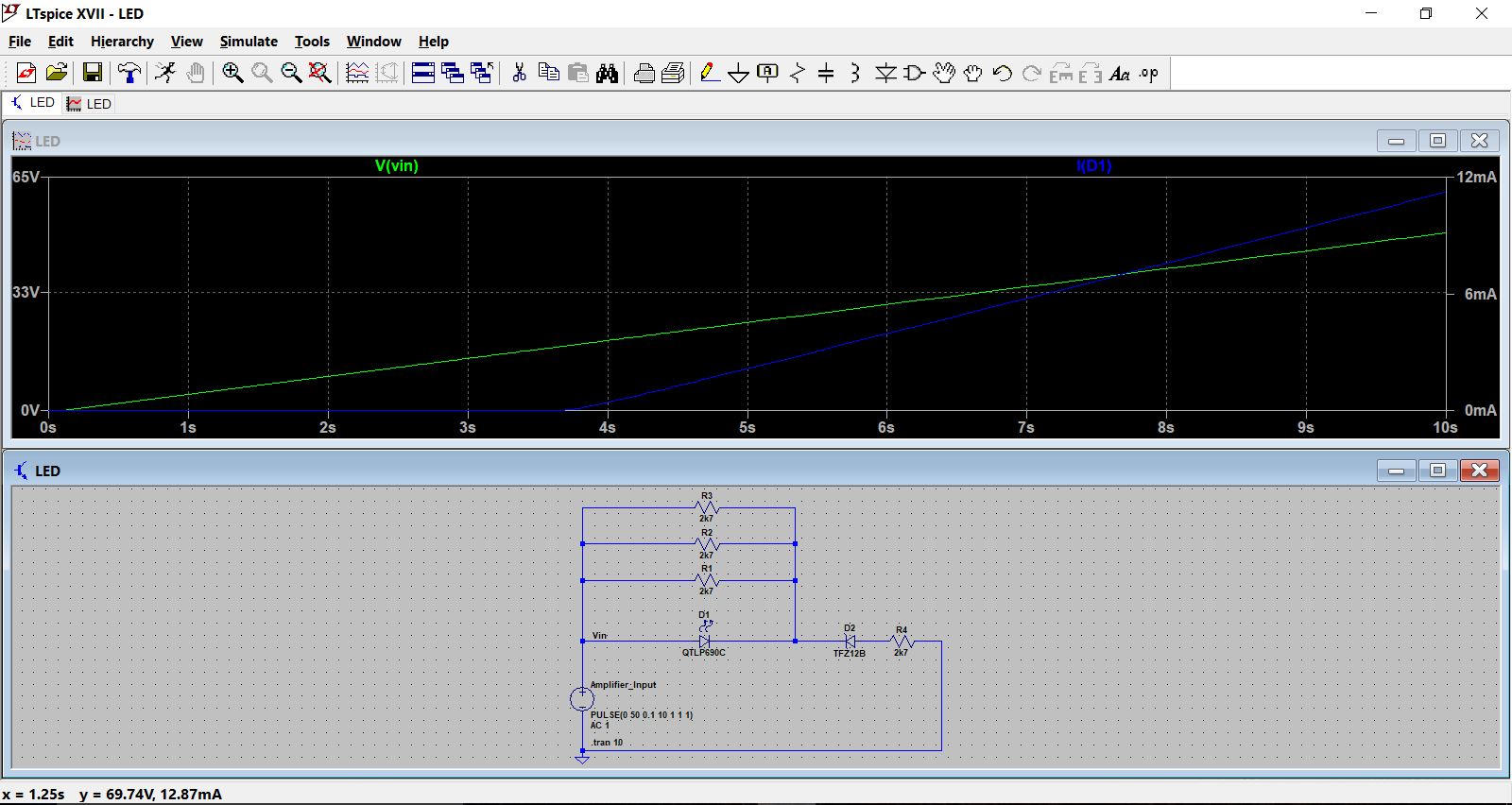

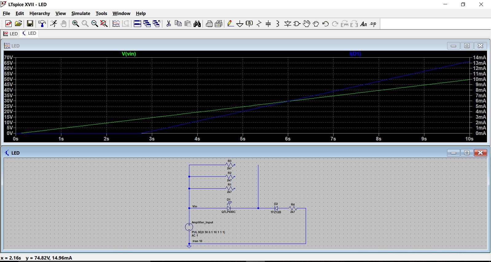

Flashing lights were all part and parcel of equipment of that era. I'll recalculate the voltage the LED will light at later based on how we now know the circuit to be. Those 2k7 are in parallel with the LED, but if a trip operates then the LED will light earlier (as in needing less input voltage).
Here you go. A quick simulation shows graphically how it works. The input voltage is rising with time (this is a DC voltage) and the LED begins to conduct at around 18 volts.
If we trip all three breakers then it conducts at around 13 volts.
Voltage is on the left and current on the right.
So for an AC music signal the conduction points represent the peak of the AC voltage and you have to remember that a quick transient will not be very visible.
18 volts peak would be 20 watts equivalent into 8 ohms.
