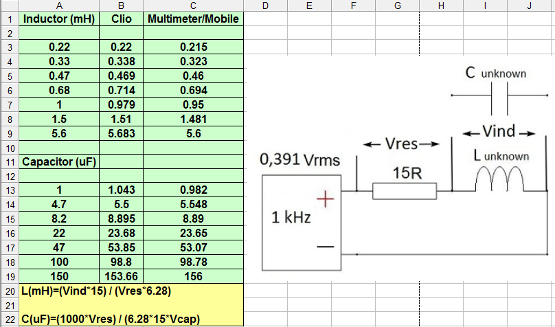

Would be interesting to see you measure capacitance of your original caps to see how much they have deteriorated already. Without a C meter and not wanting to deal with software+sound card setup, the easiest way to evaluate could be to use a smart phone as a source (amp) of a 1 kHz sine (mp3) and measure voltage drops.
