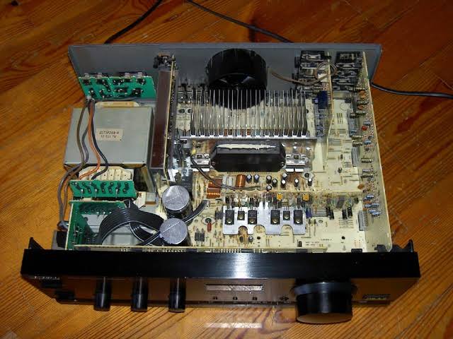

On the heatsink near power ic there are transistors on the heatsink - see example in pic - clamped each side of power ic
Have had receivers of that era go into overload due to -15v rail not there
You were bang on there. One of those transistors had all 3 pins cracked and the other had 1 pin cracked. Made all of those solid and went around the board at anything that looked like it had a thin dark crescent around the pin (thinking it may be a potential hairline crack. I would say that all of the solder point on the bottom of the main board are solid now.
There were definitely some thin solder points - maybe contact was still good but the slightest touch with the iron and the solder disappeared.
