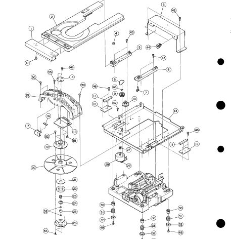

First off do the basics, clean the laser with a cotton bud "dampened" in a weak 50%-50%watered down solution of alcohol and clean water, do not push down hard on the lens as it is on a suspension.
Then do a clean of the chrome rails that the laser slides on, slide the laser to each end to clean all the rails, use again a cotton bud with straight alcohol and do the under side of the rails by bending the cotton bud 90` and the end.
Then when the rails are clean one drop of light oil on each rail sewing machine oil or watch repairers oil slide the laser up and down to distribute the oil on it.
Hopefully this will cure your problem.
Cheers George

Before spending money on hard to get parts, do the cleaning/lube as I outlined above, out of the half dozen that I have serviced this has fixed at least half of them, the spindle motor I have never replaced and is a beefier a/c brushless motor completly different unit than is in the VRDS-T1, a dc unit which gave it and the spinle motor a bad reputation.
Cheers George

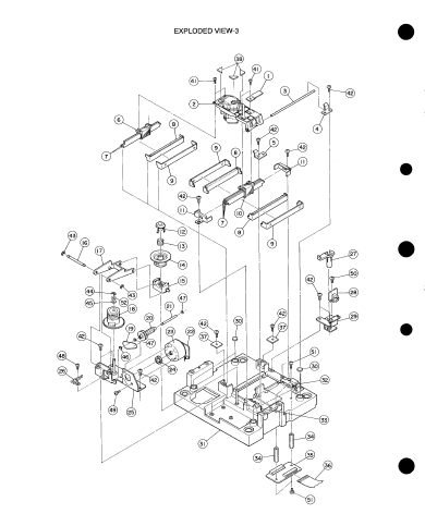

As for the loading belts #19&8 in the first drawing, if they are stretched I have cleaned these and the pullies with alcohol then boiled the belt in water for 10mins and then put in ice water, this fixed a streched belt for me on other machines, this VRDS10 does not seem to suffer from they are very small belts in circumerance.
Cheers George
