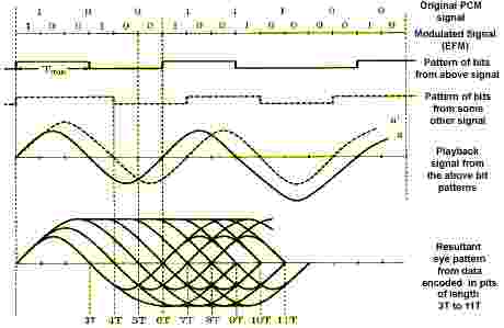

Hi
I do not have schematics, but if someone can indicate where to measure the RF signal, then you are sure abouit changing pickup or not.
All the other stuff is guesswork and will cost money and yield nothing......
In the VRDS10 the RF can be measured at connector TP1, pin 5 (signal) and 6 (ground). It looks similar to the lower trace on the attached picture.

Hi
