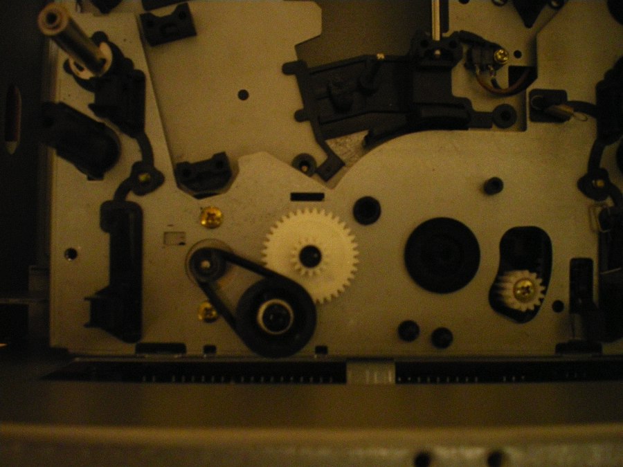

I forgot to take pics of the strip down... this is after the gear has been replaced.

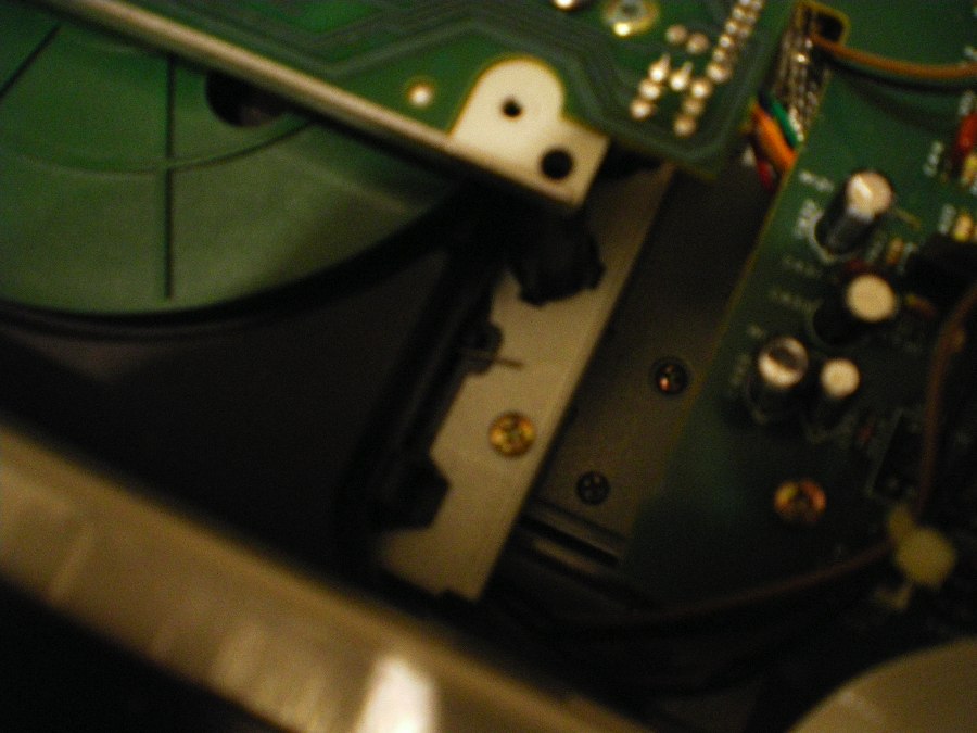

I can't exactly remember the significance of this one - but I recall the wire near the gold screw needed to be unclipped to release the mechanism. Maybe someone who has done this more recently/often can expand?

My strategy was to leave as much as possible in place. I wouldn't recommend trying to remove the whole mechanism.

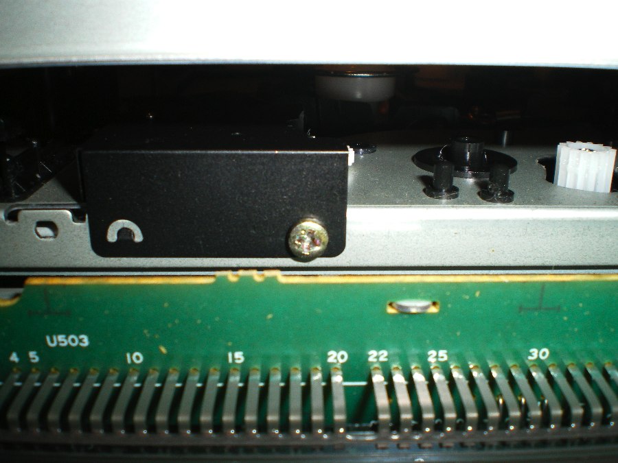

from memory, it was a matter of removing the bridge which takes with it the VRDS disc. I didn't disconnect the motor wiring, just moved to one side. There are clips on both sides, the wire clip in the pic, and another clip on the other side release the draw. Once you get that out, you should have access to the gear mechanisms. I had to pull the front panel to access the retain screw for the bracket above the gears.
I only replaced the gear, mainly because of difficulties obtaining parts from the UK. I checked the rubber belt when I stripped my T1 down and it seemed to be in fairly good condition.

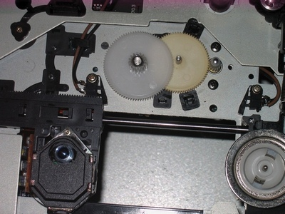

I have a similar problem with my VRDS T1. The gear between the motor and the gear that drive the lasersledge is broken. That is the slightly yellow one at the picture. Anyone who knows what this gear is called as a sparepart, and where i can get a new one?

My T1 has been quite noisy when loading for the past couple of weeks, then yesterday started randomly skipping, and occasionally muting completely for 10-20 seconds. A pull apart revealed that "Gear B" had lost a few teeth, so it's back to the trawl for spare gears.
