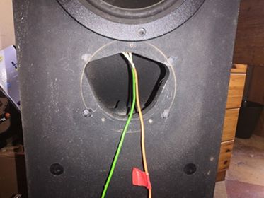

For information the size of the holes is :
Woofer : seems to be 14.8 cm
Tweeter : at the extremities (as it's not round) 9 x 7.5 cm
I only have a basic school ruler to measure with so there might be a 1-2 mm difference, not more. Does this matter?

The Monacor woofer should be OK but the tweeter opening has an odd shape.
Whatever tweeter you end up has to fit within it and has to cover it.
Send Neil that picture you have of the tweeter opening.

Yes! It is an unusual shape. I think, from what I can see of the screw holes, that the original surround for the tweeter was oblong.
Just to sketch out some thoughts on the tweeter:
This picture looks like the bass is unscrewed and sitting low, but these two Monacor tweeters are contenders to replace if necessary:
Monacor DT-100 Size 116x80mm
Monacor DT-250 Size 116x86mm
The second one looks loud at 92dB, and might need crossover modifications. But the bass is the main issue right now.

I think the Monacor DT100 looks a very reasonable choice:

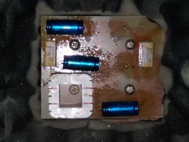

Should be OK on a first order capacitor filter. It would help to know the values here on what looks like a biwire crossover. I think we have decided it's coil and cap bass with RC impedance correction. Resistor and capacitor to tweeter.

Wilmslow's data suggest to me DT100 1.5KHz resonance, minimum crossover frequency 2.5KHz and ferrofluid damping. The DT250 specification is 1.75KHz and crossover frequency 3KHz with no ferrofluid. What was the resonance frequency of the original driver?
Interestingly checking the manufacturers website DT-250 didn't get me to a data page, so it looks like it is end of life as a product. Although there will be many sitting around on shelves in speaker shops.
I do take your point about first order crossovers and tweeters, and at least a second or third order acoustic roll in is often a better and safer choice for myriad reasons.
Agree that if the Wilmslow crossover is 2nd order there will be a bigger safety margin on not blowing the tweeter at parties. Always be careful with the volume control, if it sounds bad time to back the volume off.
