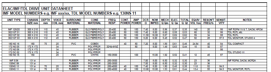

This is not the first time that someone has rocked up here with some broken TDL speakers.
We've looked into those old Elac drivers before:
Plastic Polycones, which tend to low breakup around 5kHz. Various models over the years. Interestingly, high Qts in transmission line.
Vikash has delved deeply into his MTM version, the TDL RTL3:
Creating a new MTM Floorstanding speaker using the drivers from the TDL RTL3.
Even measured the raw drivers.

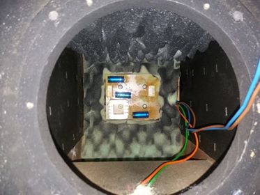

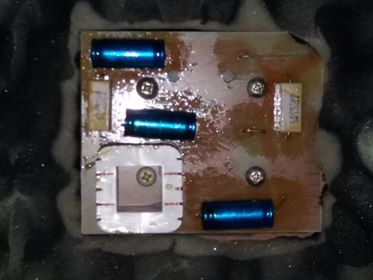

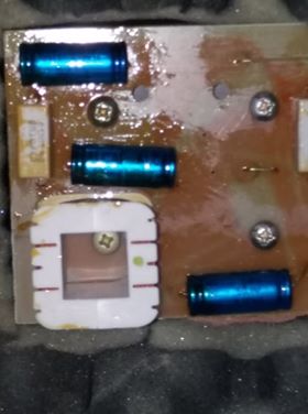

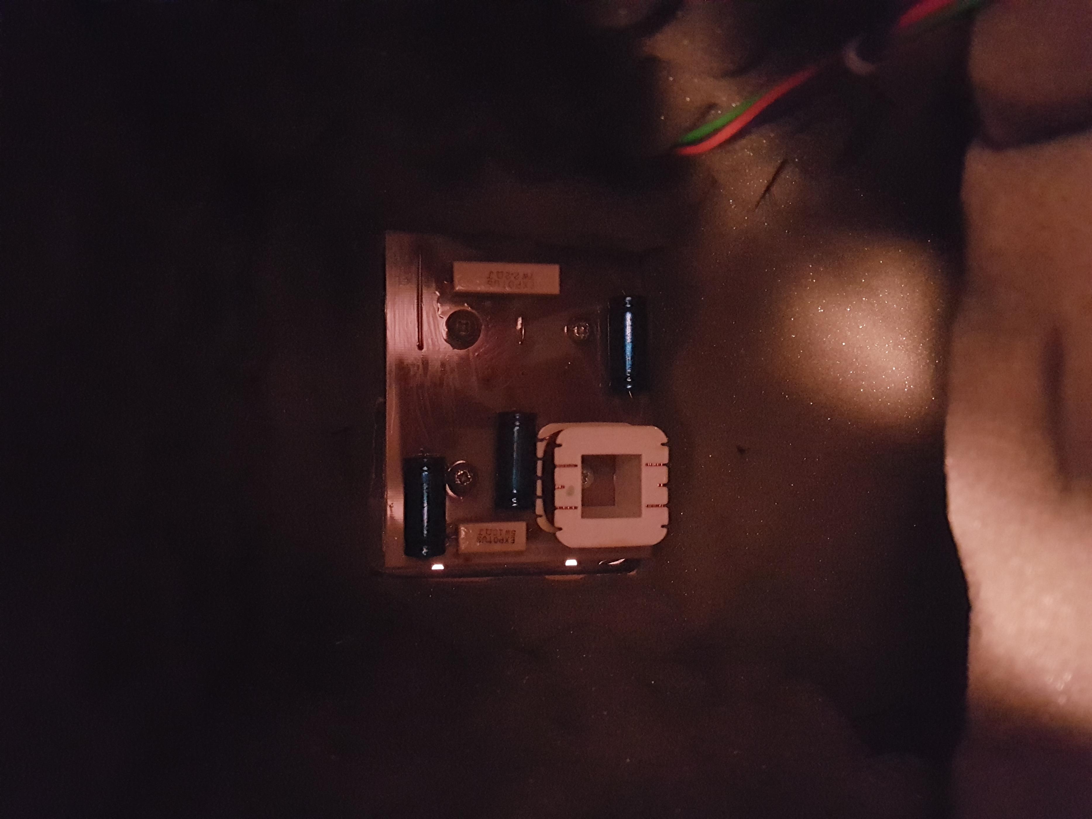

Sally, can you take a picture of the XO, any elco caps could well have dried out. They are certainly old enuff.
Pictures of your drivers would also help.

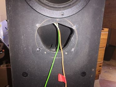

OK, I've found someone who can come here and do the repairs once the confinement is lifted. I'll send pics and measurements today then we can see what I'd need to order, then get advice from everybody on how to go about it concerning the crossover in particular (and maybe the foam inside the cabinets?)
The dimension of the woofer hole seems to be 14.7/8 cm
Replacement woofer : DYNAUDIO 17WLQ 8 ohms N° 84875, L1 13
The tweeter hole isn't round (see photo) it's measirement at the widest point is 8.9 cm
Replacement tweeter : Vifa XT255C-30 4 ohms

planet10 : Is the XO the thing I can see at the back of the speaker when I take out the driver?

XOs are often mounted on the back wall of the speaker, often with the termnal cup attached. It is usually composed of caps, inductors (coils of wire) and resisters (often small white bricks). With wires coming out to attach to the drivers.

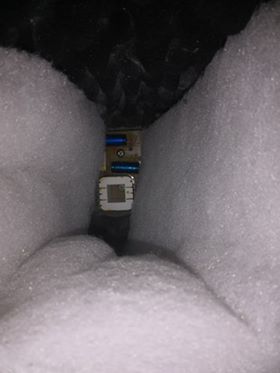

Thanks planet10 and cm6, I'll try to get my phone in there tomorrow and take a picture, I think I'll have to take the foam out. I imagine I can't just grab the XO and pull ? 🙂
TDLs usually had it at the inside of the terminal panel at the back.
True but I think it has to be removed as a unit from the rear.
