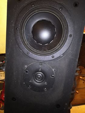

Thank-you system7, I'll have a think on that - I'm just worried that I might make a hash of installing the replacement drivers - not being very good at intricate, manual work. In my Studio 1s at the moment the trebles are OK but have become a somewhat tinny and less precise, the bass "thump" has disappeared (as though the very low frequencies are simply absent) and the mids sound brassy like they're going through a grinder - harsh and upleasant with the sounds all mixed together like mashed potato! The overall sound has lost its warm, round, "comfortable" aspect. Before it sounded like the sound simply flowed out of the speakers to fill the room with a very broad "soundscape" (not directional) but now it seems to be pumped out aggressively.

Thanks Jensen. It's a bit complicated here because I live in France and transmission-line speakers aren't very well known either by constructors or repairers. I did have them repaired professionally once (by a guy called Pascal Louvet who makes high-end speakers and does repairs too) but the sound was a long way from being like it was before... :-(
I forgot to say, the rubber surrounds of the woofers are completely shot
Now you tell us! Of course it sounds rubbish. Everything rubbing and distorting. 😀

Hopefully I've attached a photo here - I can't see it though!

Alors! Pascal has been very creative there!
That is nothing like the original. 😕
Looks like a Dynaudio bass and a Vifa XT25 tweeter!
I wonder if he modified the crossover too?
This could get deep.
But replacing the bass looks like the main event. Maybe we could find an Audax unit.
Question of what fits, really.
This looks doable to me.
attachment.php
Clearly this is the square frame bass model originally. And the 13x8mm metal tweeter.
The good news is it isn't rebated (which means the baffle is flat), so almost anything will fit.
You need to unscrew the drivers and measure the hole cutouts in the baffle.
It's not hard to file them bigger if the new drivers need a bigger cutout.

Photos of the Studio 1 show a rectangular ELAC faceplate hard dome tweeter common on many TDL models. These did use ferrofluid and it will be long dried up. The Falcon replacement is likely to work, the original was not the strong point of the design.
Bonjour Sally,
your "repaired" Loudspeakers have sadly not very much to do with the original TDL Studio 1 anymore (TDL Studio 1 loudspeaker Measurements | Stereophile.com).
Before you start off into new design adventures with whatever drivers - which will require a new crossover and probably other changes - you might consider buying another Studio 1, if you liked the sound (TDL Elektronik Studio 1-Excellent "Ubertragungsleitung" HiFi Lautsprecher | eBay). This might sound more expensive first, but as the original drivers are hardly available anymore, it could be your safest way to get the "old" sound back. All else is a new loudspeaker - you simply can´t use whatever is available as drivers and hope that it sounds good.
