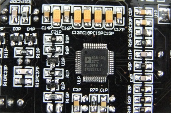

MINI8950 BOARD upgrade!
MINI8950 module upgrade, self boot half bridge resonant SMPS power supply,excellent power level SMPS OCP function,works stable, Main parts SMD soldering. better route good sound,Higher S/N.
Cooling output inductor applicated,50 celsius degree idle work.
Dimensions like icepower 125asx2,heatsink better.
POWER OUT:
1×300W/ 8Ω / 10%THD+N / BTL MODE
2×150W/ 4Ω /10%THD+N/2SE MODE
FREQUENCY RESPONSE: THD+N ≤0.05% / 20-40KHz / 1dB/FULL LOAD
INPUT SENSITIVITY: 0dB(differencial/2SE mode )
POWER SUPPLY: 110VAC OR 220VAC 50 OR 60Hz
AUXILIARY POWER: +/- 16V/1A
DIMENSIONS: 160MM(length)*80mm(width)*36mm(height)
WEIGHT: 0.35Kg

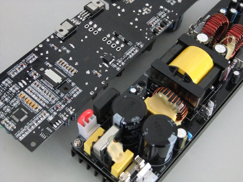

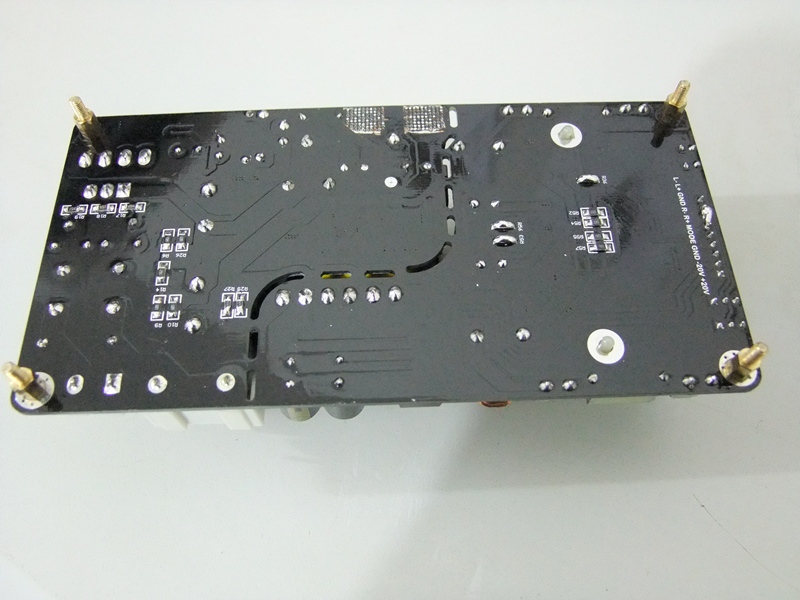

about our mini8950 module, we found some problems from our customers reply, TDA8950 chip burnt when tempreture increase and over current occur in this time, we have burnt lots of chip in testing and repairing,we have got lots of real data of it.
We develop new module of this series chip ,testing now.tda8920cth version(named T2100) have pass test below.
1. full load shorted protect passed,
2. no load full signal out direct shorted protect passed, full signal cap shorted output and inductor shorted output passed.
3.tempreture increase over current protect passed.
4.48hours half load burning passed.
5.pulse signal test passed.
6.square wave test passed.
TDA8950th (named T2150)test going now,
about input pin, IN1M and IN2P connect to signal gnd through one cap + one resister in this series.
We have developed one new series integrated DSP with tda class D chip(T2100D/T2150D), because we found no analog limiter performance better than dsp limiter,it can be works well with larger dynamic range, some of our customer assemble it in live show system, mic and cd signal mixed, amp burnt or tweeter burnt in worst case, but when add DSP unit, it same all fine.
our experiences: good routing and perfect parts value are very important in class D amp, not easy to make single chip larger power level class d amp works stable.
Spent lots of time and money in these series chip,because only this chip have syemmtric dc power supply and can be bridged easily. other single dc power supply chip can be Pbtl , but not easy and protect function not good when shorted out in some case.
about our mini8950 module, we found some problems from our customers reply, TDA8950 chip burnt when tempreture increase and over current occur, we have burnt over one hunderd chip in testing and repairing,we have got lots of real data of it.

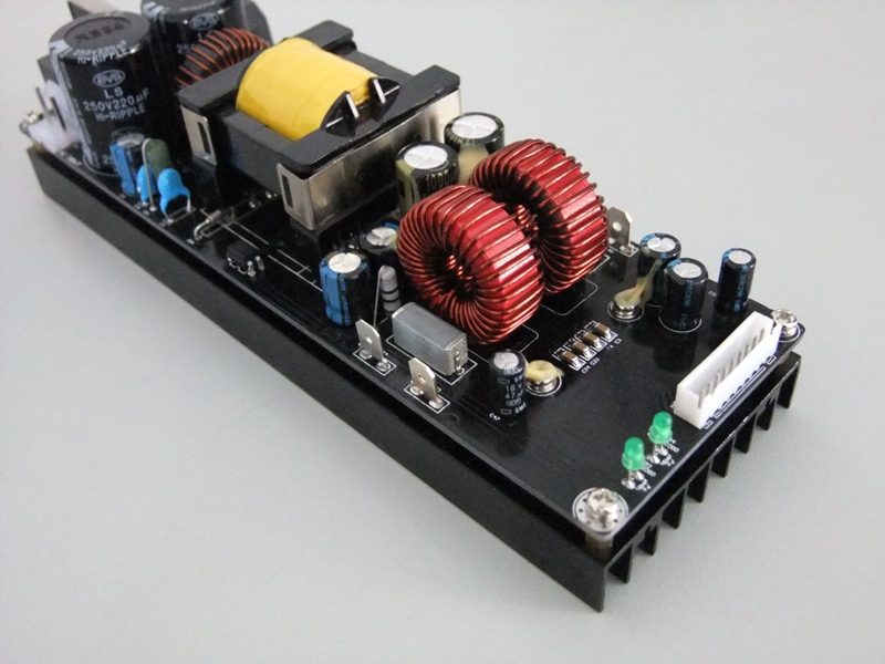

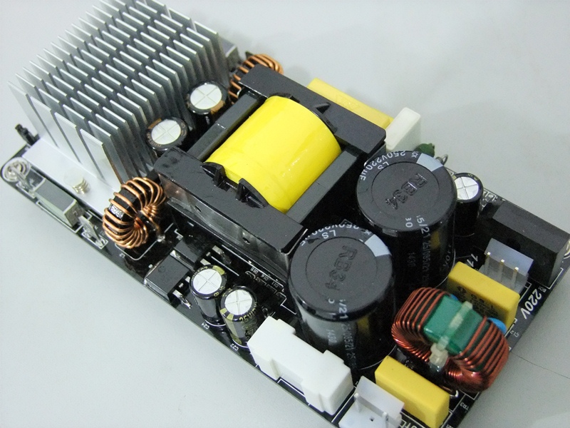

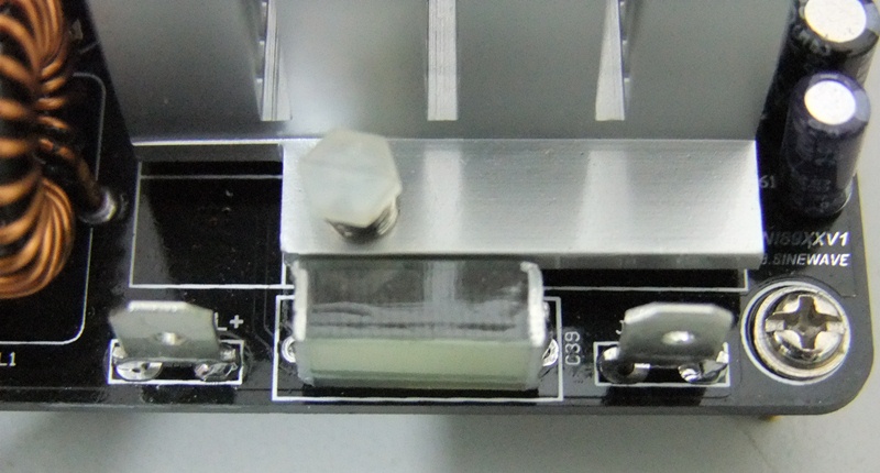

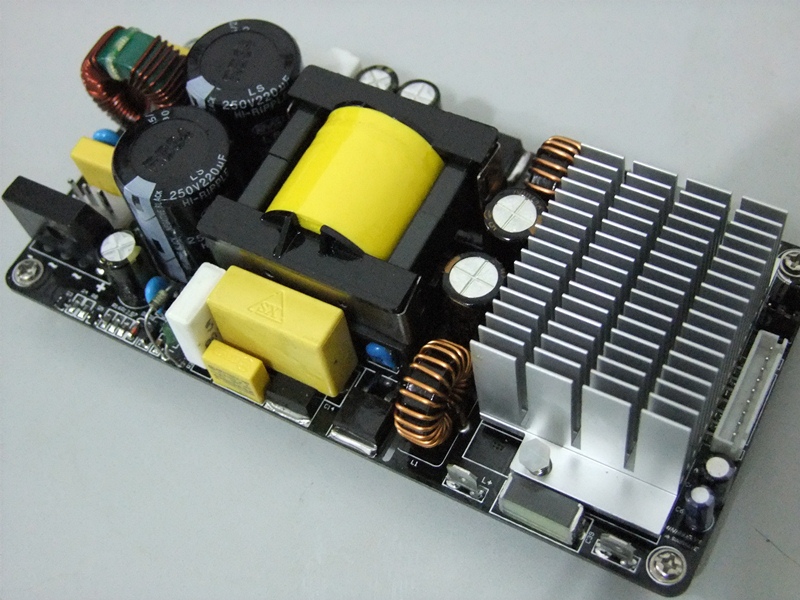

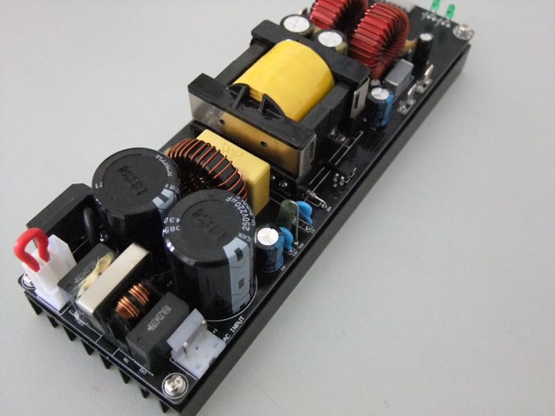

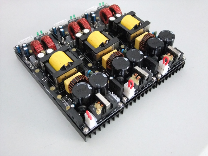

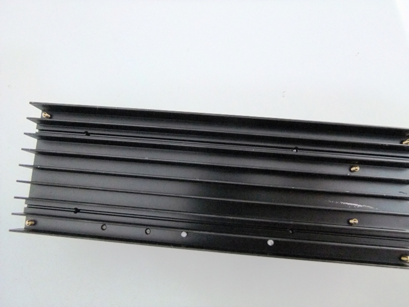

we have finished t2100/t2150 and t2100d/t2150d modules now, tda8920cth or tda8950th works well, all protection and burning test passed. DSP series have very good dynamic compress performance.
