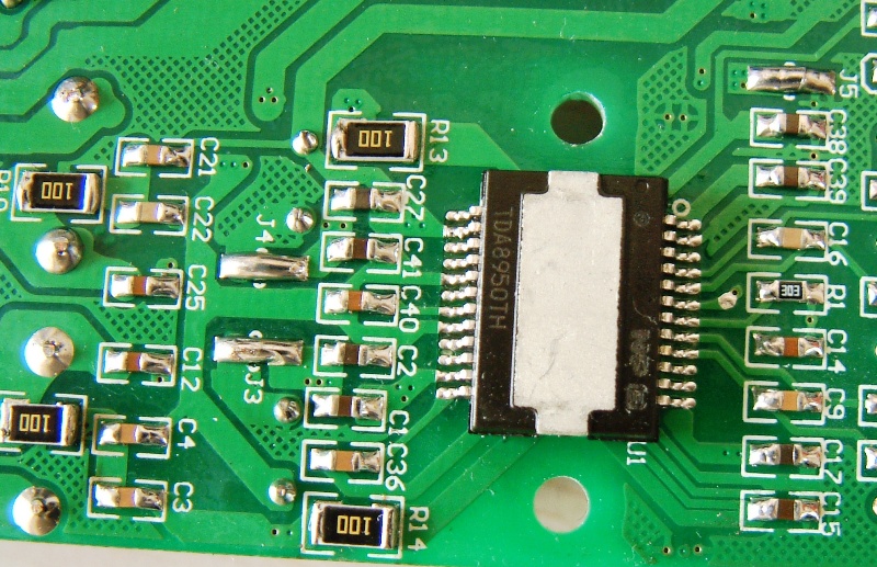

New design
I made a board based on TDA8920B schematic in datasheet. Since I used most components trough hole but 100nF caps and TDA8920BTH (all SMD), I made a single side board. No noise or EMI problems using just a heatsink (a piece of plane aluminium) conected to GND. Also, I used jumpers to select BTL or SE configuration.
At present NXP recomends a new schematic (simplified one) for TDA8920C and TDA8950. It seams to be propper for 8920B too. Did anybody test the new schematic with 8920B? Thanks, Rodolfo

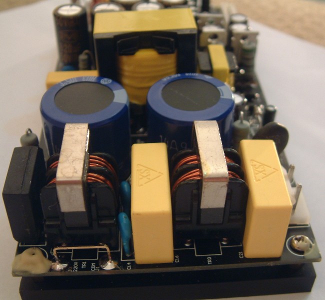

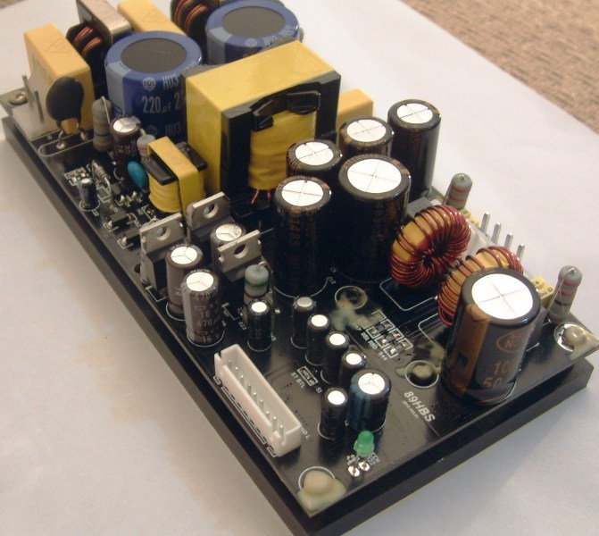

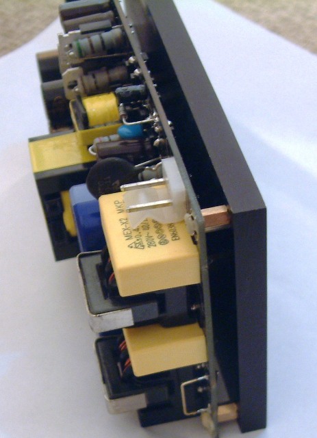

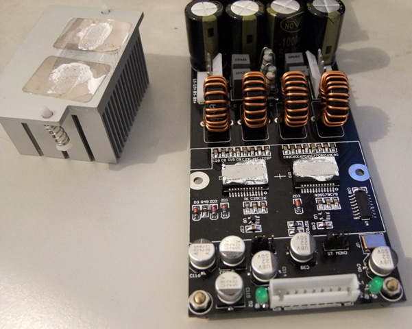

Another batch TDA8950TH chip arrived days ago,we have revised the circuit and build one newer module,of course,include CLASS D and SMPS,sound good.
Key Specifications:
POWER OUT:
2×150W/ 4Ω /10%THD/SE MODE
2×100W/ 4Ω / 0.05%THD / SE MODE
1×300W/ 8Ω /10%THD/ BTL MODE
FREQUENCY RESPONSE: THD+N ≤0.05% / 20-20KHz / ±1dB/1W
INPUT SENSITIVITY: 0dB(1Vrms)
POWER SUPPLY: 110VAC OR 220VAC 50 OR 60Hz
AUXILIARY POWER: +/- 15V/100mA and +5V/200mA
DIMENSIONS: 160MM(length)*80(width)*50mm(height)
WEIGHT: 0.54Kg

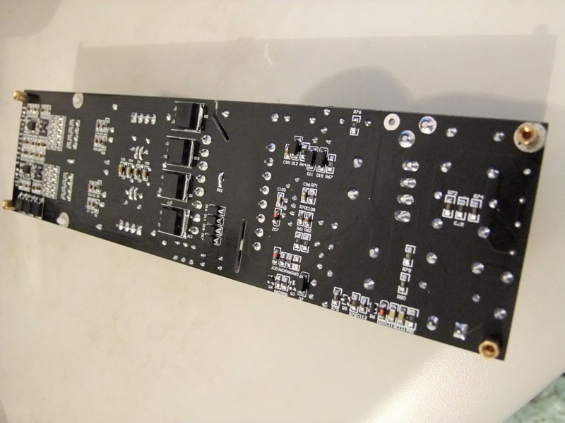

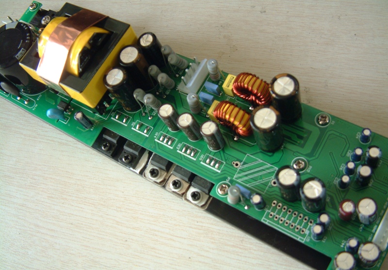

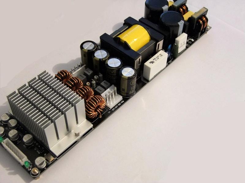

Duad TDA8950+SMPS IN ONE BOARD
We have finsh our new tda8950 board,performance good .sound good.
proamp design.dynamic compressor and ocp/otp/uvp/ovp protection inside.
POWER OUT: 1×100W/ 4Ω /0.05%THD/4SE MODE
2×200W/ 8Ω / 0.05%THD / 2BTL MODE
1×400W/ 4Ω /1%THD/ PBTL MODE
COMPRESSOR THRESHOLD: +4dBu
AUXILIARY POWER: +/- 15V/100mA and +5V/200mArms
DIMENSIONS: 250MM(length)*65mm(width)*39mm(height)
WEIGHT: 0.47Kg
