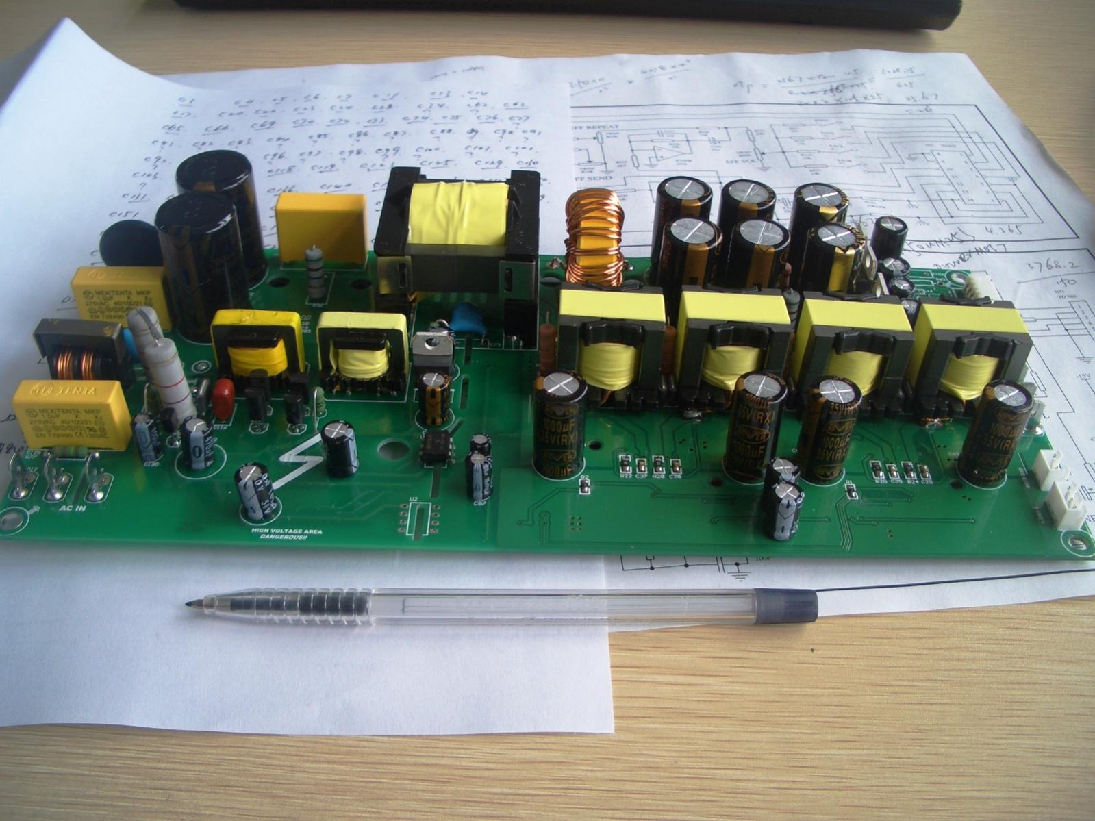

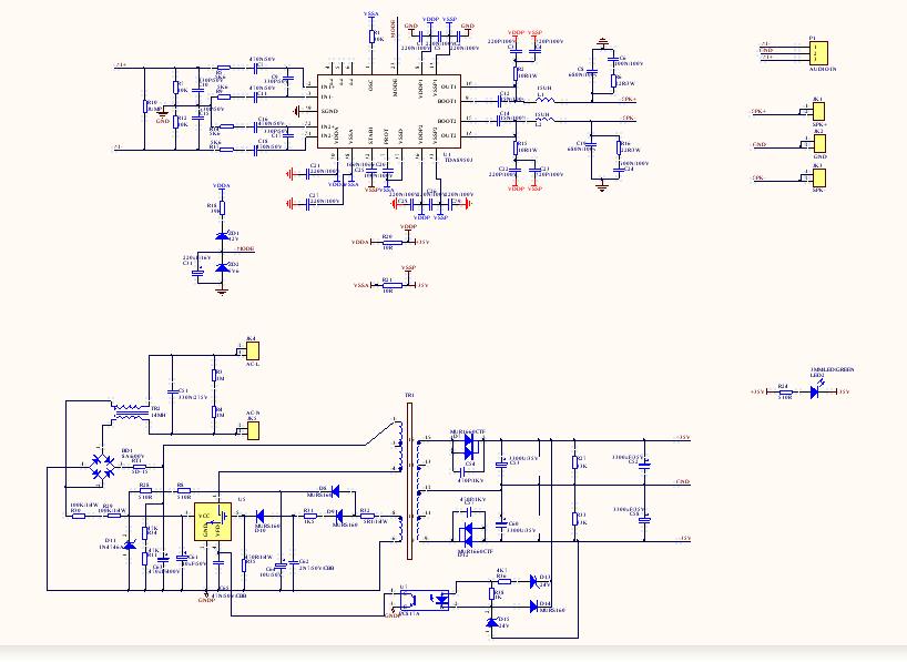

I also made amp and SMPS module for TDA8950.schematic here ,If anybody like ,please do it youself.If you have any question please ask me by mail.I have made lots of modules use tda8922 tda8920BTH TDA8950B,now NXP new class d chip TDA8953.TDA8954,high power out.but I still no time try it.

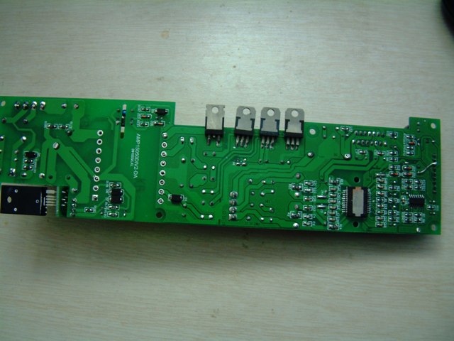

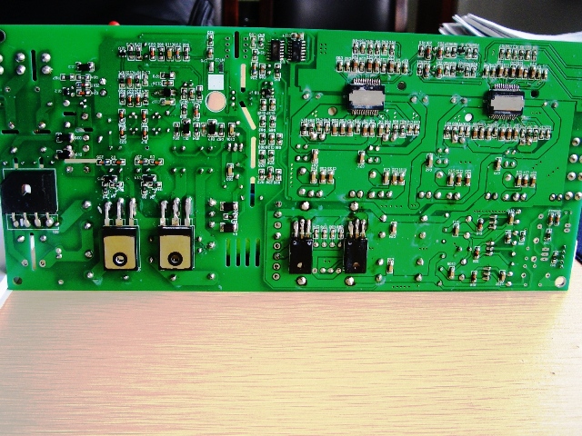

I have compare many times,tda8920BJ sound better than tda8920bth,but tda8920bj difficult fit together.
Must careful if you add smps and tda8920 in one board,there always have hiss noise background.you must separate AGND and PGND .
few years ago ,I use TOP261YN and tda8920BTH design one module for combo powered mixer,it waste me lots of time to deal with this problem。I design 4 version PCB ,I work this out at last.
