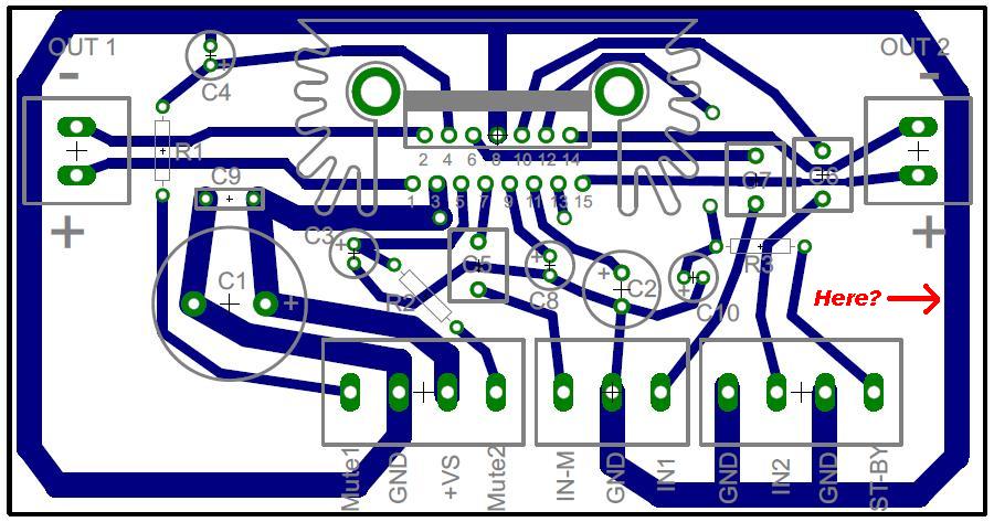

Hmmm, I'm thinking isolation transformers to eliminate ground loop may be the wrong approach. For one thing I can tell there is more than ground loop going on when the amp is hooked up to the same power supply the PC is using. I can hear noise from actions such as mouse scrolling. Also, this individual was able to overcome the noise issue with one 10 Ohm resistor:
4x15 Watt quad audio amplifier
Does anyone know if a similar solution could be applied to the TDA7393 I am using?
That resistor is a quite common approach that works with any amplifier.
Great! Is this where to place it? (see pic)
On the opposite side between C4 and the power supply GND terminal.
Ah, thanks.

I hadn't noticed that. In that case you actually should not apply that resistor, because the supply current would flow through it and lead to a big voltage drop across that resistor.
What you can try to do is to provide only one GND connection between amp and PC. You have four GND terminals on your PCB. Disconnect the GND wires from the input and stand-by terminals and see, if the noise becomes less. For a loop you need at least two paths. Is the heatsinking tab isolated from the computer case to avoid another path to the PC's GND?
Already tried that with no effect. (heatsink is not connected to anything)
