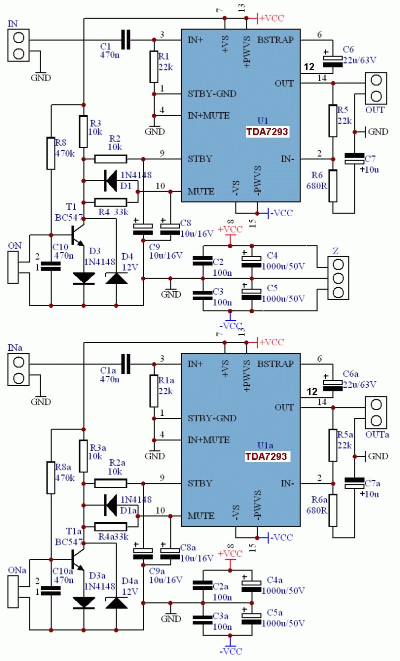

4 ohm speakers? High wattage chip amp? That is doable.Hi guys!

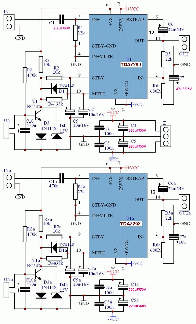

Will I create an audio amplifier with TDA7293. I have (dispose) of 250VA transformer with the secondary of 2x27Vac the stereo version. Speakers with impedance of 4R. So please give me a scjematic (circuit) or project Amplifier with TDA 7293 for this power supply.
Thanks for your help!

Yes, it looks like a working amplifier; however, I have some notes:
C1 is slightly too small
C7 is far too small
C4 and C5 are too large
Excessive parts count in mute and standby may cause board layout difficulty
C7 is far too small

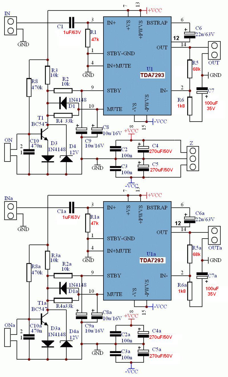

Daniel, so it should look like this schematic!😉Yes, it looks like a working amplifier; however, I have some notes:

That's a lot better.Daniel, so it should look like this schematic!😉
cheers!![]()
The input cap, C1 should be, probably 1uF.
The nfb-shunt-cap, C7 does not reach a valid figure when paired with 680R, so simply use 100uF and call it good (even so, that would work better if you at least tripled the 680R and 22K up to 1.8k and 68k, so that the feedback-shunt RC value is a lower pitch for better clearer bass).
The 220uF on C4 and C5 should have the amplifier running nice clear and cool; however, you could use 270uF if you wanted to.

Yes, that's looking really nice.It came to him like this!😉
R1 will also adjust the tone with 22k too forwards and 47k too laid back, so perhaps you might like 27k. The difference is minor.
