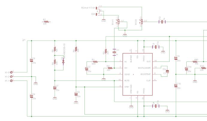

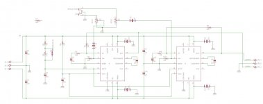

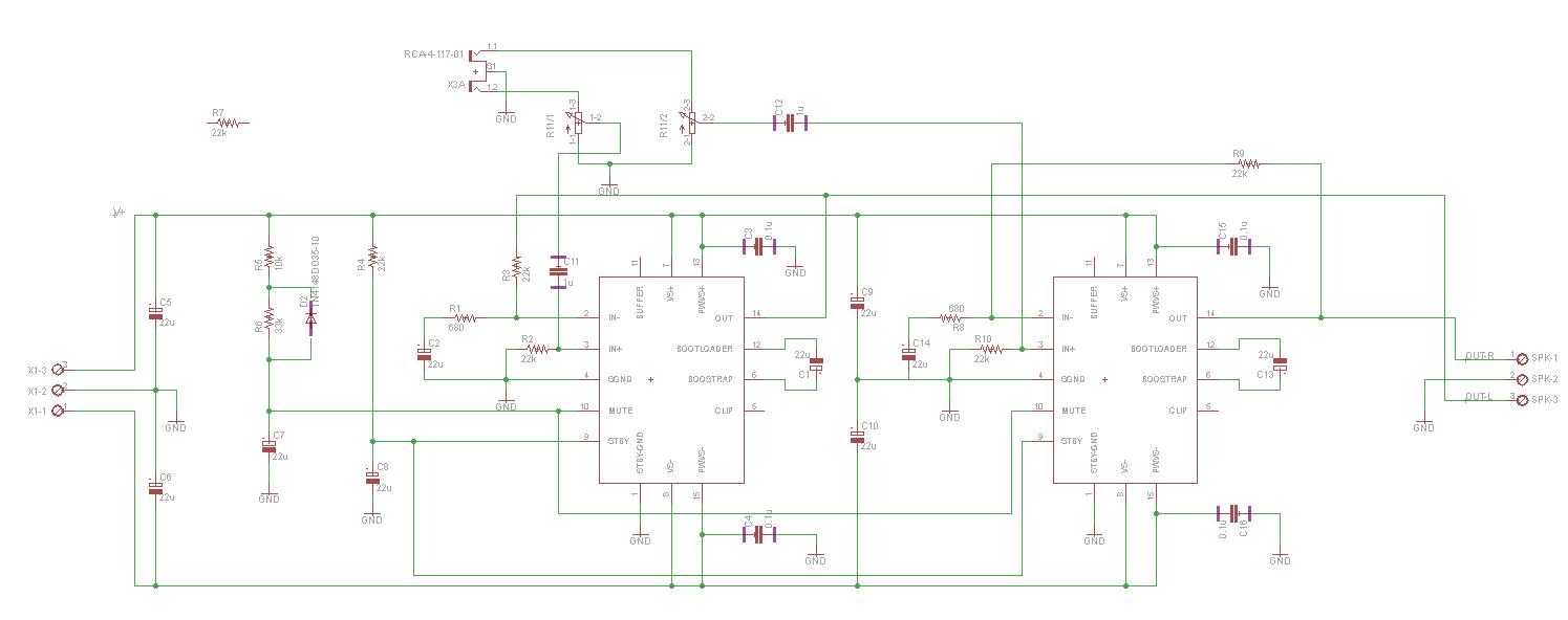

reverse engineered schematics ( only one channel )
the attached schematics is the reverse enginneered schematics from the XY hifi company. I did it with eagle.
do you find something possibly causing strange behaviour ? Maybe +38 and -38 are too much ? or some value cause RF oscillation ?

I don't know about others, but I can't read your sch, because it is too small, 691 by 407
try 1200 by 707, or a bit bigger.
Check your post pic and see if you can read it on your monitor.

The inputs look OK.
You have local decoupling.
Don't know how you have connected the nine GNDs together.
Don't know what your chip needs for mute and standby.

I think the designer decided to connect the +Vs supply to the mute/stdby inputs as on page 6 of 21 of the ST manual. Maybe the timing is a little bit different ? Or maybe there should be a specific slope of the power supply to make this circuit work fine.
http://www.st.com/web/en/resource/technical/document/datasheet/CD00001887.pdf
afaik , the mute time constant during power up should be 40ms for mute and 20ms for stdby . But in my circuit it is a double value. In other words , first the stdby signal reach Vs+ , and after some time the mute signal reach Vs+ too . But my circuit is simply slower to do this. GND is a reference track on the PCB i got , but i draw it as a GND signal. DO you have experience with this chip ?
I got it wrong.
The chip is single channel.
You cannot connect two input channels as you have shown.
Can you post the whole sch, so I can see the missing parts.
I have shown just one of the 2 chips , I have one input coming from the pot R11/1 going to C11 with R2 polarization , the other input , going to the other chip exactly in the same way , starts from R11/2 and is simply not shown. Ok . I''ll send the whoole diagram in the afternoon.
