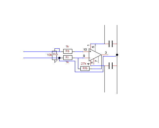

This layout design has improved THD compared to the first one. Tomchr proved it with measurements. I also don't like the long GND lead because it carries the feedback current. (1,07 mA from the first schematic).
I don't know why my png's open to full page.
The ref wire carries current. That was something I had not realised.
That current has a matching partner.
The ref wire MUST FOLLOW the matching partner.
Think for a moment about speaker current.
The PSU sends current from +ve to amp, through amp, to output terminal, through the Flow wire to speaker, through speaker, through the Return wire, across the amplifier PCB tracking close to and parallel to the main PCB traces to the reach the Power Ground Terminal, then continues it's route along the PG wire to the PSU Zero Volts.
The Flow Route from +ve to speaker must be close coupled to the Return Route from Speaker to Zero Volts and into the PSU capacitors to the starting +ve.
This is a quite tortuous route, but for least interference must be adhered to.
The same logical thinking of ALL Flow and Return Routes can eliminate ALL the major and minor interference effects, leaving only microscopic levels.
I think this is what Tom discovered in the P2P comparison to the PCB version.
Tom got some results that bettered the National's specifications. That is very unusual and points to National's LAYOUT not being optimum. When I see some of National's basic errors in the datasheets I can believe they got layout wrong, i.e. worse than not optimum.
###The ref wire carries current. That was something I had not realised.#####
That was the point I was trying to make from the start.
If we only look at the current flow, the first layout should be best and it works for the output and PSU layout. For the chip's inputs, which are voltage driven, it doesn't give the best result. I think it must be more important to have the inputs measuring voltage relative to the same point (input ground) than the current flow to power ground.

Yes, I agree.
The amplifier measures the voltage difference across the RCA/XLR input socket.
And processes that signal.
Everything we do in wiring up the amplifier should try to preserve the integrity of that input signal.
That means interference should be minimised everywhere.
The new route for the ref voltage follows closely along side the input wiring and alongside the chip and alongside the output wire.
But I still don't like the way you are showing the smoothing cap link as the Main Audio Ground (MAG).
Could you separate the MAG from the PSU Zero Volts with a short wire?
BTW, this latest attachment opens in the same page.
What did you do different?
Or is it the Forum Software that determines how we see attachments?
Pairing wires with the Flow and Return currents matches the CURRENTS exactly.
The pair is a good way to transfer the voltage difference to a new location without extra interference, because the fields of the Flow and Return currents match.
The pair can transfer the required voltage AND give low LOOP AREA.
If there is an offshoot that carries part of the current, then that offshoot must follow the current route that led to the offshoot. Your last diagram shows that. The offshoot (the ref wire) has doubled back along the line of the signal pair.

post114, on some other page so I'm going by memory, has invented big new loop areas.
I can see immediately that it cannot perform properly.
Electrically it looks perfect, because we assume wires have no resistance/impedance and that there is no interference going on.
Practically it is just wrong !

Post 114 could be made with a small loop areas and still would not be as good as post 123 with its better input layout.
######But I still don't like the way you are showing the smoothing cap link as the Main Audio Ground (MAG). ######
Each bypass cap has its own floating PSU. No need for a MAG, there are no charging currents though the power GND point.
are you confirming that the two caps shown are not the smoothing caps in the PSU?
If so then I suggest they are the local decoupling, with the joint representing the on PCB Power Ground.
Is that the case?
