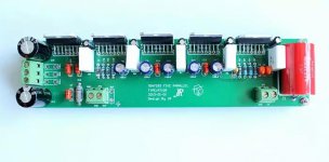

I've never found insulators that size. I've used bulk thermopad, and I've used Kapton tape (with WHITE pc cpu thermal compound) and shoulder washers. I've also used black alloy radio transmitter heatsink (aluminum oxide) with chamfered holes filled with Arctic Ceramique, mainly because a small heatsink was cheap and worked fine. I've harvested mica manually with my pocketknife while bicycle touring. Once, I even used an old teflon skillet from the junk store (the teflon could be greased with Arctic Ceramique). Just mind the shoulder washers and chamfer/divot the hole so that tightening the bolt doesn't pull aluminum through your insulator (check with ohmmeter).Hi Daniel,do you know a place to order the multiwatt15 isolators for this board? Thanks
Thermal compound must be a white color. It could be Arctic Ceramic which is too thick so you have to squeegie/scrape it thin (its fantastic except for a wee spot of labor) or it could be GC 44 or it could be ordinary bulk white thermal grease; but don't use any of the metal colored stuff.
And, you have to use the shoulder washers as well as your ohmmeter to confirm that the tab doesn't electrically conduct to the heatsink. It is also important to secure the board so that it won't ever move to a different (possibly electrically conductive) spot on the heatsink. We wouldn't want that news to change during service. Bolt it down, then check again.

0.1R 5W 5% resistors connected to outstage of each chipWhat are these white prismatic components?
