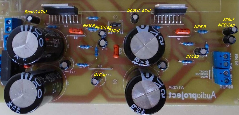

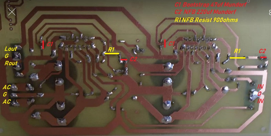

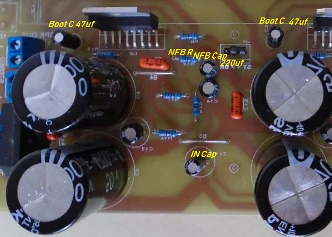

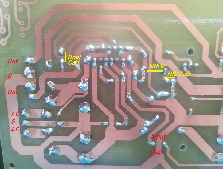

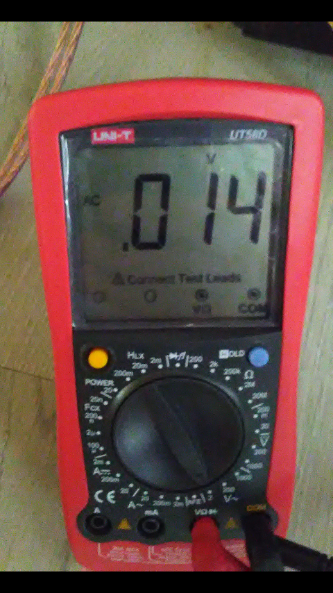

First, make ALL wires for right channel Exactly the same length and size/gauge as left channel (especially, identical left/right, input wires and dc power wires--NO left/right difference).Friends i build a tda7293 module estereo , and i have 60hz hum in one channel.
0.014v ac ,is not a lot of ac noise, but why ?
Second, use a battery powered source (because it can't ground loop if it isn't plugged in).
SO,
The above steps will help to find the layout fault; because, if it wasn't the wiring, then the fault is in the board layout.
For that, you'll need to post photos, using the attachment feature.
