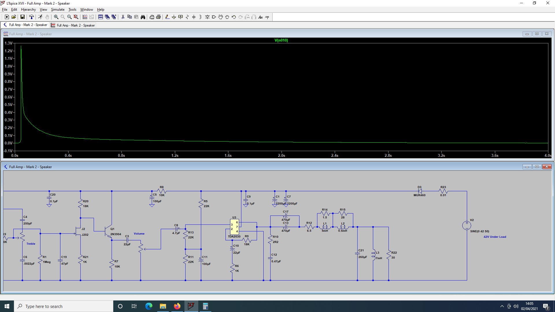

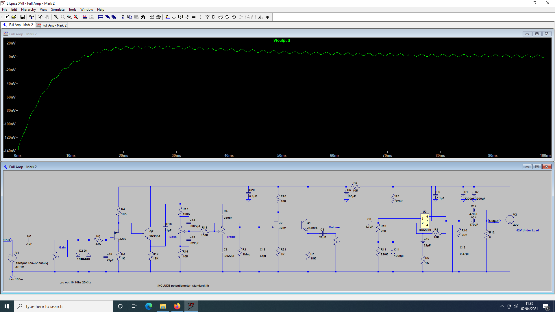

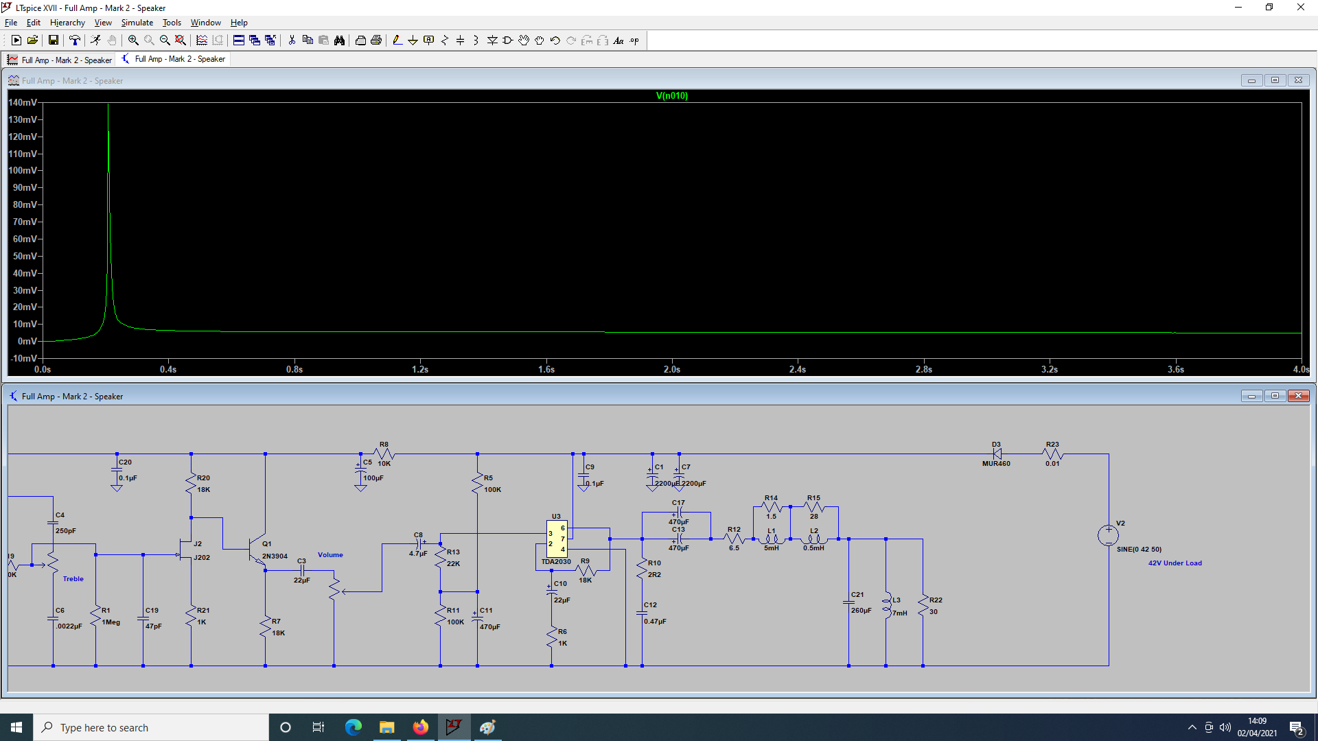

I've simulated a few scenarios and found the following. I did a 100ms simulation measured at the speaker output (Crudely simulated by an 8Ohm resistor in this case). I think the issue is the output capacitor charging up through the speaker and you see in the simulation that the voltage actually momentarily rises above 0 before settling around 0.

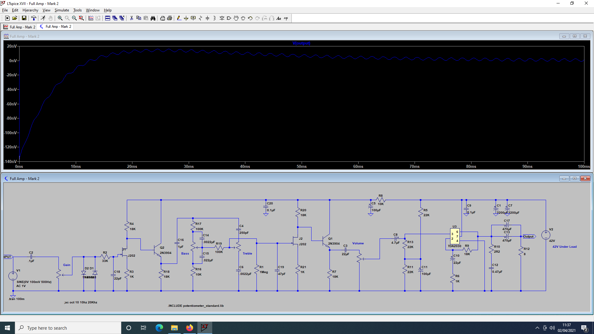

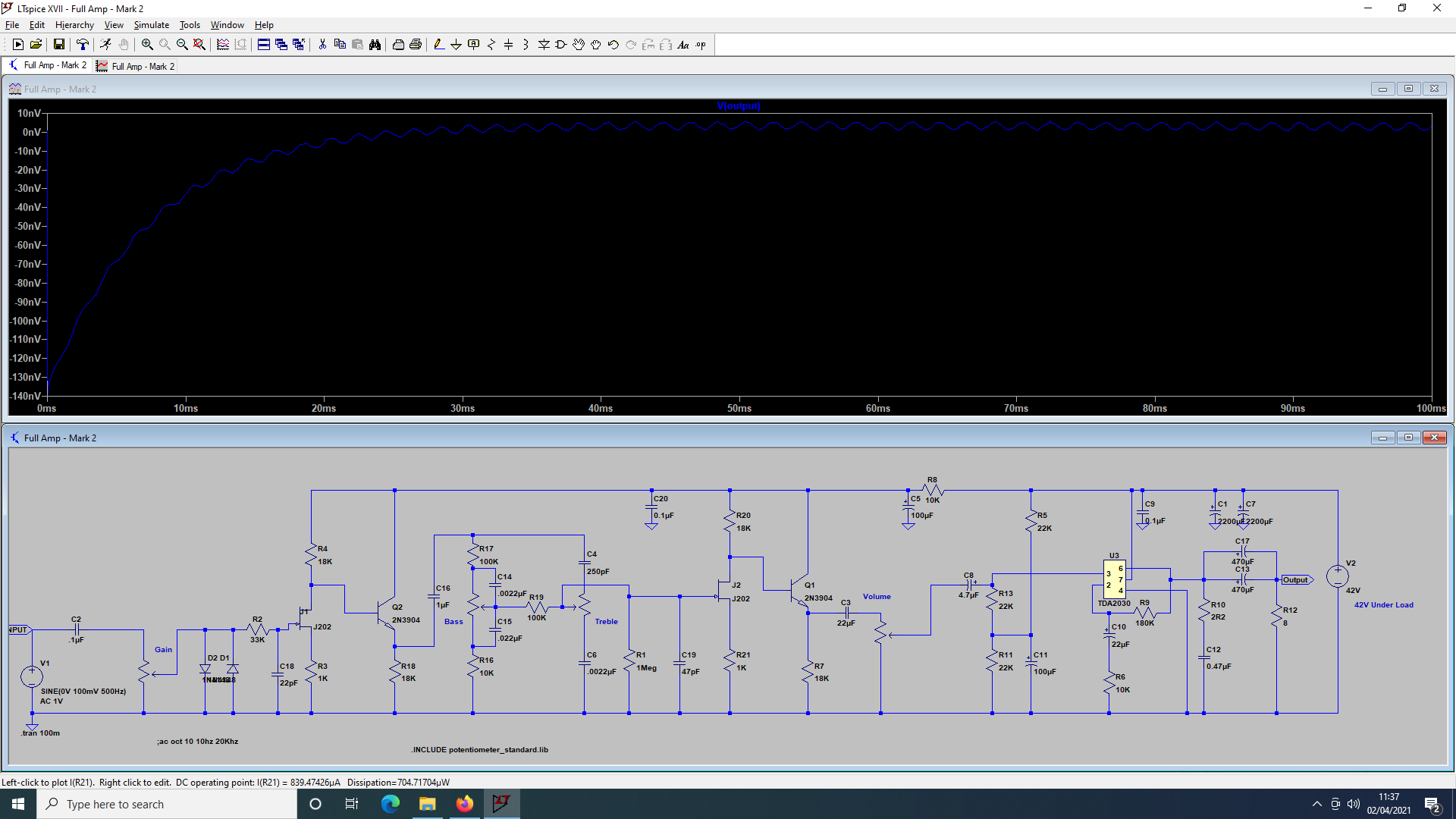

In one simulation I tried to increase R11, R13 and C11 as suggested, but it didn't have any effect on the output. The only difference I could see was that R11 and R13 have nearly 1mA across them when they're 22K and rising to 100K lowers this to 0.2mA.
I then looked at the LM1875 datasheet and noticed that their suggested circuit for single supply has the feedback resistors multiplied by 10 compared with split supply.I tried this in my circuit and the result was the output doesn't seem to spike on switch on. I wonder if that's part of the problem.
The other solution of course is to have a 470Ohm resistor across the speaker output but have a switch to take the speaker out of the circuit for switch on and switch off. Crude, but it would solve the issue. I've read quite a few threads on the issue and it appears most people just seem to live with it.
this is just a few nanovolts - should not be audible.
i guess you have to simulate switching on the power supply to see what this does. if you just have a constant DC power supply the simulation does not include switching it on.
That’s a very good point actually! I did try scoping the output on switch on but I’m using a picoscope and the spike is too quick to see on it.
Thank you for the power supply pointer, I can now see the spike!

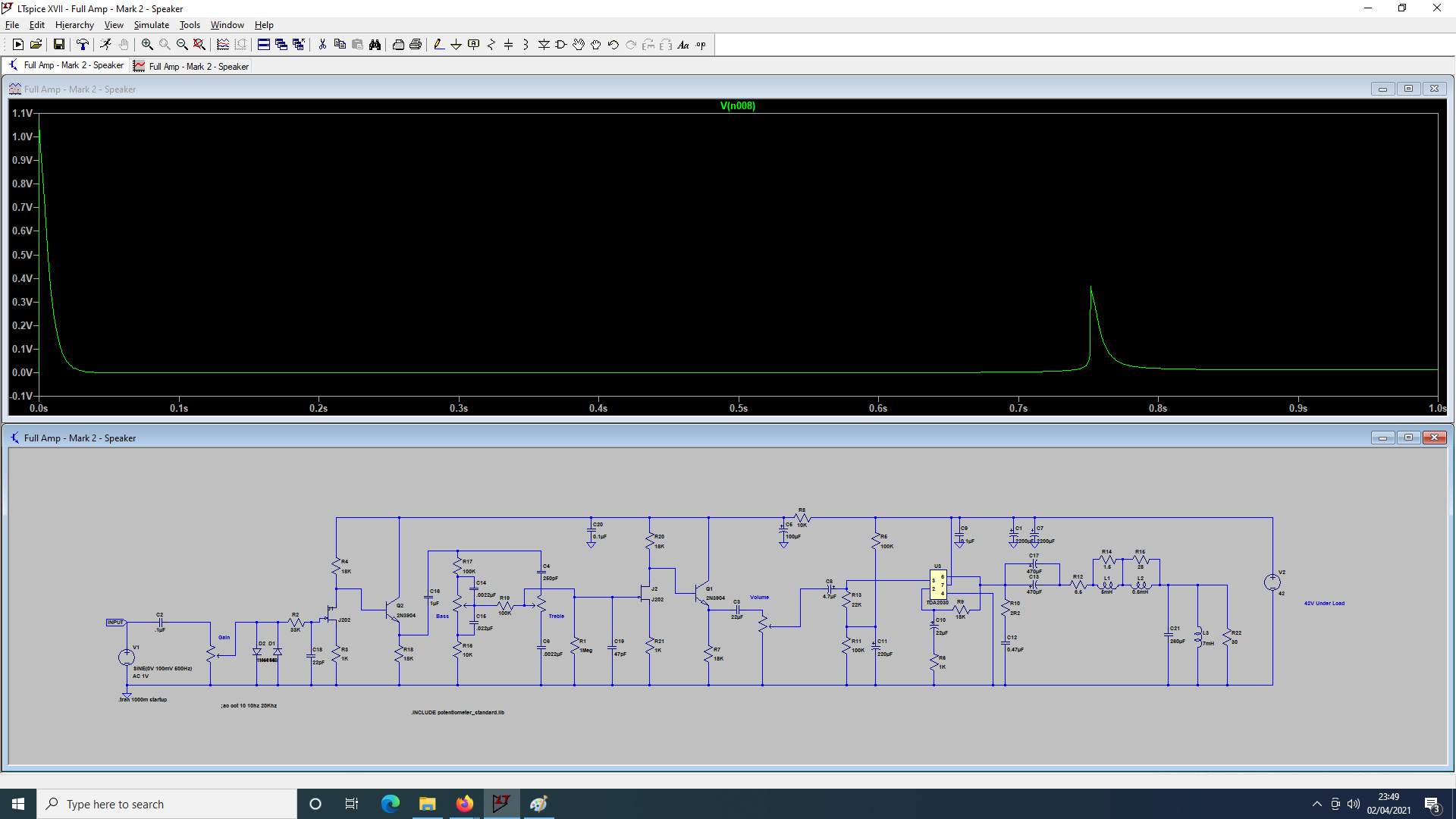

So just by changing the R11 and R13 resistors the spike is reduced by over half. The only downside I can see with this is it means the amp won't be fully operational until at least 10 seconds have passed. Not a big issue. I'll do some more testing.
As for the feedback resistors, they seem to reduce the spike a tiny bit but more than anything they seem to make the output take longer to stabilise.

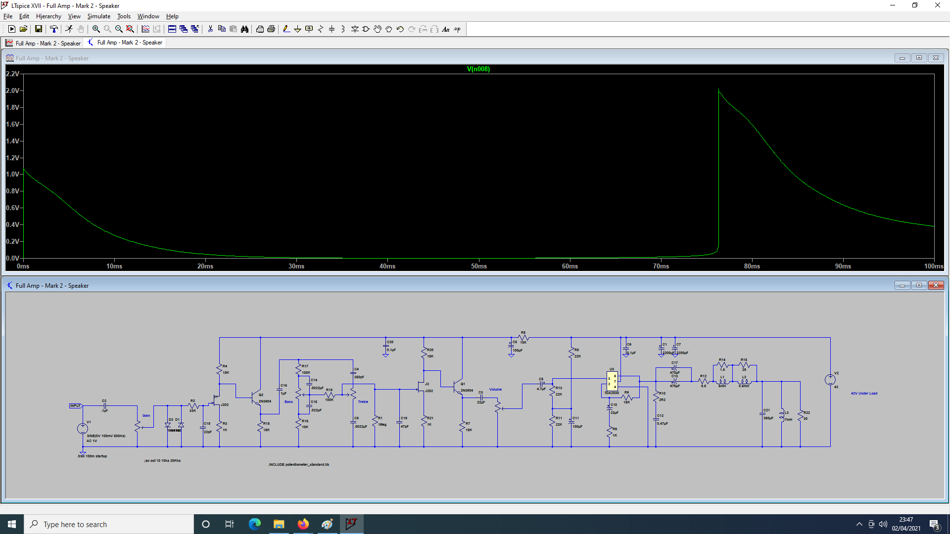

I don't think you simulated the startup conditions properly.
The simplest way to do it is probably to tick the "start supplies at 0V" box.
Your sim directive should look like this: ".tran 100m startup".
Note that a soft thump of a few hundreds mV is not going to be very noticeable.
When it reaches several volts, you have an issue. You should first try to get an amplitude that large on the unmodified circuit sim, and start improvements from there.
Also note that a slowish start is not going to mute the amplifier: it will become operational very quickly, but at first it will clip at lower power than when operating normally, which shouldn't be too much of an issue, except if you have the habit of leaving the volume always at 100%
Tested again, this time just with setting the 'start external dc at 0v' setting and the thump is appearing as a 2V spike. Again, increasing the resistors or capacitor you mentioned seems to delay the spike slightly and make it smaller. I also ran a test to see when the amplifier starts to output signal and it doesn't affect this, it starts to amplify at the same time either way.
Are these changes simply making the output capacitors and C11 charge at a slower rate? Thus reducing the thump?
The slower rate plays a role, but the key point is to make C11 charge more slowly than C10, to allow the feedback to retain control
