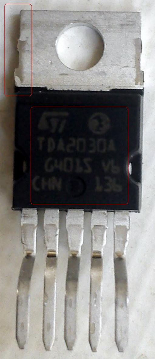

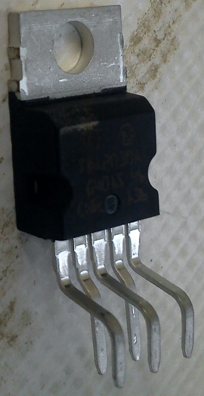

Fake TDA2030/50 etc...
The Chinese ICs are copies, even with what seems to be correct markings. It is becoming an issue. Most holders of the bogus inventories do not even know. Buy from 1st line distributors like digikey etc.
Here is an example of some transistors.
http://sound.westhost.com/fake/counterfeit-p2.htm
X-ray and destructive testing are only way to be sure if you have a questionable batch.
Leolabs said:I have seen a lot of cheap multimedia audio stuff from China using TDA2030,but doesnt mean that they sound bad,some of them are really good if u know how to tweak them.
Regarding replacement,LM1875 is my first choice.The TDA 2050 on the other hand,u cant push it over plus minus 25V
Fake TDA2030
The Fake Ic's are a big problem here in China, i work for a IC test and inspection company here and i can say if you buy online, be carefull! there is ALLOT of fake stuff out there!
If you uy large quantities its advisable to use some kind of QC company to ensure that the parts are not Fake.
