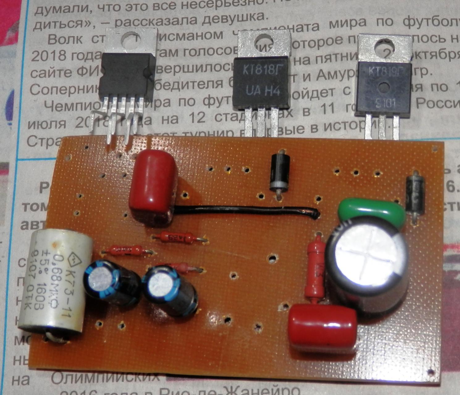

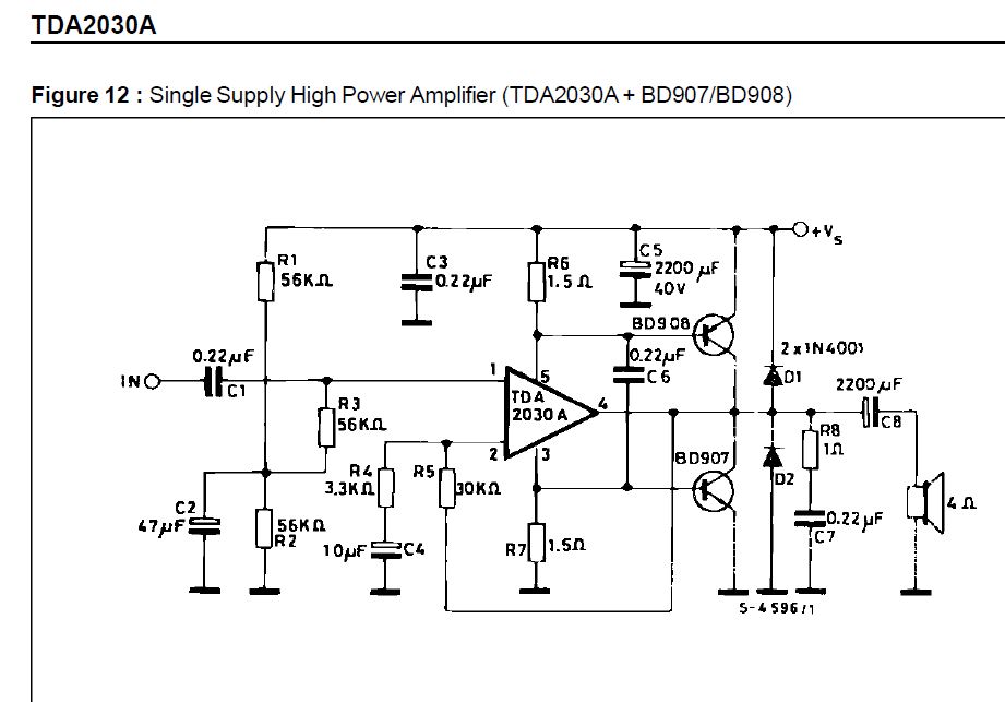

I decided to try scematic TDA2030 as a tranzistor driver. And i have some questions about that schematic.
Did anyone do such a scheme? Does it sound normal? Will that schematic give me some troubles with installation and tuning?
Starting at what output power will additional transistors begin working?
What power supply unit should I use? How many watts?
And in this scheme, the gain factor is 10 as I understand it. Is this enough for an input signal level of 500 mV? What values of pR4 and R5 should I use?
I will definitely try this scheme. I already made a circuit board and almost soldered all the components.

that schematic is similar to the one in the sgs(-thomson) ........page 6
TDA2030A Datasheet pdf - 14W Hi-Fi audio amplifier. Supply voltage Vs: +-6V,min; +-22V,max . Quiescent drain current Id: 50Ma,typ; 80mA,max. - Contek Microelectronics
you need proper heatsinks;
do not forget the isolating material for the transistors and the ic;
if the voltage drop across the 1,5ohm res is bigger than 0,6volt the transistors begin to conduct ( ......0,4A current......could be 0,3W Pout with a 4ohm speaker);

Your circuit is a worked example from the data sheet and so should be OK, and particularly as you are using the correct PCB.

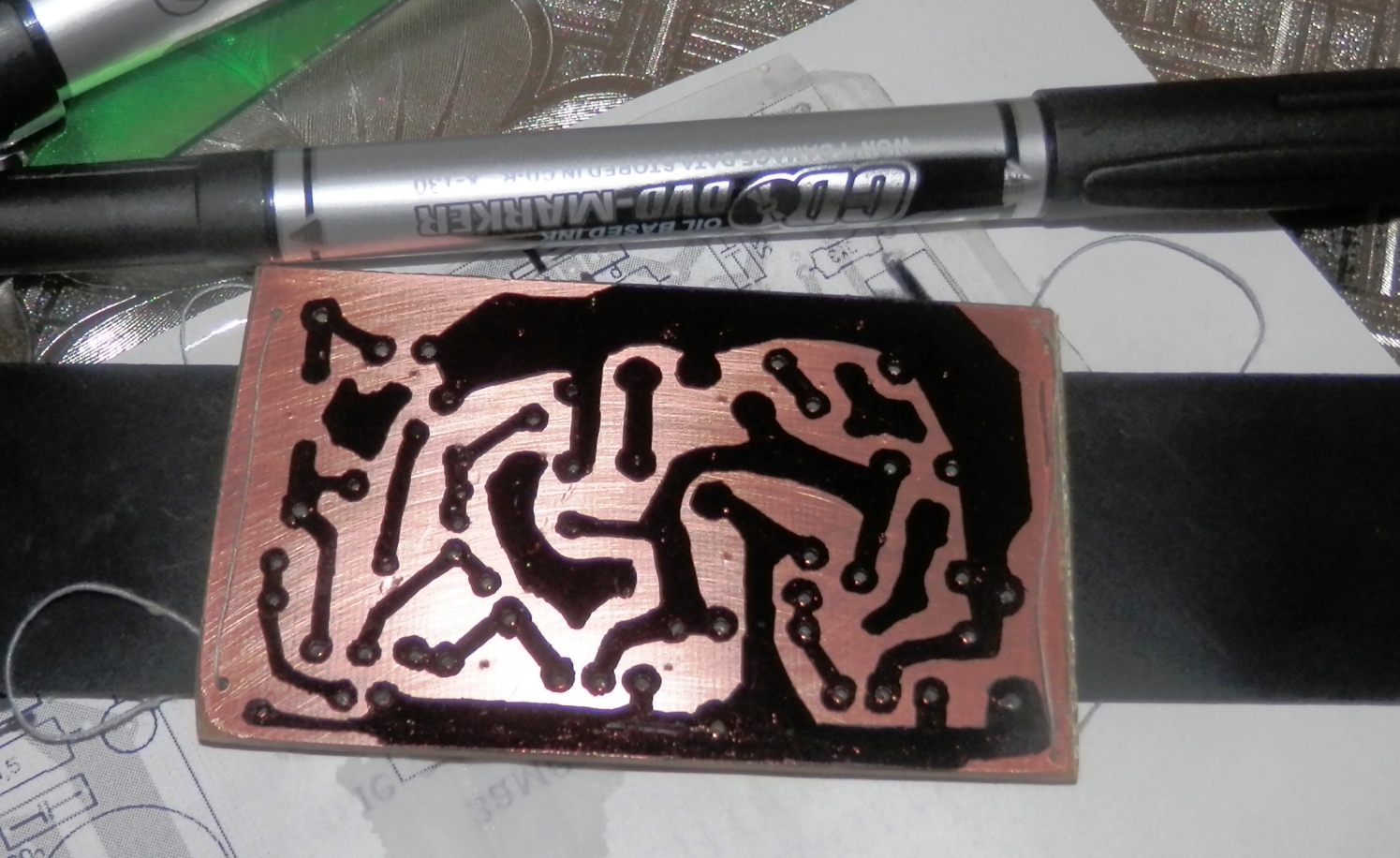

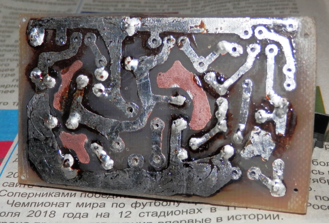

I rechecked my PCB one more time, it is correct.
Find what? That PCB? I found a PCB on the inet and remade it a little.
I don't like PCB from datasheet because a chip and transistors are very far from the edge.

TDA2030 will supply between 0.65 and 0.95 W RMS by itself; after that the power transistors take over.

Lots of these (a variation on the same topology) were made in 80s, this was a popular design at that time, published in a local tech magazine, probably direct copy from the factory brochure, "no setup required, plug-and-play" etc. I made some, people I knew made some and there was a common theme: the tendency to blow up randomly without any forewarning. No amount of oversized heatsinking could cure that.
So proceed with extra caution and double ckeck everything.
Who knows, it may work for you without a hiccup.
I wonder the purpose of this circuit.
The power output of the TDA2030 remains the same.
Maybe it's meant to drive 2 ohms.

Chips like the TDA20xx are not intended to be used at max Vcc and lowest impedance simultaneously. Adding the extra transistors lets you do both. Run it at 12-18 volts where the chip is fat and happy, you will see no improvement. Run it at 30 volts where the chip has trouble with 2 ohms, you would be able to run harder before it goes into current or thermal limit. The downside is you lose all that internal protection built into the chip. Overload the transistors and poof you buy another pair.

The PCB is too huge. It's like an airport 🙂 And on the contrary, output and power supply's caps are too small. They are, especially output cap, much bigger in real.

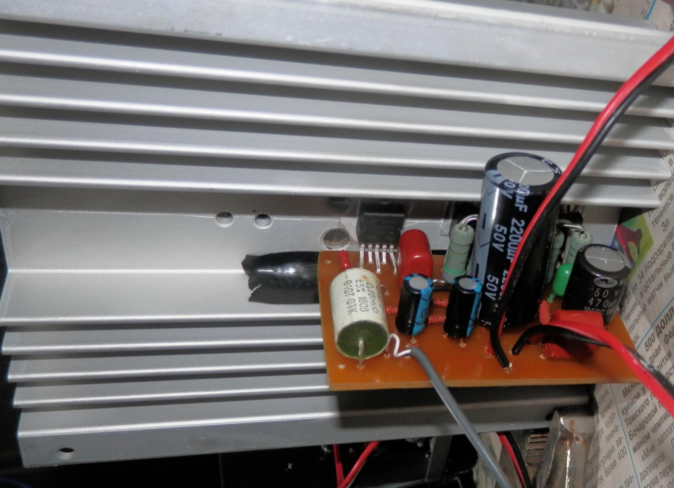

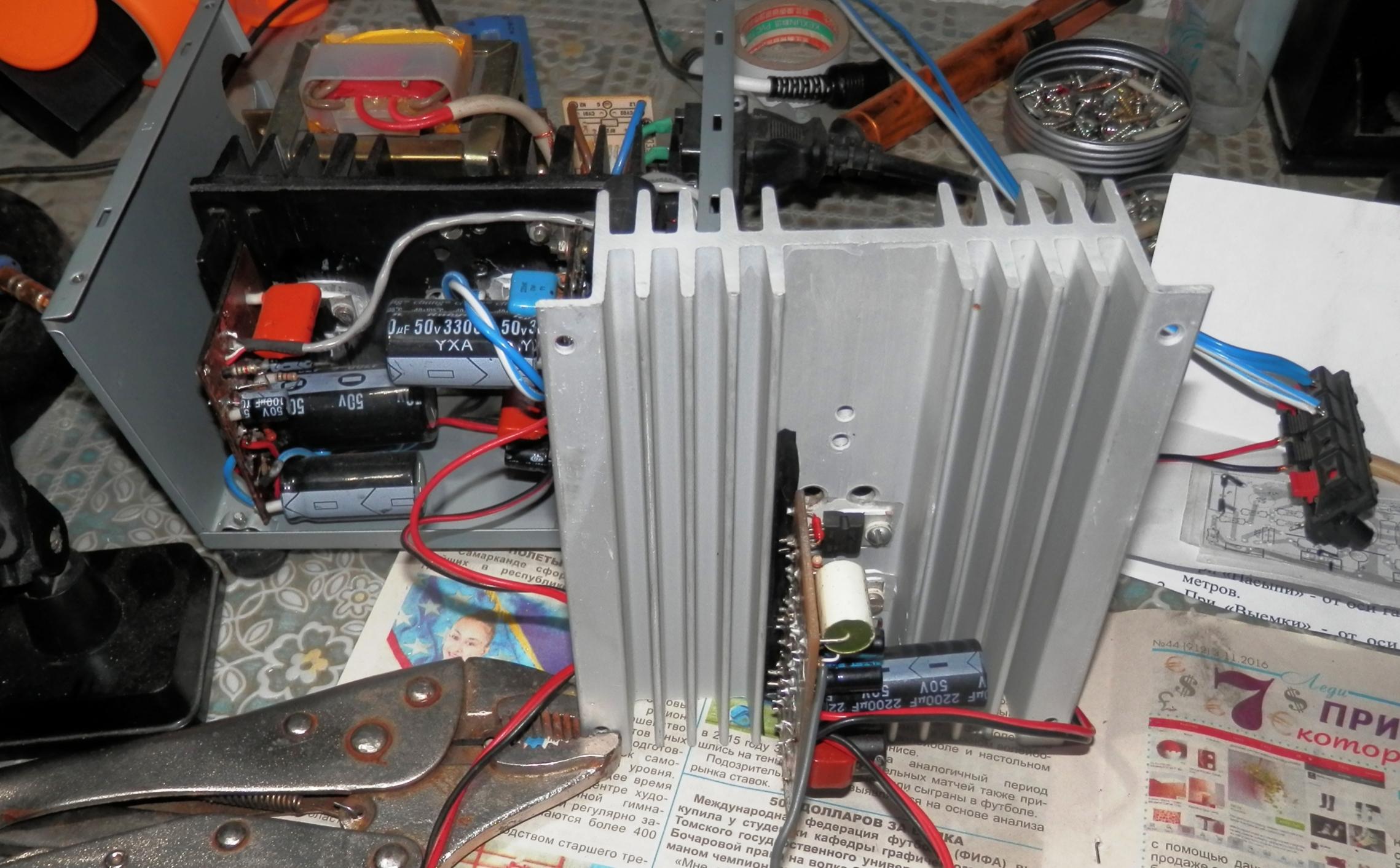

So I've already finished one channel of my amp and listened it to check how it sounds. It started to work immediately without any problems. I temporarily, for checking, took the power for it from my other amplifier. It's 37 V and 2*4700 uF.
Well, I don't know what to say about it. It seems there is a difference and it seems there is no difference between TDA + transistors and bare chip.
Who made or listened that scematic? What was your feeling?

As others have said, the output transistors will only come into play at higher volume levels, when the load current causes enough volt drop across the 1.5 ohm resistors to allow the transistors to begin to take over.
Thank you 🙂good to hear you have it working OK.
And I want to do some tests of that amp with an oscilloscope. For example, the shape of a sinusoid and synchronism of opening of transistors.
That would be good. Testing at higher frequency (say 10 to 20kHz) and into a lower load impedance could be revealing... but be careful not to overload it.
