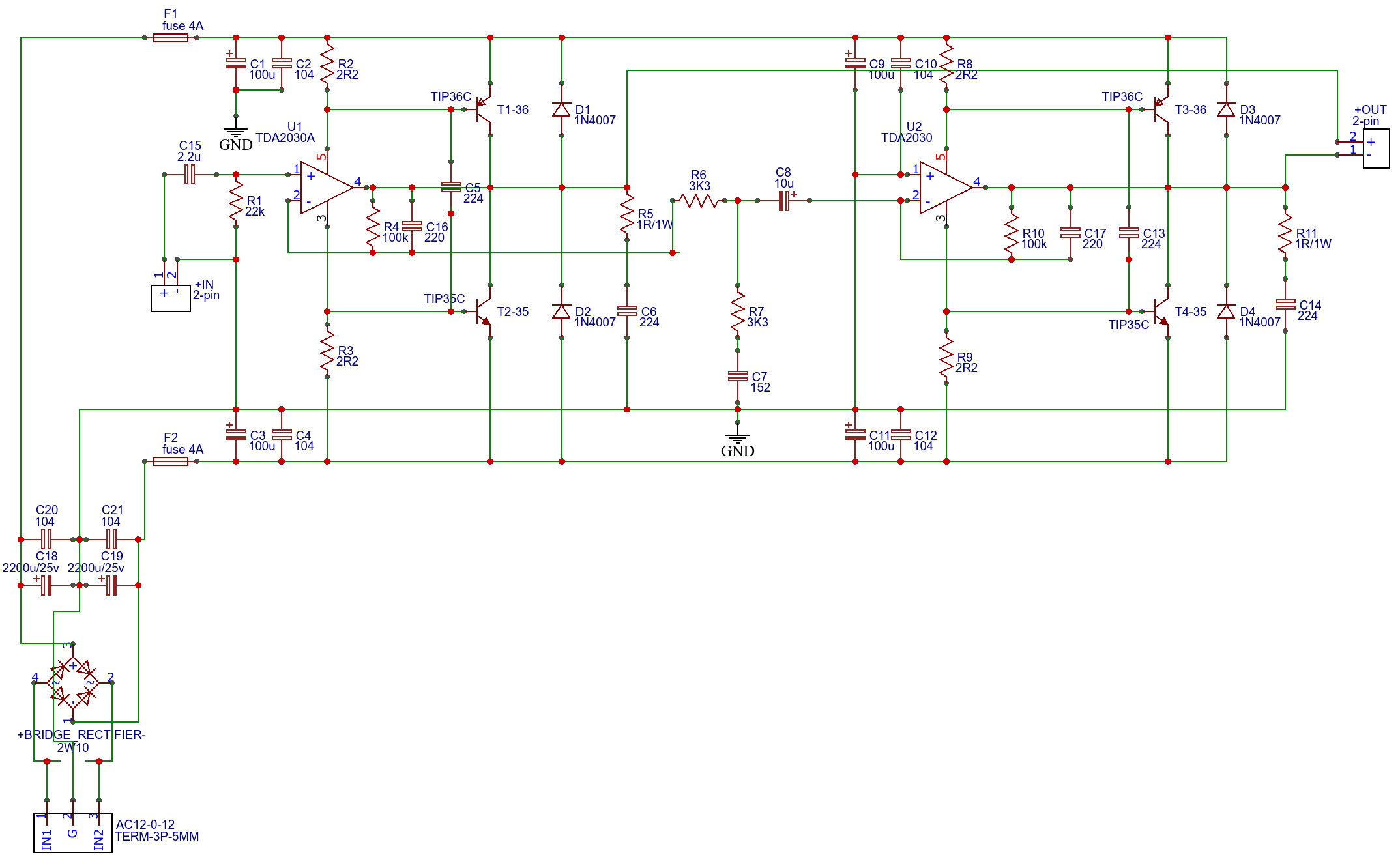

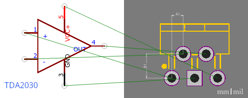

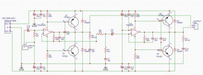

I am trying to build a mono amp based on bridged TDA2030 (2050) with output transistors TIP35/TIP36. I found a schematic that seems ok here https://320volt.com/wp-content/uploads/2009/03/200watt-anfi-devre-semasi.png and I copied it in EasyEDA to build a PCB. But I am not sure if I've done it correctly, particulary the transistors connections.

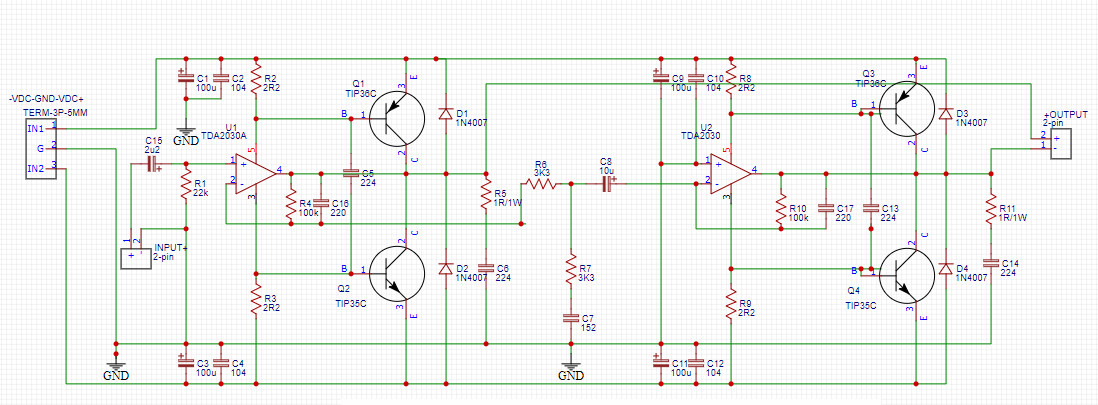

Here is my schematic:
attachment.php

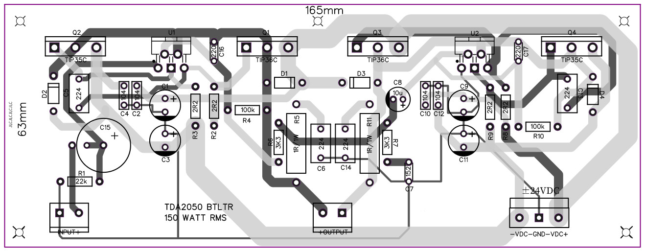

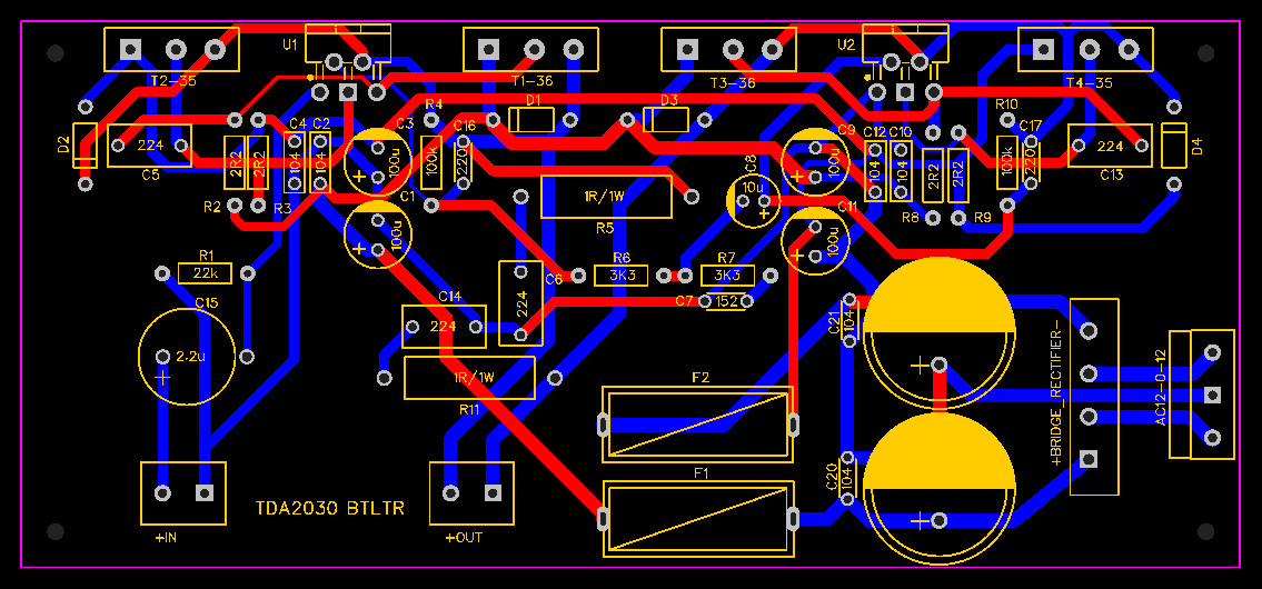

and here is an autorouted PCB I want to use as a reference:
attachment.php

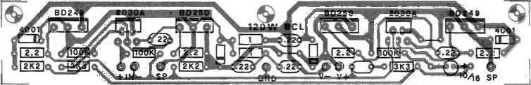

BUT with a similar schematic (I don't have the link, but is quite similar, without any input filterning and decoupling), the PCB looks entirely different, regarding the connections of the transistors (BDA249/TIP35C and BDA250/TIP36C):
attachment.php
I used schematics/footprints contributed by other users for TDA2030 and TIP35C/TIP36C and I din't change anything in pins/footprints.
Is my procedure that wrong?
TDA2030 schematic and footprint:
attachment.php

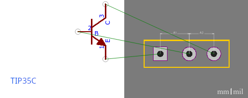

TIP35C schematic and footprint:
attachment.php

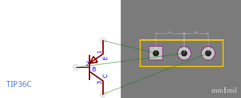

TIP36C schematic and footprint:
attachment.php

By the way, I found my mistake in the PCB, it was the pinouts of the transistors, I corrected them and now all tracks seem connected reasonably.

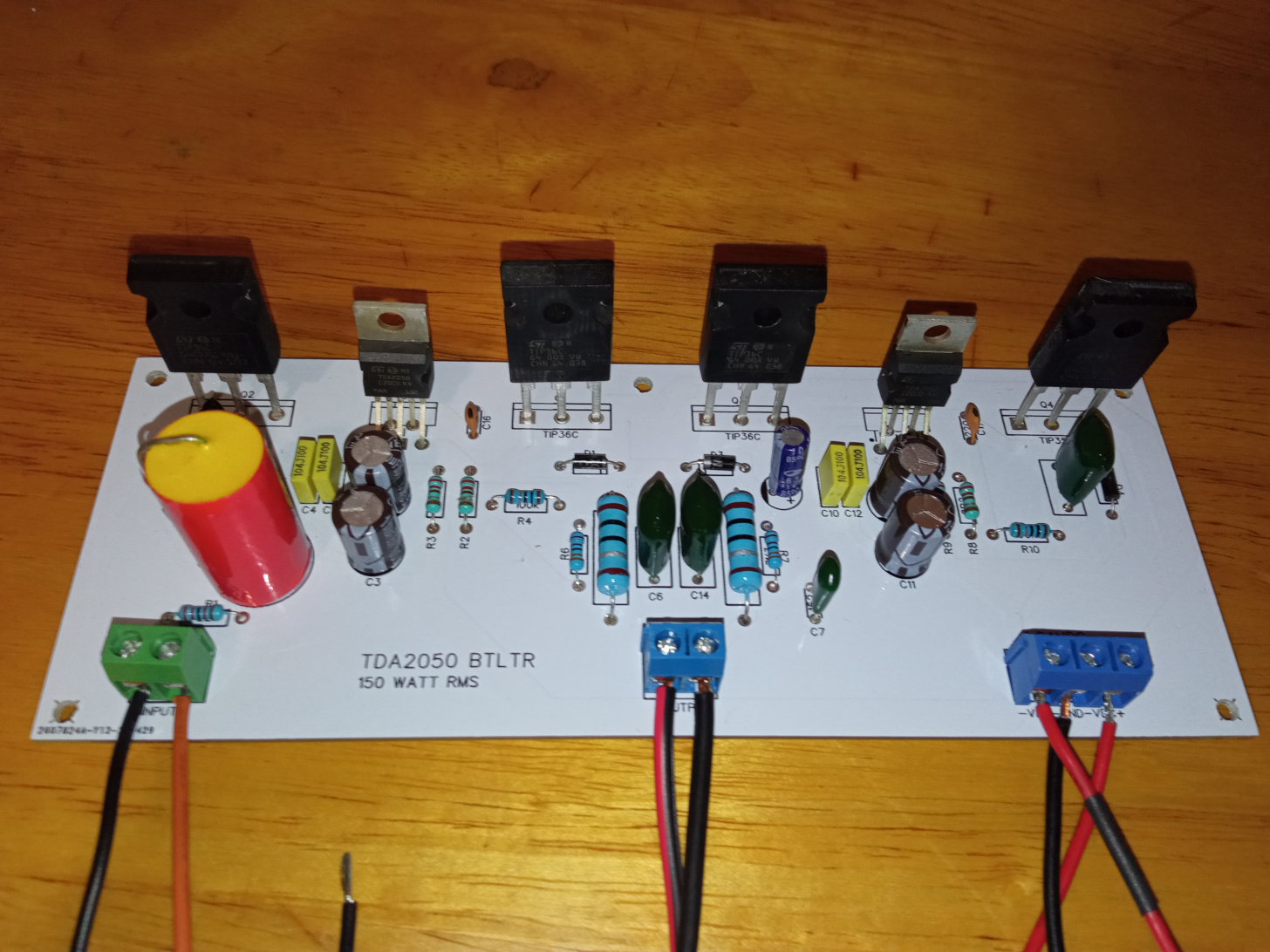

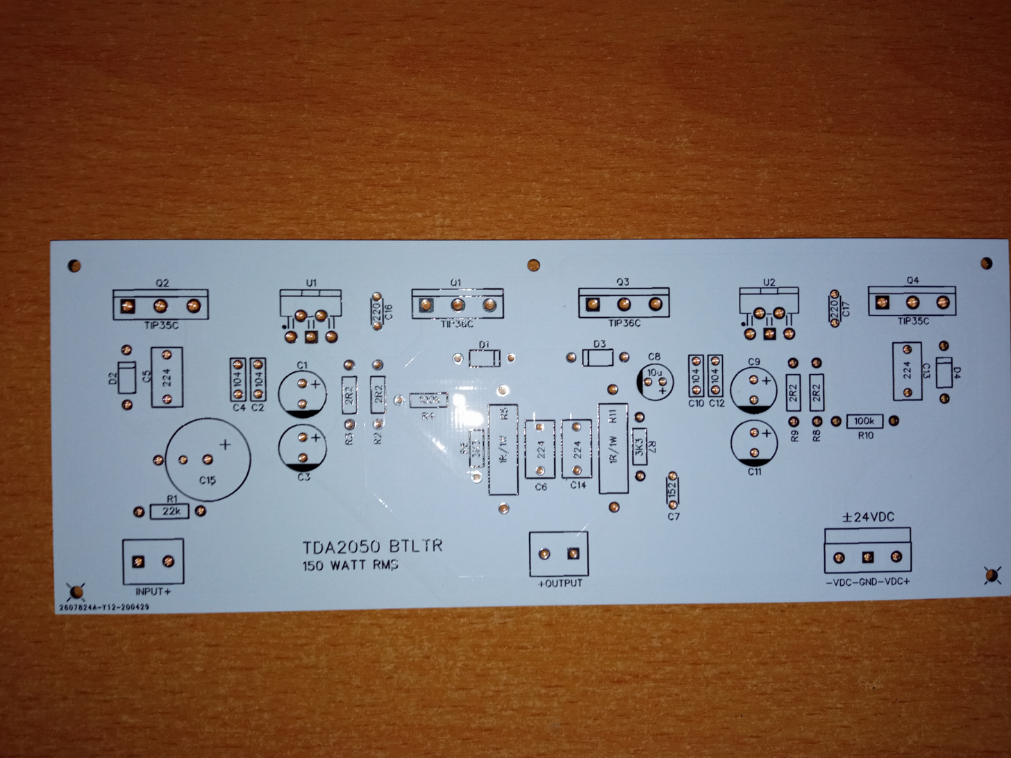

I made it and it actually works. The high-frequency response is not great, but the bass is there. This will be a subwoofer amp anyway.
