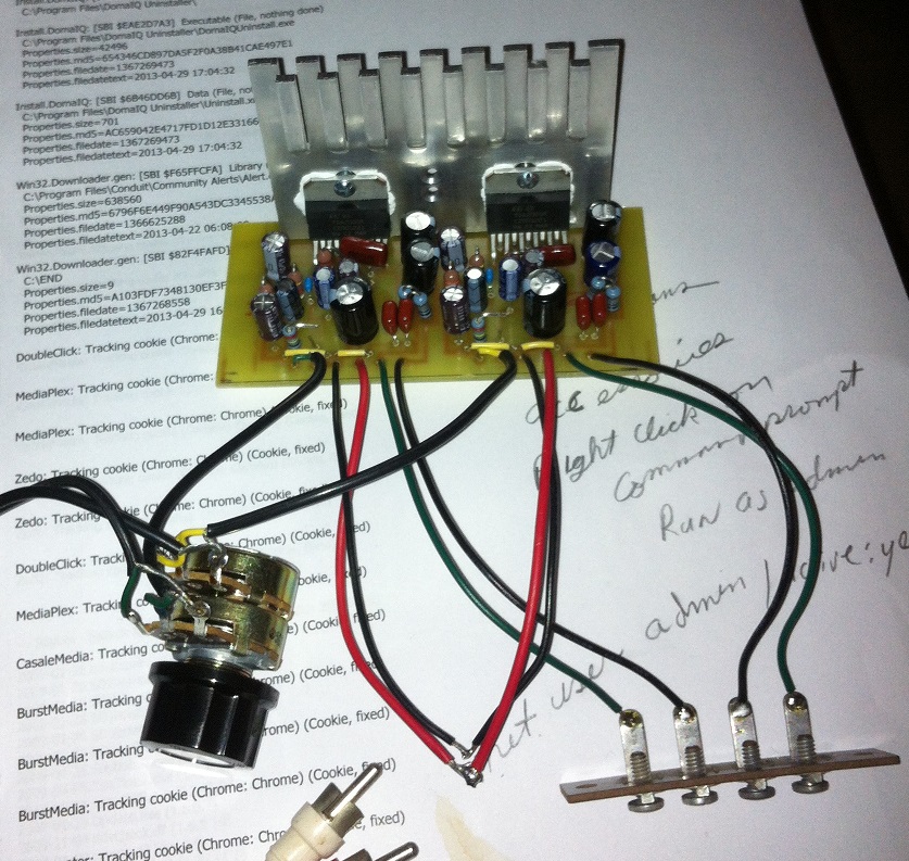

Hi to all. I need your help, because I've done lot of searching and haven't found any answer.

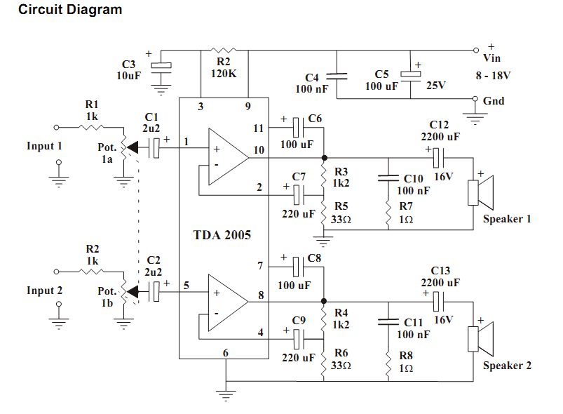

I'm planning to build a chip amp TDA2005R based on this schematic (see attached). But I have problems with designing PCB layout.
There are many PCBs on the net, but almost all of them are for mono or bridged mode. I need PCB for 2 channell mode (stereo). I have found a kit, that looks like this.
Maybe someone has a kit like this or can post here PCB layout for this TDA2005 in stereo mode.
Any help will be much appreciated.

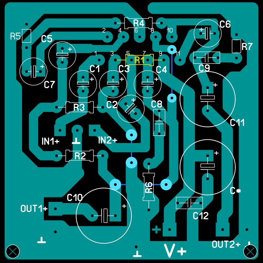

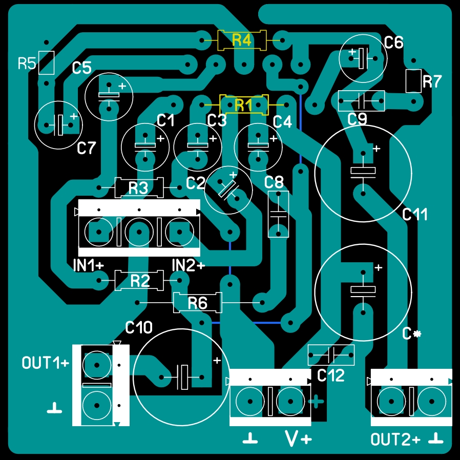

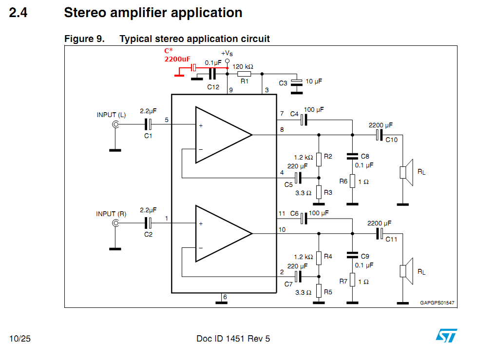

So, here what I've got. Schematic from datasheet, just added a 2200uF cap for power supply.
Are there any fatal "grammar" mistakes in this PCB? Can I use this layout?

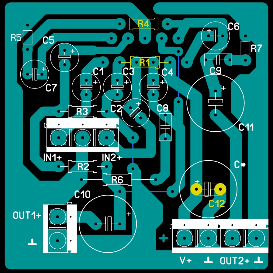

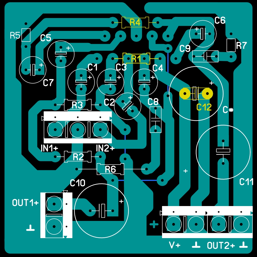

Please, look at this layout. I think it is much better, than the previous one. I tried to move the caps you mentioned as close to power pins, as possible.
Dear davidus, I'm quite certain that the layout is *electrically* fine (didn't really check it though) but there's a *practical* problem with it: you need the back side of the TDA2005 free for the heat sink .
1) you put R4 there.
2) even if you put it below, as suggested, the chip back is still too far away from the PCB edge, complicating *a lot* heatsink mounting.
If you put the heatsink on top of the PCB, how will you mount it?
And heatsinks are, by definition, heavy; if all that holds it there are the TDA2005 legs, they will soon crack.
My (and all commercial ones) design puts it right on the edge, so it can be bolted to a chassis mounted heatsink or an aluminum back panel.
