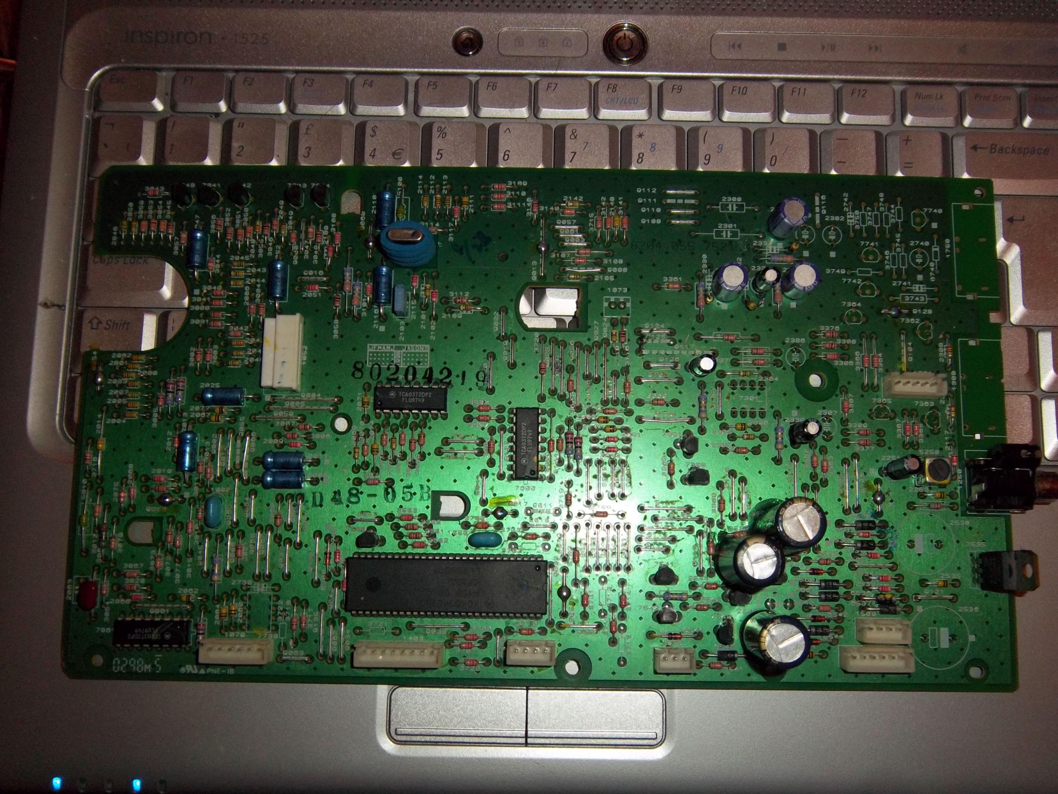

Think I've attached a pic of main board so far.
Few Oscons in place plus Pan FC. I've lifted the legs of the .1uf caps around the dac chip which are to be replaced with some tin foils. The original little caps used in this player look like tiny resistors - never seen anything like it before. Where did they come from ? Odd indeed.

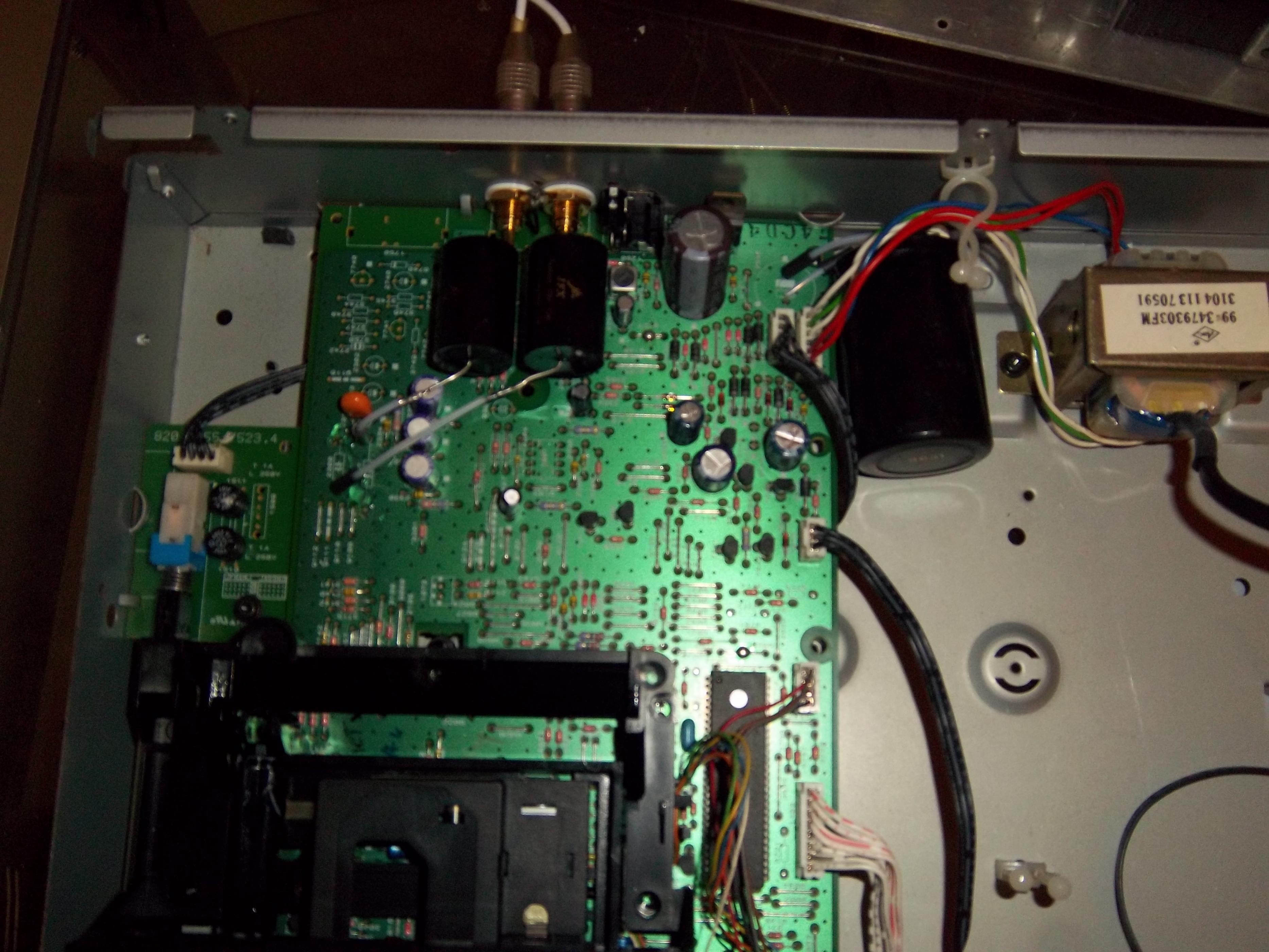

I've a pic of my other CD48 playing away to itself that has the dual op amp removed and the signal straight off the Dac chip to rca's to load next.
Still staggered by the performance of this - even with original horrible bits still in place - like nothing else done to it.

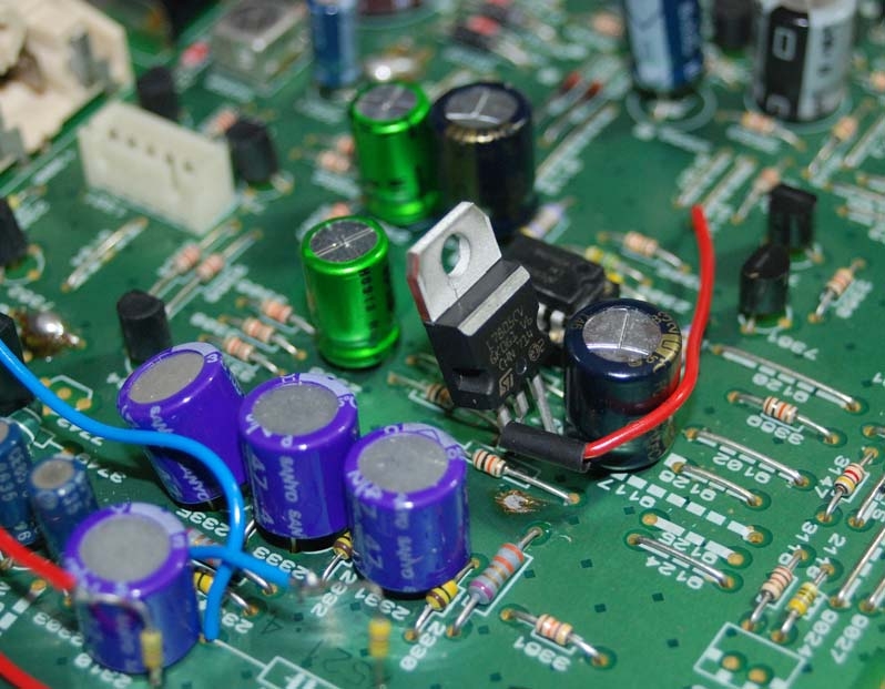

In my impatience whilst waiting for the postman I've cracked on and got some half decent pulls from other projects.
Big BHC power supply smoother, Oscons and some bypass caps underneath.
Sizeable step in bass resolution and a lot smoother in the hf.
The mid band is pretty chunky and particularly drums sound very real and fill the room.
I like it but there's some way to go - no real 1541A liquidity yet.

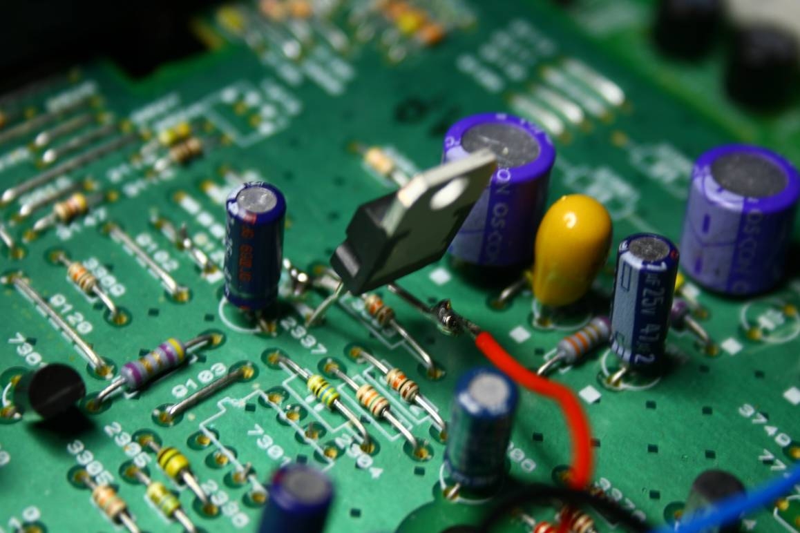

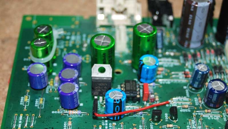

On the 5v power to the dac chip topic....I noticed in the pics that are available on the net that the 7805 reg's are taking dc from the main ps cap but appear to be ' not grounded '
In other words v in and v out are connected to the board but ground leg isn't.
I'm going to feed the dac with it's own tx, bridge, cap and regulator and I WILL be grounding it.
I've always grounded reg's even if they are stealing 12v or whatever from within the player.
Unless of course I just can't see a ground connection in the pic but in fact there is one.
Tried to upload an internet sourced pic so you can see what I mean - it won't let me...
Sorry - these photo examples show 5v taken from an adjacent link wire.
Not main ps cap as previously stated - but that's also an option I suppose if I wish to speed it up and complicate it less !
