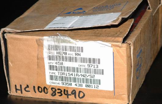

To those may interested in s2's:
i have sold quite a number of these chips, and havent received any feedbacks of suspicion. i know there may some fake 1541's around, and i do have seen fake s1's, but never s2's. as we have seen that s1's are selected after the logo and 'tda1541a' have been printed on the chips, then add on the 's1' and crown. it's quite easy to add these marks to the normal version, so there are quite some fake s1's.
but for s2, the logo and double crown are marked the same time, so the same color. to remark a normal version to s2 one has to wipe out the original prints first. that's not easy! when one wipe the chips there must be some difference between the wiped surface to the other side (the down side). i have some remarked chips at hand (not 1541's), i can check the difference easily.
all those got my chips can check carefully to see if the two sides look the same, same color, same gloss.

elib said:Hi there,
one more pic. that's all from me about the genuineness of my S2's.
Thanks to those trusting me.

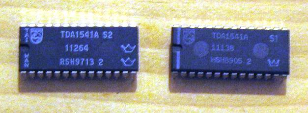

Hi everybody,
I just borrowed a TDA1541A S2 (see the DAC shown at the left of attached photo) from my friend. Please advise this is a geniune one or not.
Thanks in advance.
(p.s. The DAC shown at the right is the S1 version taken out from a Studer A730)
T.C. MA
HONG KONG

Crown
If you look carefully you will see that the crowns at the left are different from the crown at the right. You used blue light to take the pictures? Normally the lettering is white.
